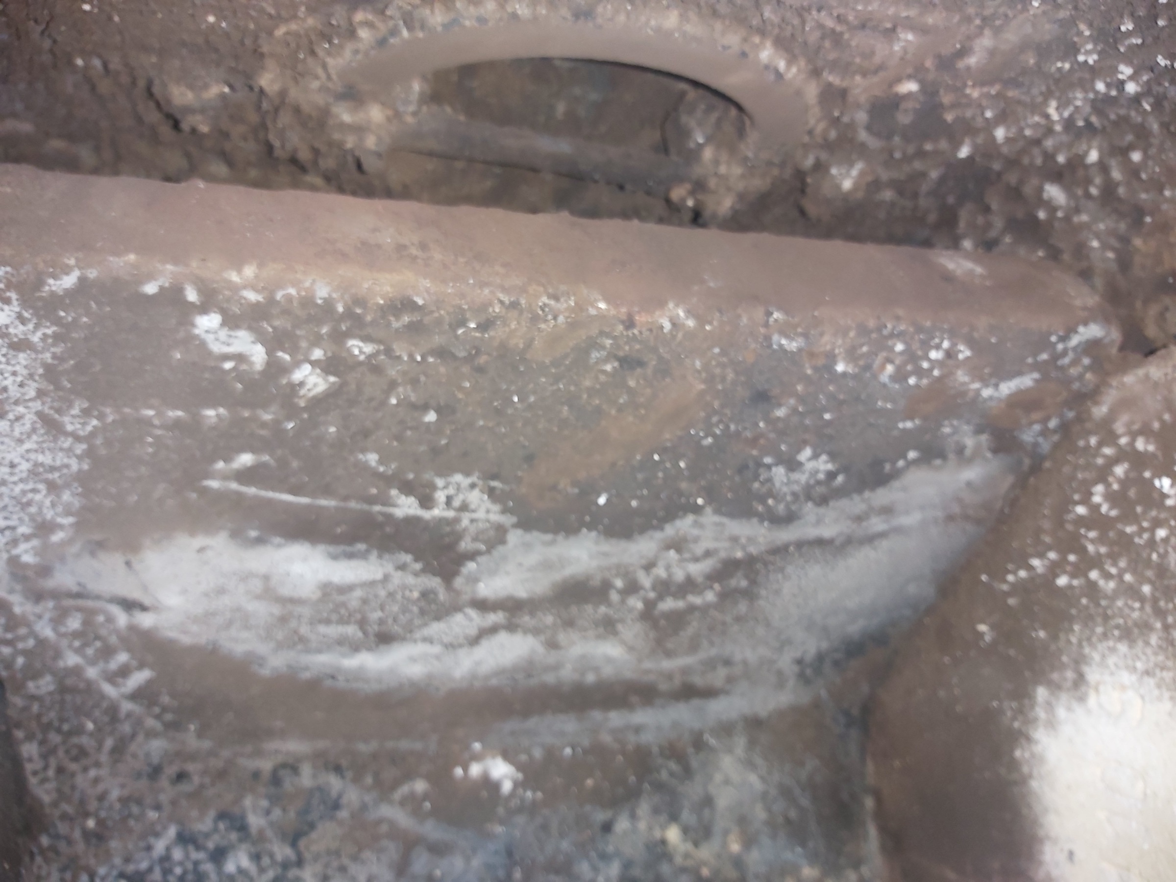

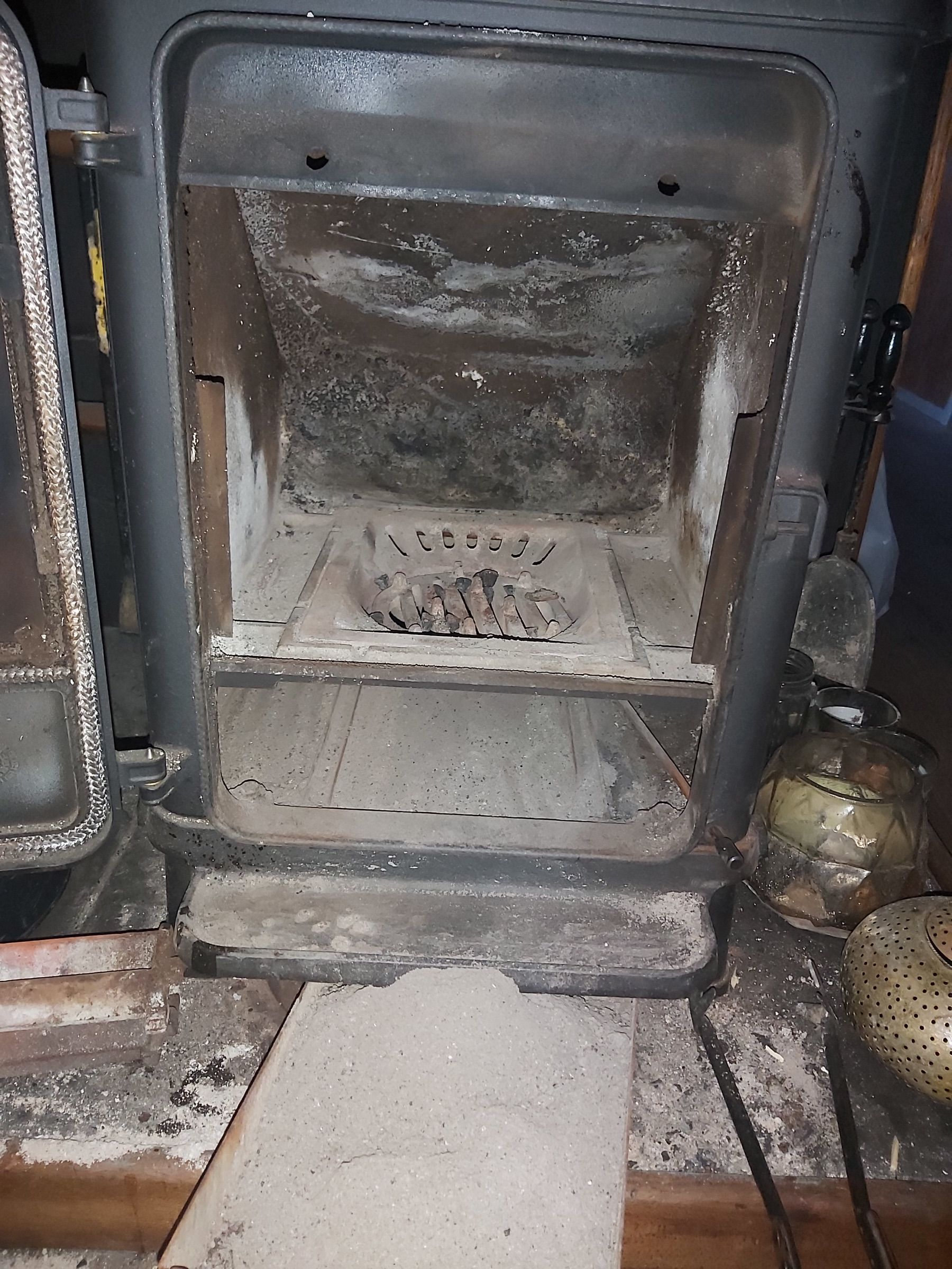

Thank you for clearing that up (no pun intended). Seems a bit strange - it will just fill with ash and become less and less effective with age then? Other boaters I know give their stove a full clean each year. If mine doesn't have a way to do this then perhaps eve cleaning the flue will just serve to clog the stove up further!? Thanks! Will take my rubber hammer up there!
Hi, I have a lovely morso swift to heat up my 52ft narrowboat. It has a gravity fed back boiler system, no radiators, it just has a pipe that runs along the boat passing the bed and heating water in the calorifier. The system is older but the stove was brand new, replacing a morso squirrel 2 years ago. Problem is, It struggles to heat the boat from cold and to keep the boat warm. I guess because the cold water in the calorifier is making it work hard. I'm running my engine to heat the water and help it out. (Once the boat is warm it seems to do well). Is there anything else I can do? Other boat friends have said I need to clean behind the baffle plate but I don't think it has a baffle plate..! Could be mistaken!? Does anyone know how to remove them if there is one or how to clean soot build up if there isn't one? I could only get out soot as far as my hand could reach. (Photo and video of the insides attached) Also, my chimney above the roof is quite short. I'm looking at getting a taller replacement chimney but this one seems so well stuck on and I'm scared of yanking too much and doing damage to the chimney/stove installation. Any tricks besides resorting to an angle grinder? Appreciate any advice! Many thanks, Rachel

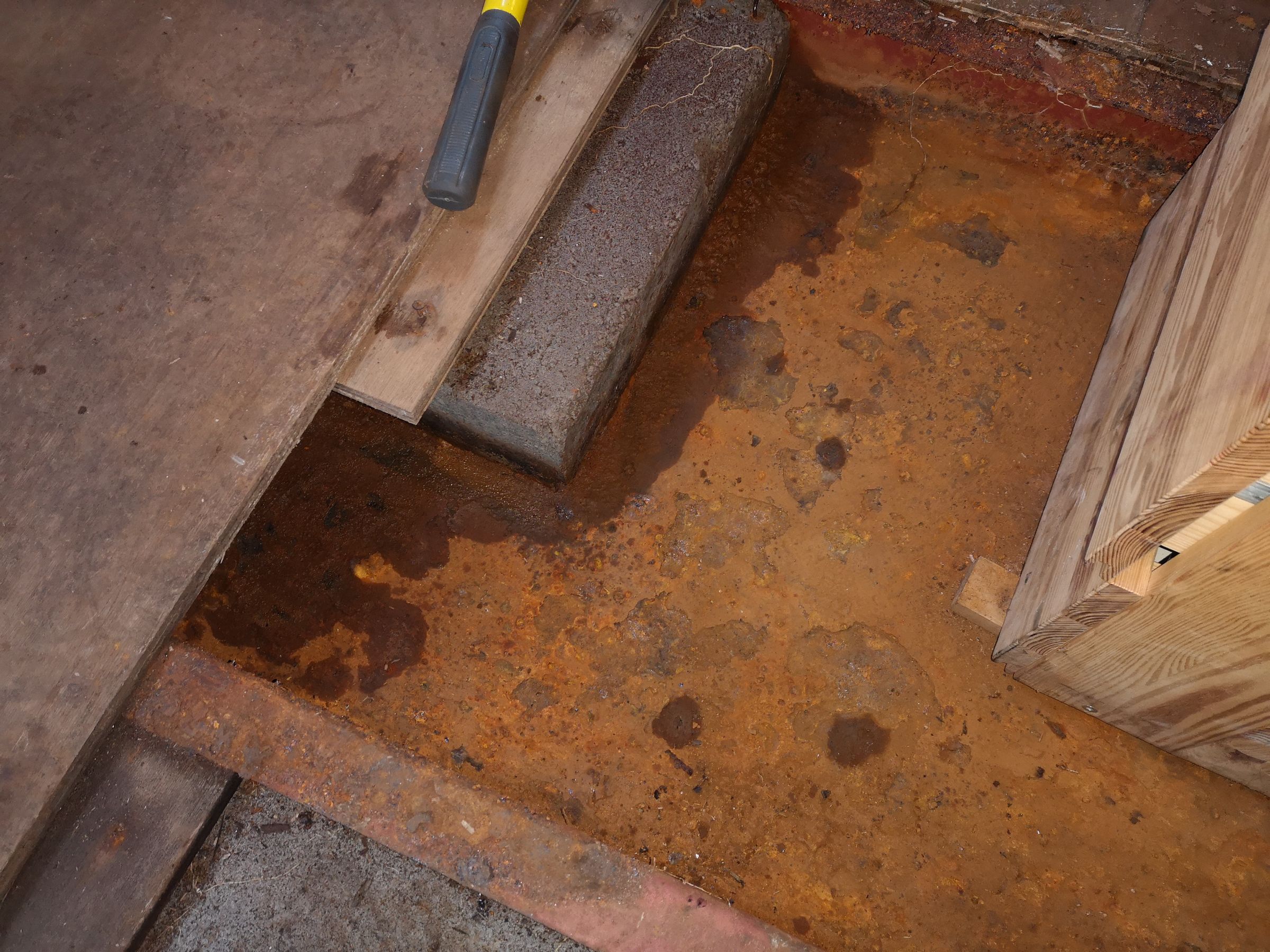

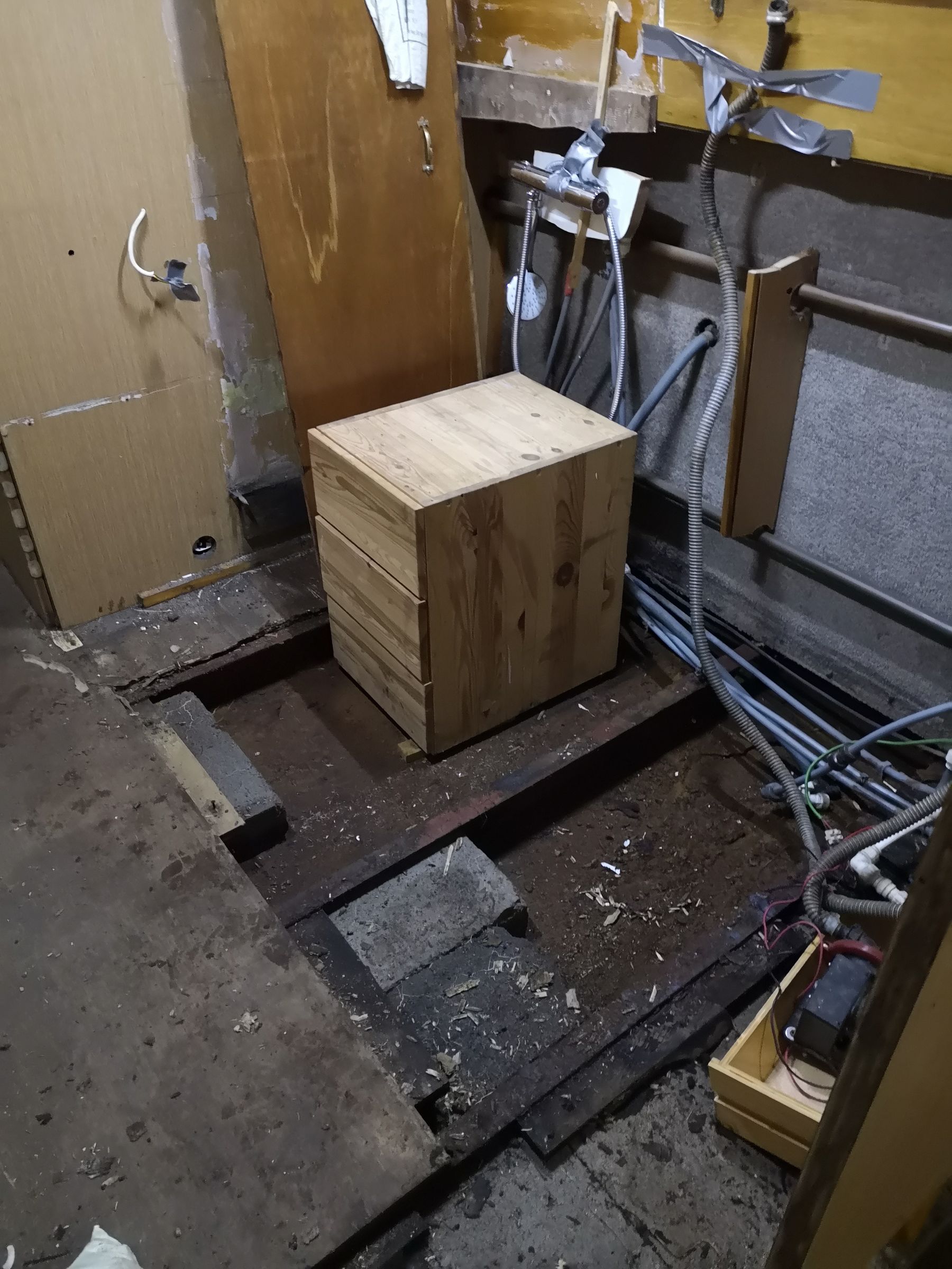

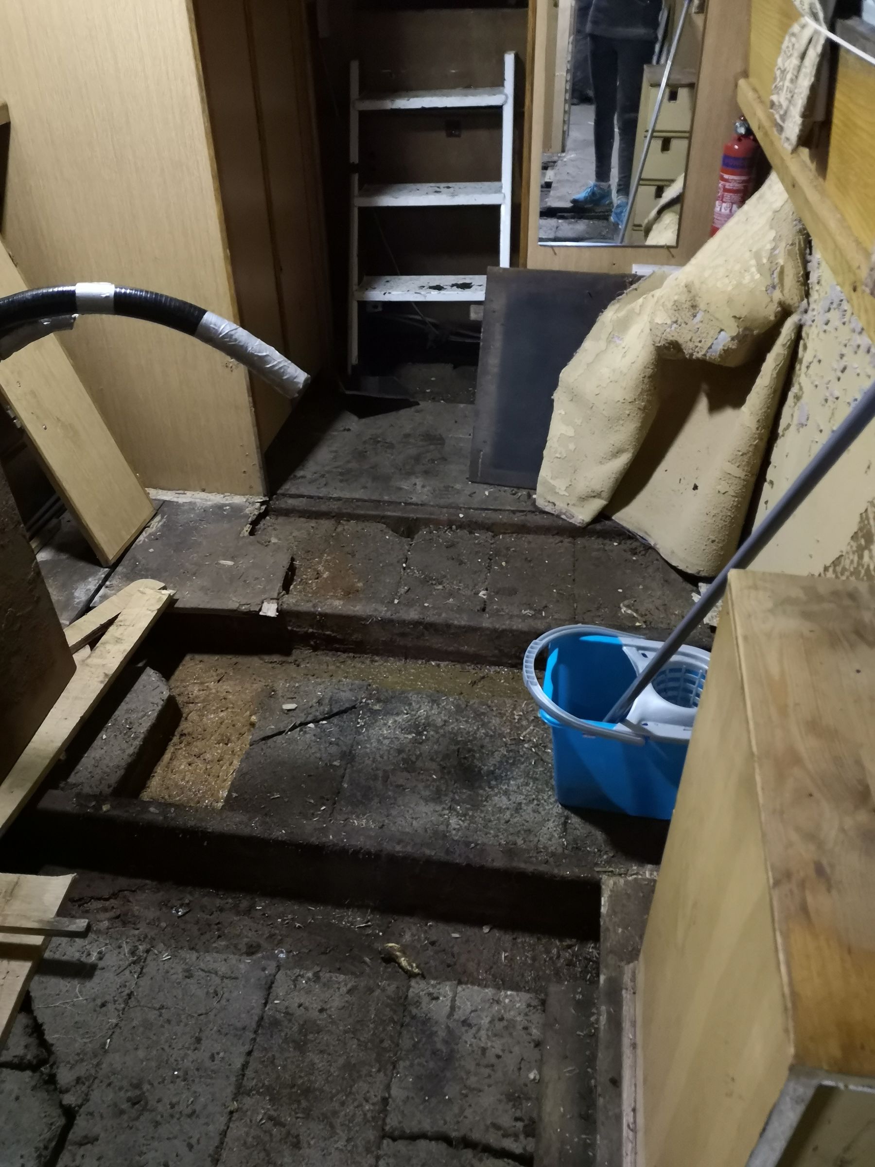

Thanks so much for all of your excellent tips. Really helps my motivation too! I hadn't thought about lifting the ballast but after today's visit to the boat, glad the rust is drying but it's clear just how damp the blocks are so I will do as you suggest and put something rubbery underneath ? I'll also try moving them around. next thing on the shoppinglist: crowbar. The project just keeps growing. ?
I will check under other parts of the floor and make some holes for ventilation (is that a good idea or fuels rust!?) but this is the part where floors were damp, from bathroom and back to heating system. The rest is dry and hopefully doesn't need this attention. Boat built in 1994 by a good builder but there was a lot of condensation and past leaks without much maintenance.

Hi, looking for advice please! First boat. I've managed to lift the soggy half of the floor and the unbelievably heavy waste tank. Before putting down marine ply (as the ballast are damp so I want to put good stuff over) I should probably treat the rusty floor. The hull had a good survey last year albeit just tested from the exterior. How do I stop rust in its tracks? Best and simplest way please! Which is the brand that you spray/paint over and it hardens the rust without you needing to remove it first? If you could give me a stepped process and links to a UK store would be unbelievably helpful. Trying to do this outside the hours of my day job! And would like to move in next month ? Thanks! PS. I heard fertan was good but downside you have to wash away with water. Pps. Prefer non-toxic option if possible

Thanks! Good to get the advice of experienced boaters! If the consensus is that cassettes aren't too inconvenient, I'm leaning towards that also. Could do with the floor space in what's going to be my walk in wardrobe/garage too -

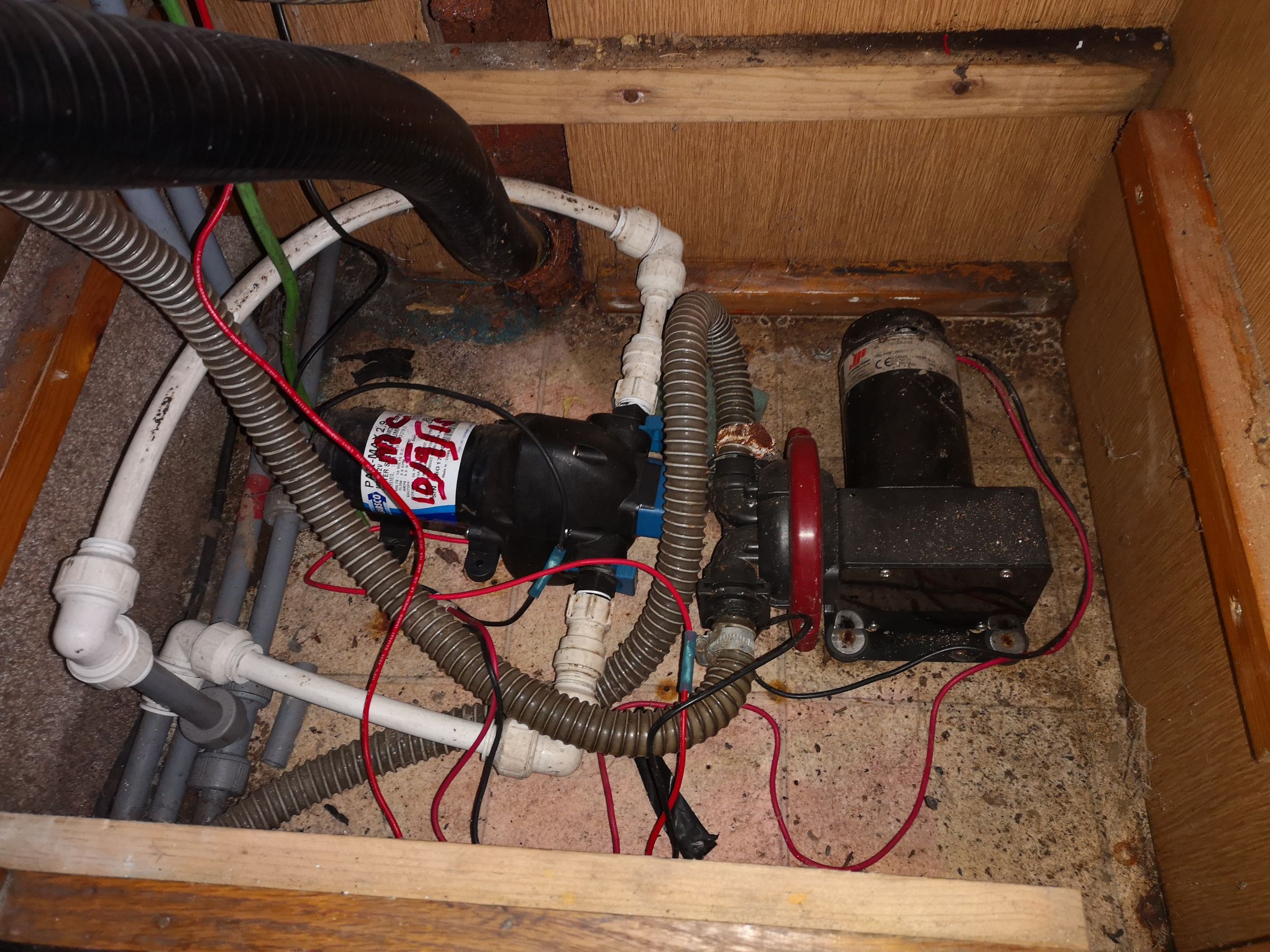

Yes it's an L shaped one. The toilet sits on top of the tank. Not a macerator, just goes straight down ? The other picture is inside the cabinet below the basin, showing the pump out pipe connection. -

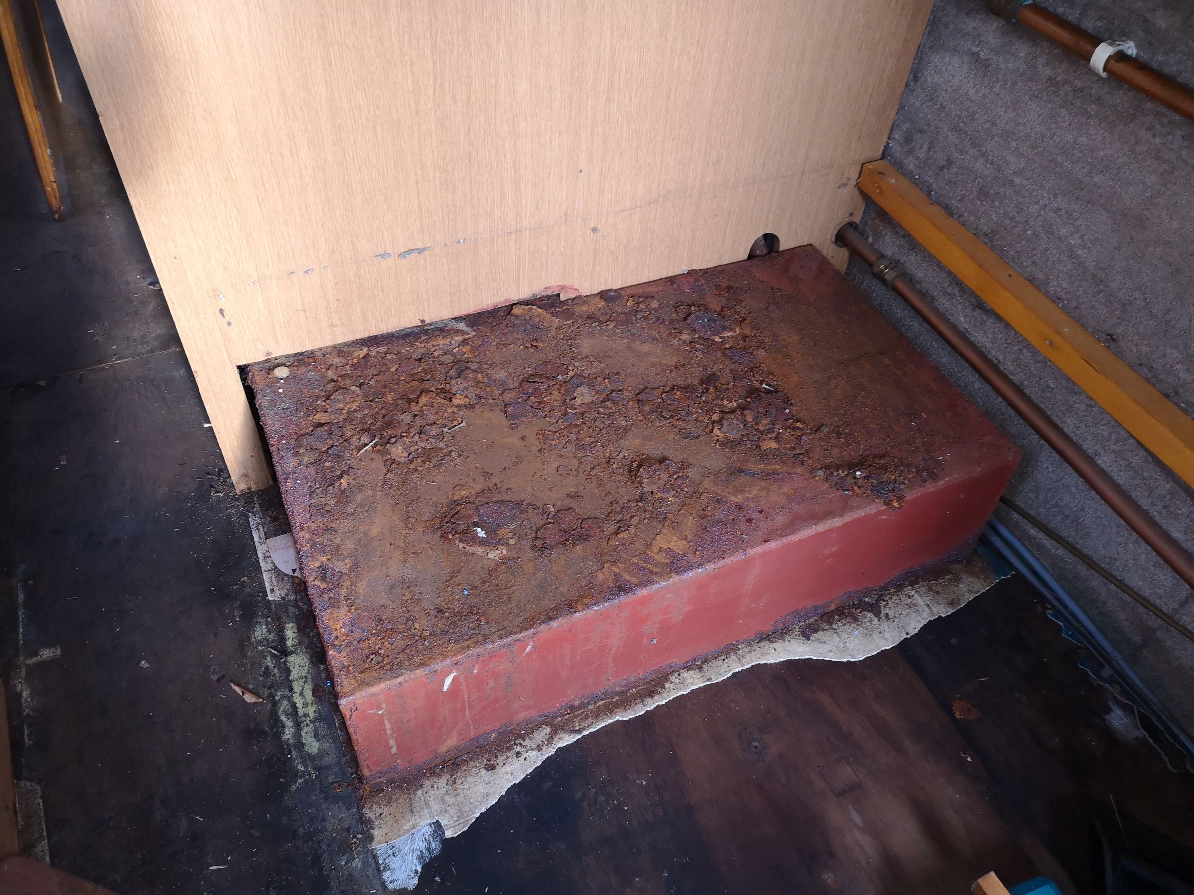

Thank you all for your replies. That's correct, it's a black water tank. It's sitting atop sheet lino, atop wood. Strange but glad it makes life easier to remove if that's what I decide. The boat was previously used by a long term rental company so its had quick fixes to keep it "liveable" but not the tlc coming from an owner occupier. The engine and the hull came out well in survey so I felt reassured that I could handle the soft components. I don't think the tank is leaking as no smell of waste. There was previously water in the back of the boat from a central heating leak. I think this has seeped all the way up. There was a lot of water in the bilge but since mopping up it is draining almost dry. Possibly that leak and years of condensation was capable of causing this mess. -
Just bought a 1994 narrowboat, I'm a complete novice using my holiday to renovate and will hopefully move in end of Jan - really appreciate your advice! 1. Lifting the vinyl flooring revealed damp and mold through the ply floors. Bed came up to reveal rusty water tank (see pic) . I wasn't intending to strip the boat down to ballast but clearly this floor is coming up and will be replaced before laying anything else down. I need to decide if I keep the poo tank or go with another toilet system (can't get my stomach around the idea of keeping a month's worth of poo under my head!) Lifting the water tank though looks a difficult job and means replacing the bath/bedroom wall (which is dry). IF I decide to keep the tank and just treat the rust then for an easier life I could just cut the flooring around the tank leaving the piece that's under there. Maybe I could treat it to prevent the damp spreading to new adjacent wood? 2. Middle to front of boat looks dry. Would you recommend lifting some of the mdf to double check? And should I put some hatches in throughout the boat for future ease before laying reclaimed floorboards? (could maybe hide under a rug/sofa. I'm on my own here except for nice friendly boaters nearby who I've asked a million questions but don't want to overdo their kindness! Thanks!
