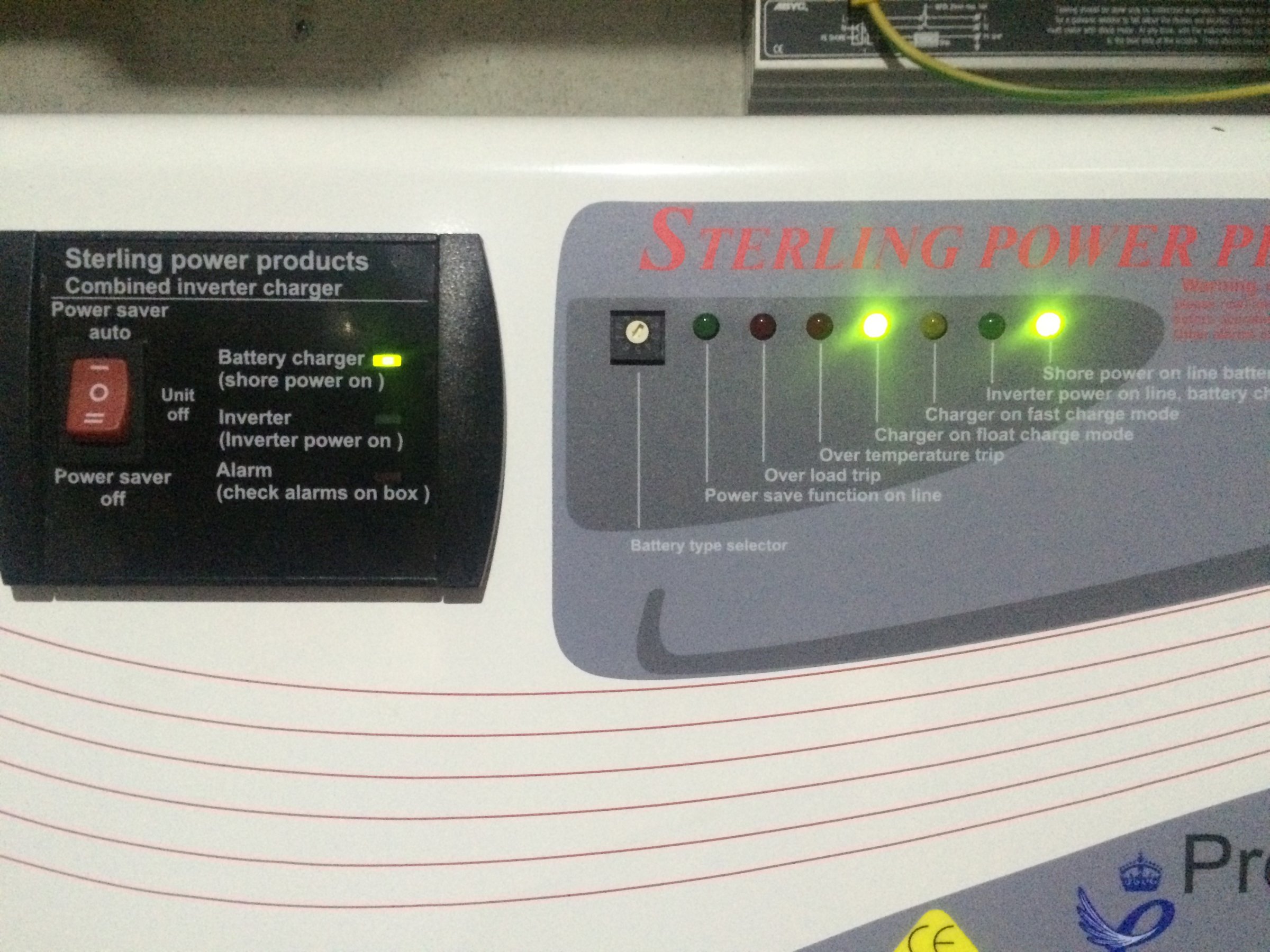

Hi guys, i saw saw a couple of threads on this subject but thought I'd add this as it didn't really answer my problem. our Stirling pro combi Q cooling fan is going continuously....and its always on 'charger on fast mode' program. the batteries as far as I can tell are fine. I have 4 X 6v batteries and I check them to see if fully charged and it seems so.... They are reading at close to 6v when I checked them. we are on shore power 99% of the time. And the only bit of heavy loading electricity we use is a domestic fridge (not 12v) as the previous owner left it behind so we thought we would use it. we have been on the boat for over a year and the fan has come on a periodically but now it seems to be on all the time! Making a right racket!! Any clues?

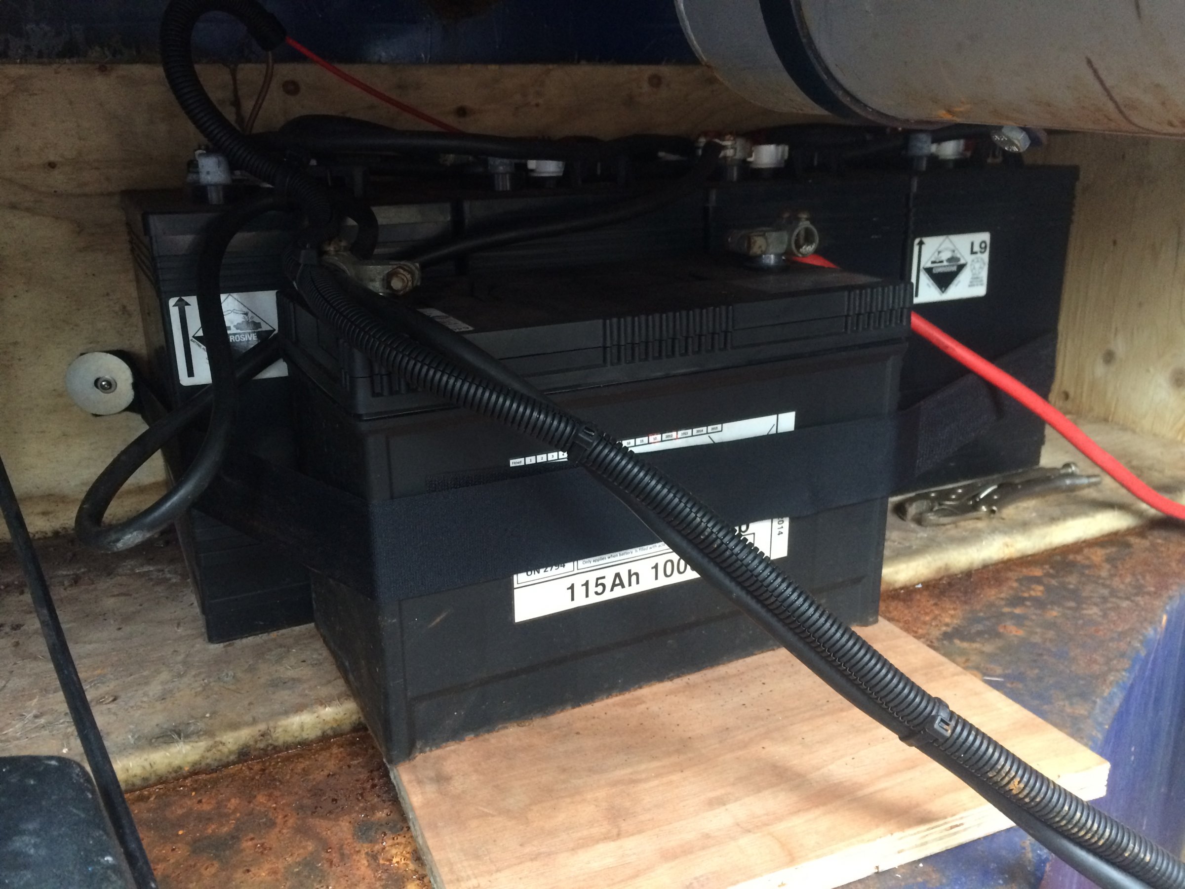

SO....... i I have turned the shore power off & engine is not running. we are now running off 12.4v..... We have a fridge which is on & a laptop charging. i have checked the batteries and they are at 12.7....... & the leads running to the alternator are running at 12.7. I have have added a picture of the batteries. We have 5 of them. I could only read the front one as I couldn't reach the back..... with th the engine on the it goes up to 13.8. & also with the engine on I tested the wires connected to the alternator & that was at 14.8..... hope we this all helps...... I will leave shore power off and let you know how long we last!

Thanks for your reply. it just seems to be always on float charge mode and the fan never stops! when on shore power (which is 99% of the time) we leave it on power saver auto. if we turn the inverter off then all electrics (fridge, plug sockets) except for the main lights turn off. if we have it as power saver mode then it just does the same as auto, and just stays on float charge mode....

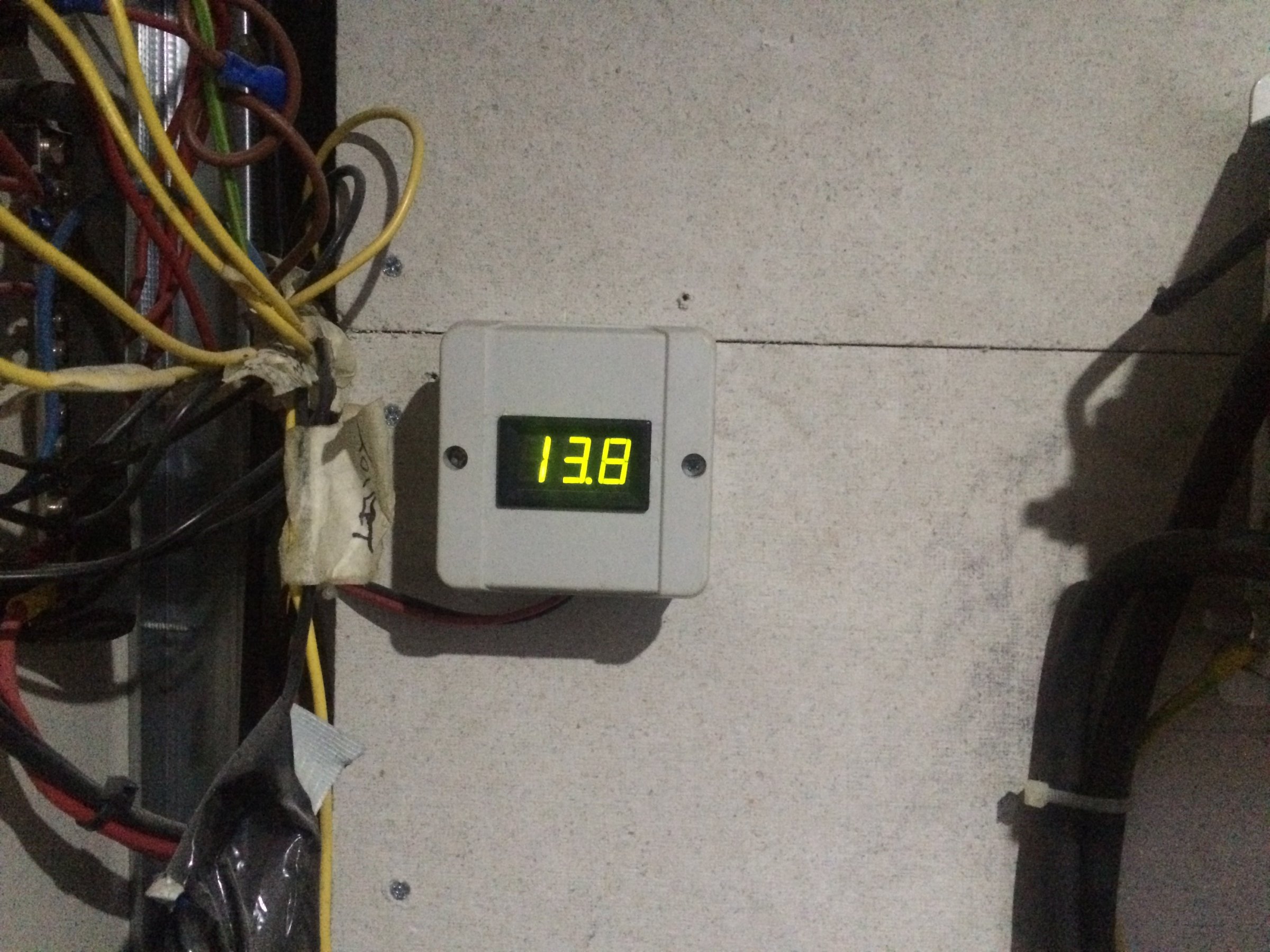

Shore power off : 13.2 Shore power off & engine on : 13.9 Will attach picture of step up. also..... Just found a lead which had dropped down the back of our electric board with this note on: "This wire must be removed when the domestic battery positive lead has been connected to the terminal post. WARNING: do not run engine without this wire in place or without the domestic battery positive lead connected otherwise alternator damage will occur" we we have never seen this lead before until now........ Got a feeling that's why we have had problems since our outing to bath? cheers

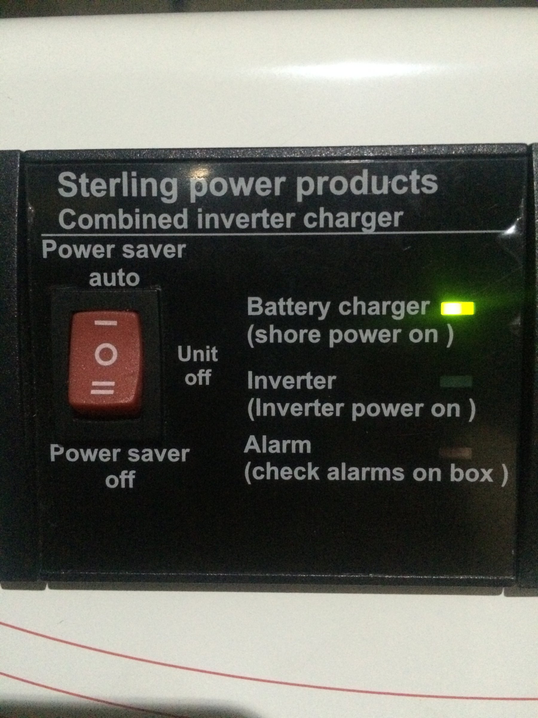

Hey! yes it's reading at 13.3 and the lights on the inverter say it's: -charger on on float charge mode - shore power online, battery charger active. cgeers
Hi fellow boaters. been on my boat for over a year now. we took her out for a trip to bath the other day and moored up for one evening then came back to Bristol. On the way to bath our battery seemed fine & fully charged. but once we arrive about 3 hours later the battery was dead. Then on the way back to Bristol the battery just didn't seem to be charging at all. since we have been back and have connected back to shore power our inverter charger seems to be constantly on battery charge mode...... Which it never used to do all the time. I dont really understand why when we are on shore power that the batteries are constantly trying to charge? Does anyone one think they have any clues to this problem? Knackered batteries? cheers, chris
