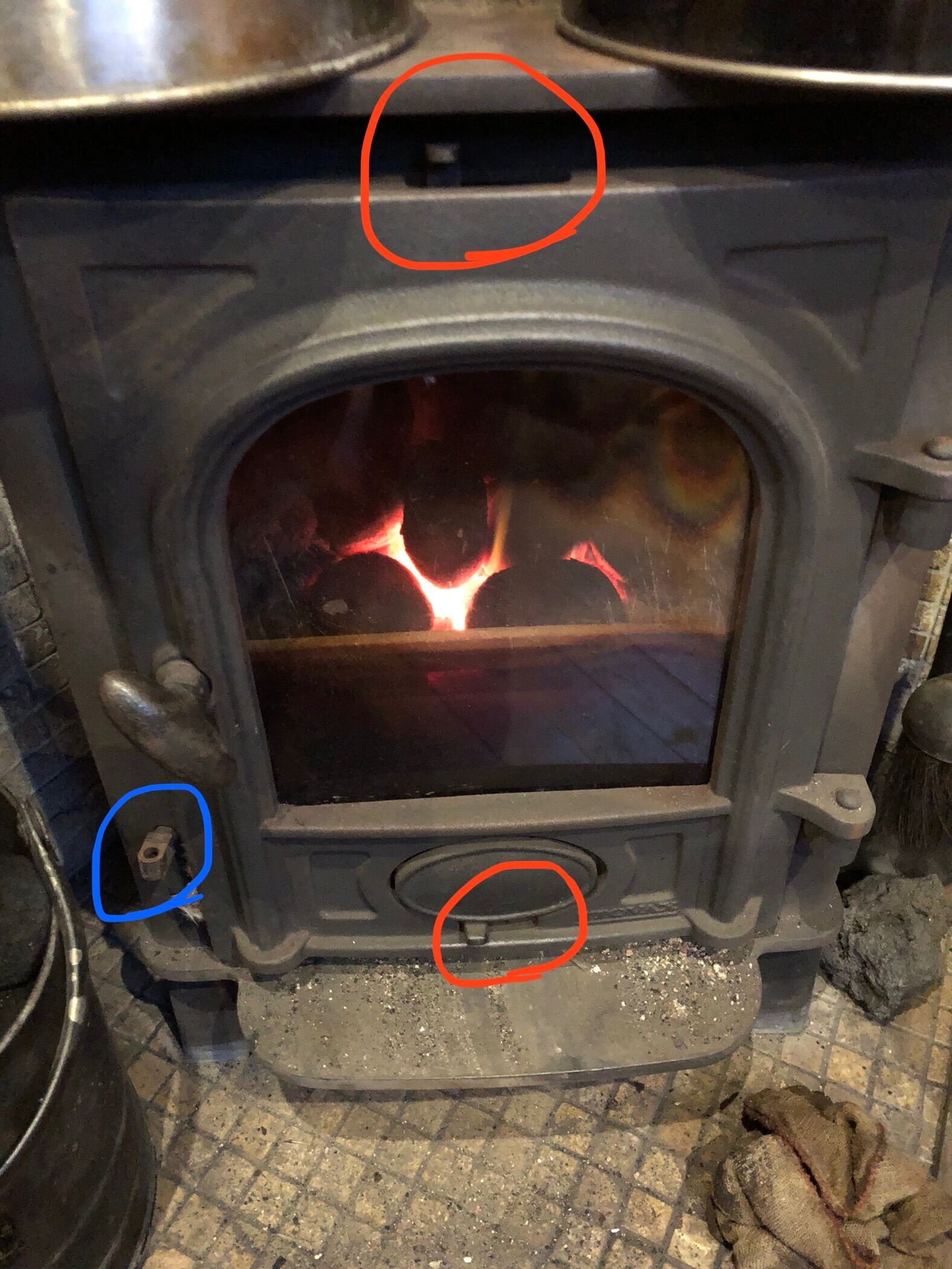

Hello, I’ve been burning excel with a stovax 3, make sure both air flow controls is to the LEFT as that’s open (circled red).
I also leave the door ajar for a good 30+ minutes when starting to get it going. When there’s flames coming off the briquettes then it’s well established then I leave the top vent fully open to the left and control the burn rate with the bottom vent.
After keeping it in overnight to get it going again I put the door ajar with vents fully open and griddle the ash away and wait until whatever is left is glowing red then I add more in, leaving vents and door ajar for at least 30 minutes to get it going. I find if I just add a load of briquettes when they’re glowing and it doesn’t get the air then it just goes out.
you’ll get into your own system and routine with what’s best for you.
also does yours have a griddle knob (circled blue)? If it doesn’t then it’s not the multi fuel version.
