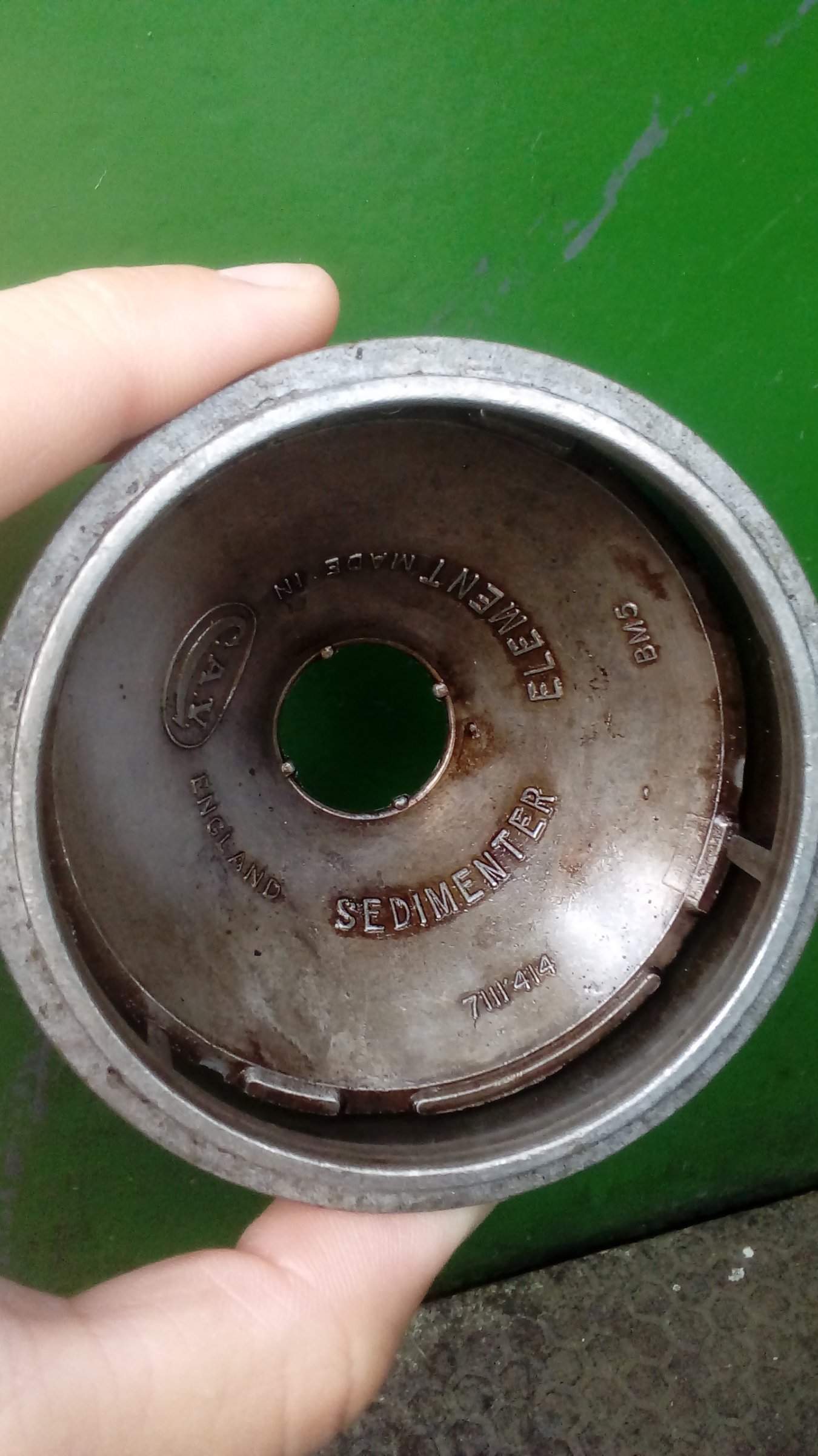

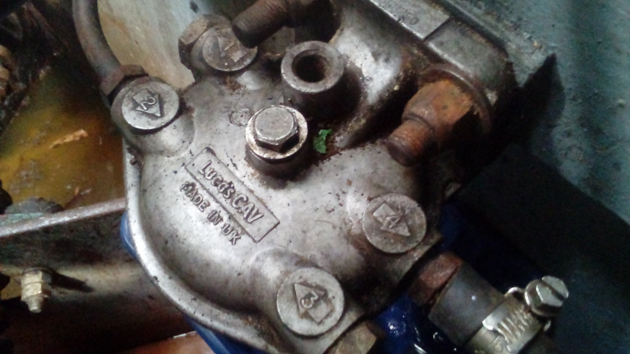

What fuel filter do I need?
blythecooper replied to blythecooper's topic in Boat Building & Maintenance

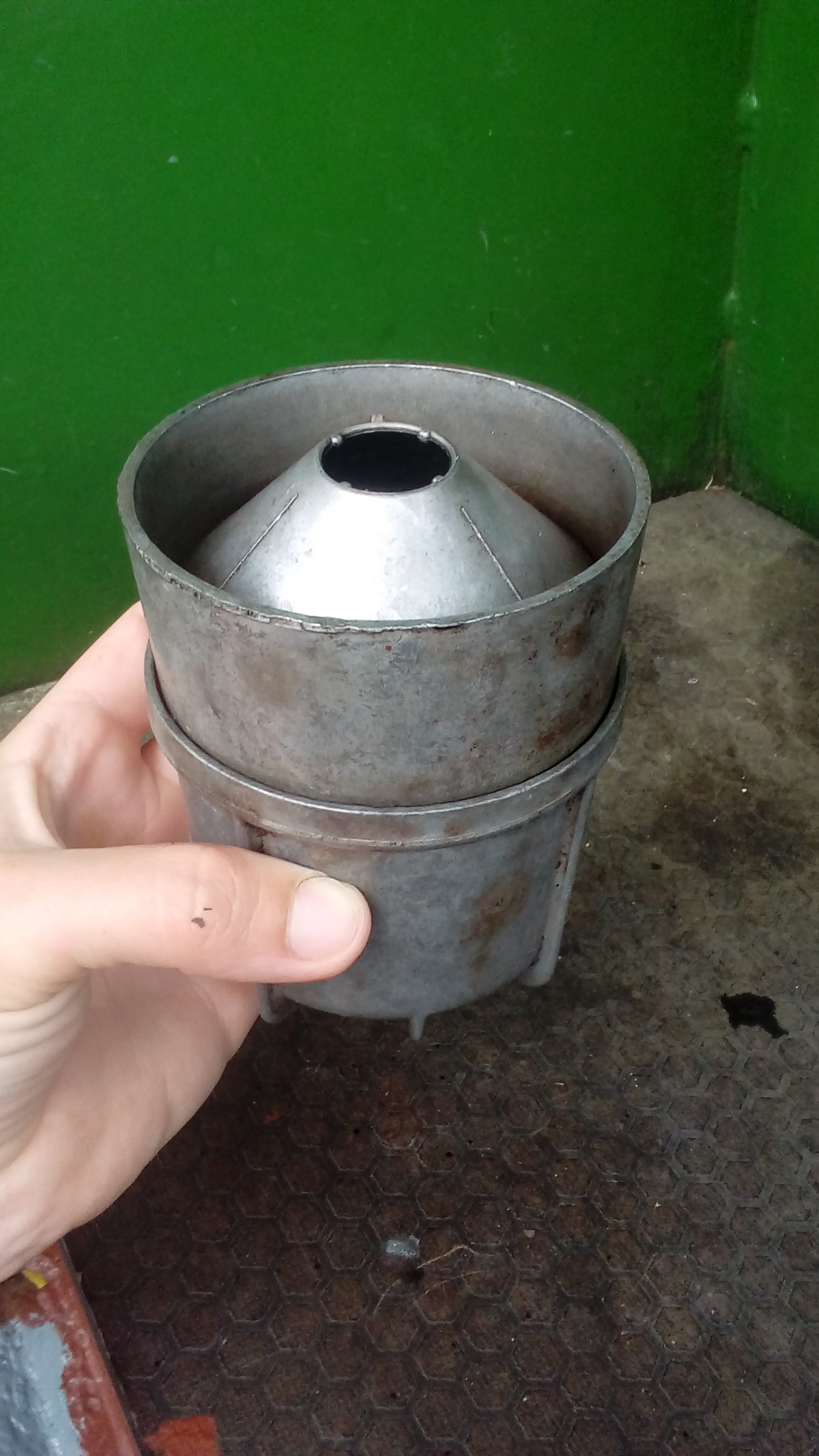

This started leaking and letting air into the system.. I just assumed it was a fuel filter (complete newbie). Happy to leave as is once I've stopped the leak! -
Ohh. Why was it full of diesel? Is that usual? And where is a primary fuel filter usually installed?? -
Can anyone tell me what fuel filter I need for this please? Can't find any info online and there wasn't one in it when I took it apart! It has 'Type SS' and 'Des no 5836B250' etched onto it.

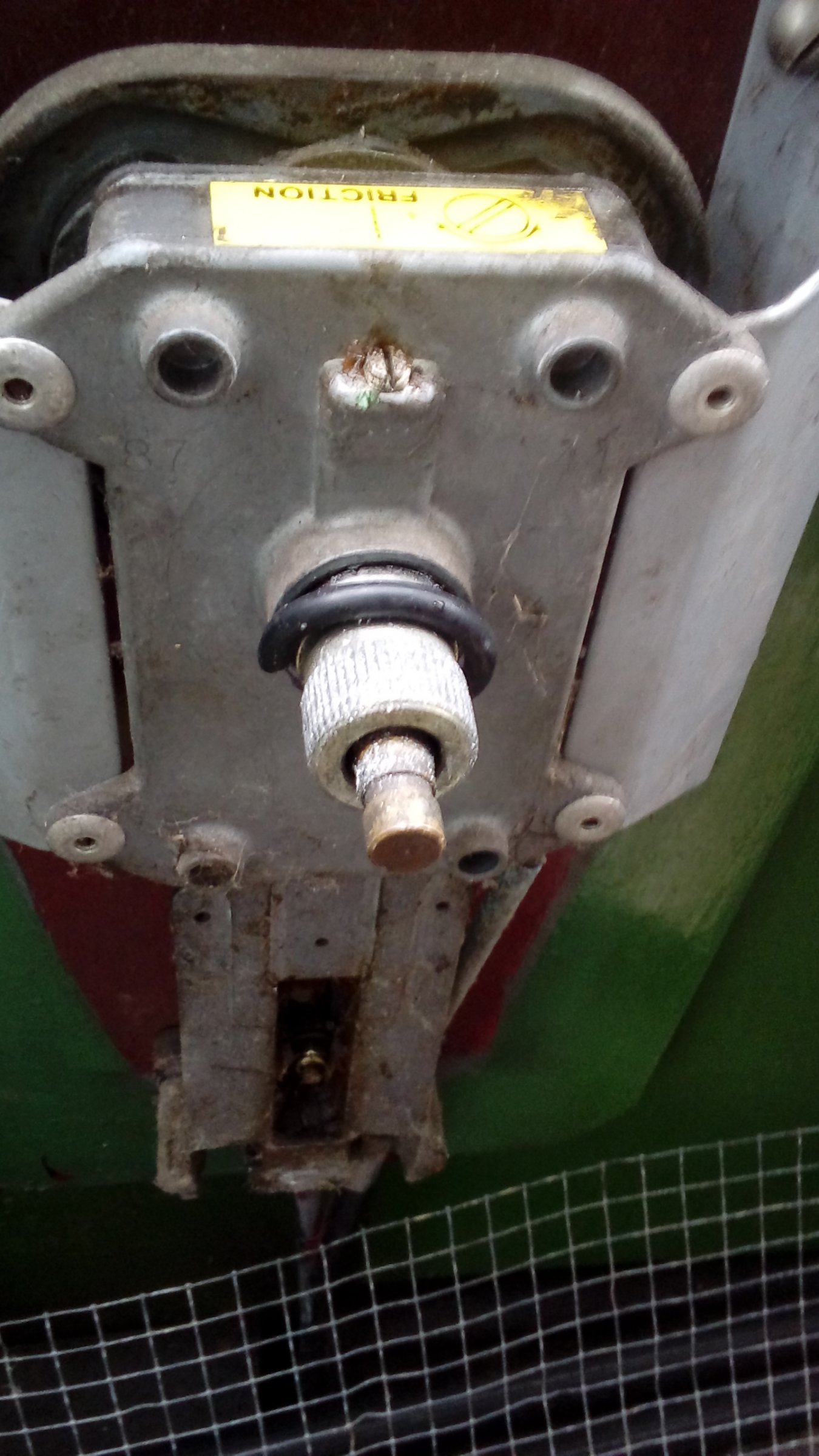

TX Controls 700 SO replacement parts
Thanks for the suggestions! No, the screw isn't missing but it is fully tightened. Will have a mess around with it as soon as I get out of the sticks (currently in Cropredy and heading north)! -

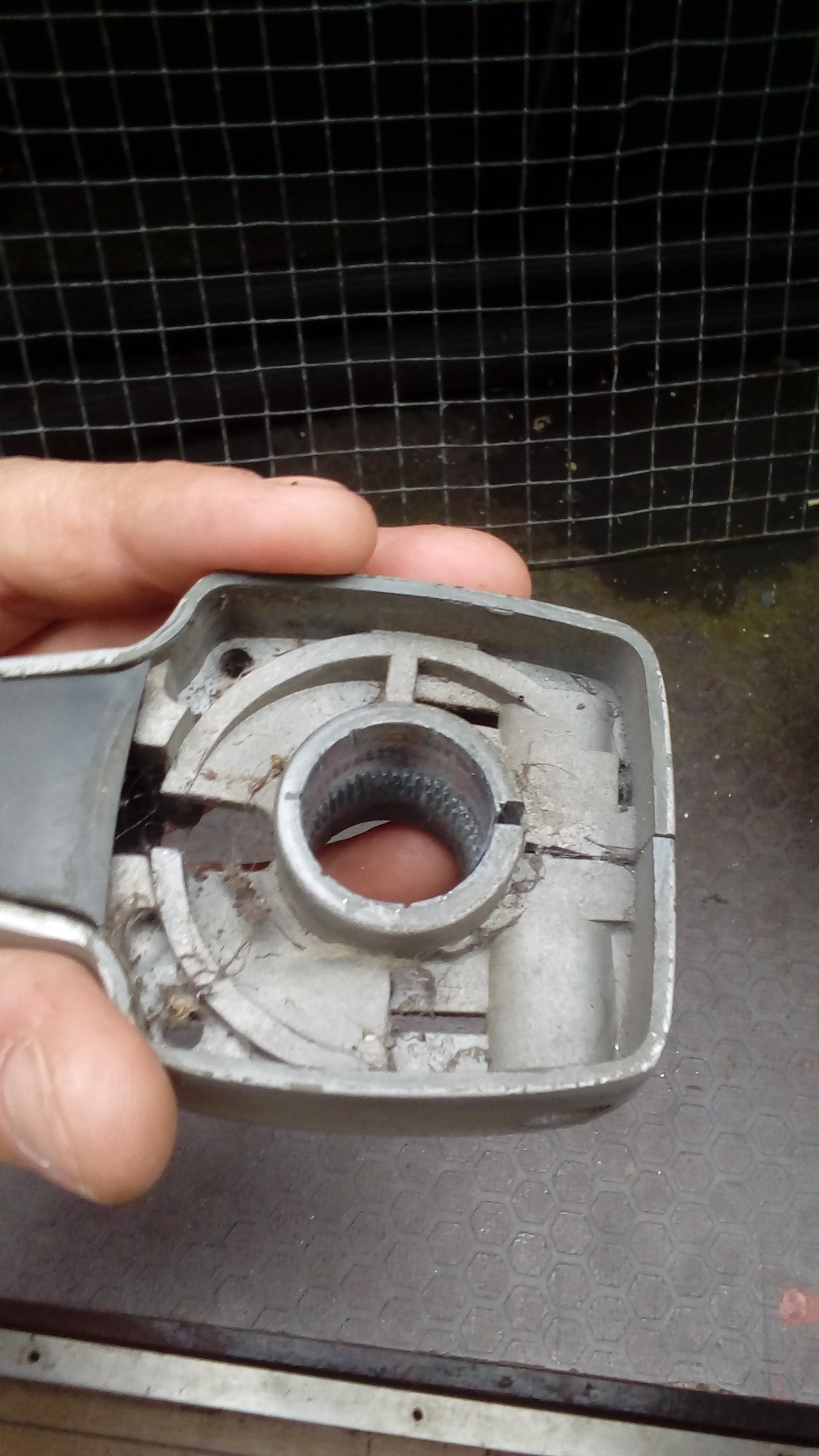

I have a TX controls 700 so gear control box and the splines on the handle and the little knob (please insert official terminology here!) have worn. The handle slips. I can hold it at a certain angle and get away with it but it's certainly not ideal, and I'm pretty sure I'm not doing good things to it. Can anyone point me in the right direction for replacement parts? The handle is easy to find but I don't know the name for said little knob. Also does anyone have any suggestions for a temporary bodge? I tried mole grips, which work in forward but slip in reverse.. It could be because my grips are cheapy Screwfix ones. Any help greatly appreciated!
