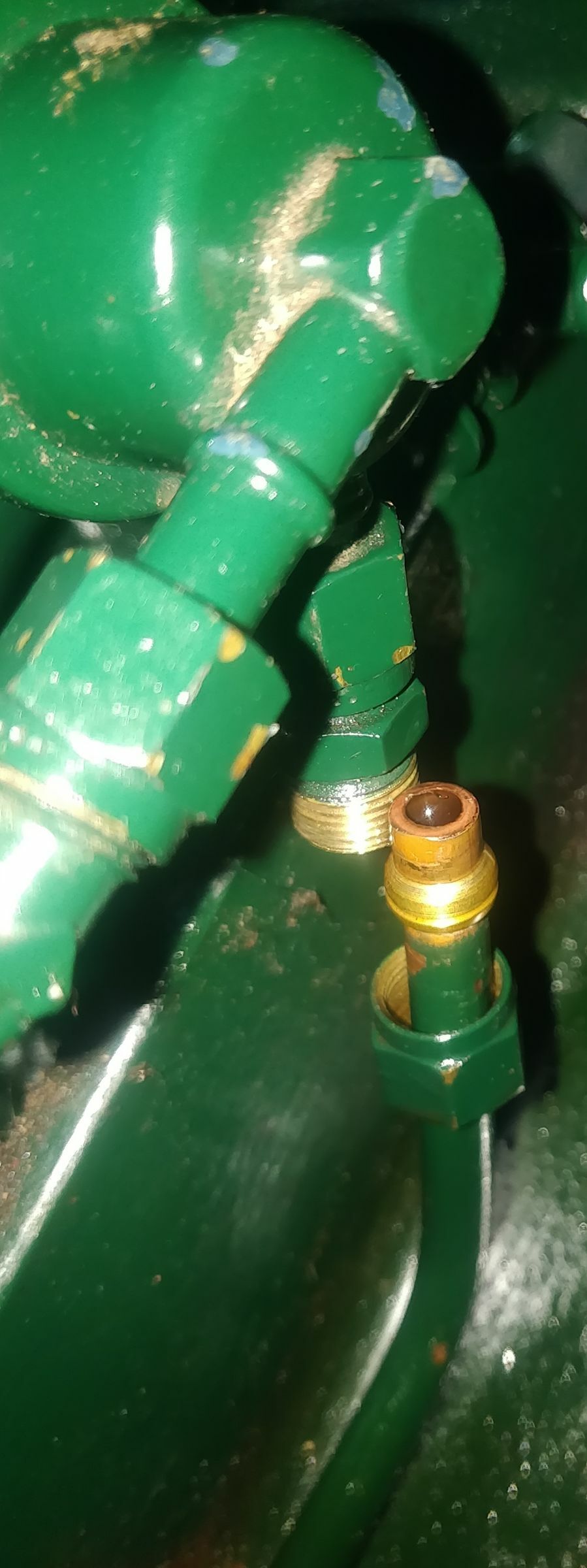

  1. Fair comments guys. I'm not entirely sure if the hose I've used would technically satisfy the BSS peeps, but I'm happy that it is suitable for the fuel used. I also understand what your saying about rubber hose on plain pipe, but in reality in this specific situation it could never come off the pipe through vibration or other means. It is a nice snug fit on the copper and with the jubilee clip done up you couldn't pull it off if you tried so I am happy that the job I've done is safe and secure. The BSS guy I use is also not a 'jobs worth' so I'm pretty sure he'll pass it. If not, then it's not beyond me to redo it when the time comes, but I seriously doubt I will have to. Please don't crucify me πŸ˜‚

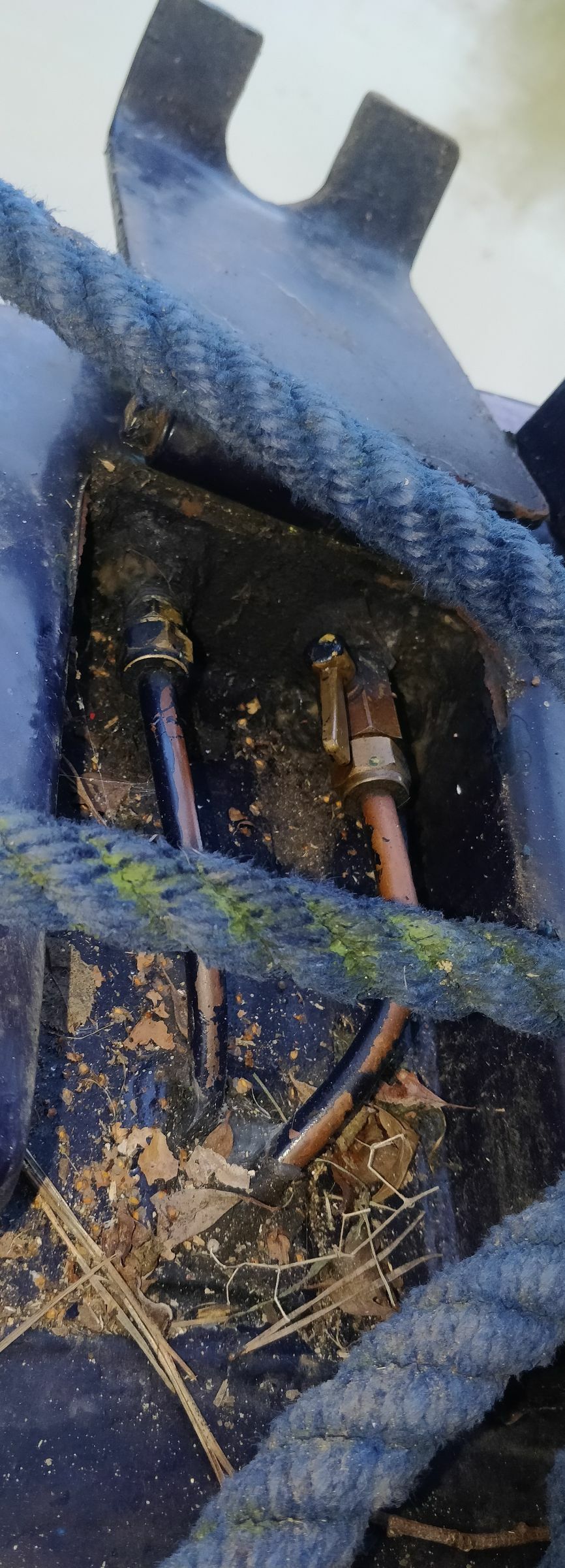

  2. Yes assuming it was your lift pump that failed, which if it died in the same manner as mine then theres a good chance it is. It's not too difficult a job. On my original pump they had cut the flared ends off and used compression fittings but I didnt wanna do that as i'd have to use a hacksaw and risk getting the swarf up inside the pump so I trimmed the copper pipe work back a bit (using a proper pipe cutter) and just used 8mm rubber pipe and jubilees as you can see from the pics. The pump itself come off easy enough if you can get to it ok. I had to remove the lower 10mm bolt by feel as access is difficult on my boat. Hopefully you'll have a new gasket with yours. Mine didn't do I had to make one but luckily already had some gasket paper. Good luck with it!

  13. My fuel tank is the very stern of the boat that's been enclosed by a steel bulkhead. The pipes come up out of the deck at the very back of the tank into 90 degree connectors one of which includes fuel cock they then go back through the deck and down the front of the tank then across the basplate where the join flexible pipes at the edge of the swim. Hard to know if the fuel would autosyphon if I open the tap with the filter undone. I'd have thought it would naturally flow out of the bleed nut if it was inclined to do so. The fuel cock may actually serve to stop the fuel flowing back into the tank , Actually the end of the pipe where it connects to the fuel pump is well below the bottom of the tank so it shouldn't drain back and should want to syphon. I guess the pump itself would be an obstacle to it syphoning up out of the bleed nut by itself hence the need to manually operate it.

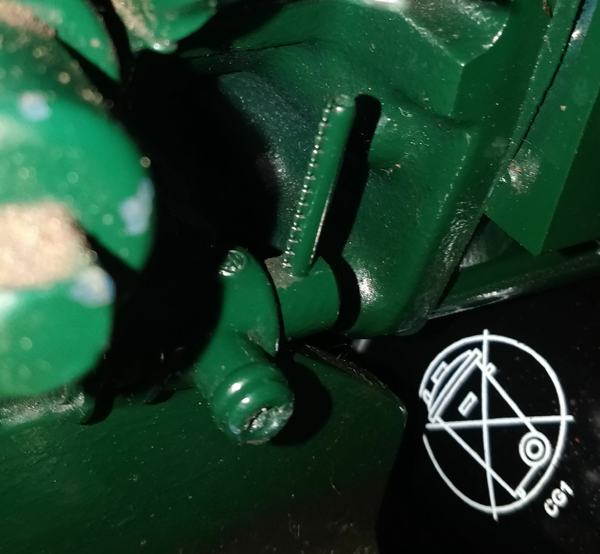

  16. Can anyone tell me what this is? A fuel drain cock?
