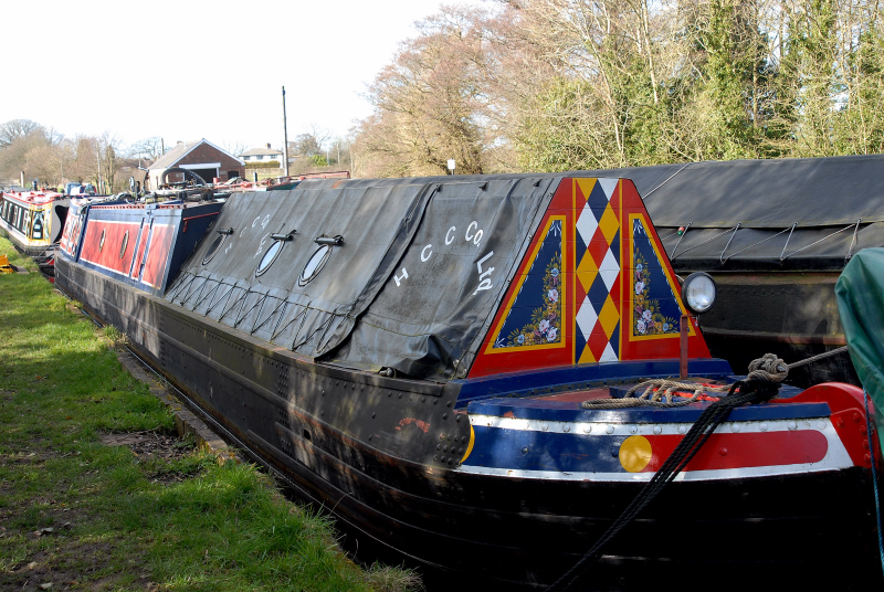

  8. Any one know if any boatyards or similar are buying narrow boats currently ??
    I have Barry Hawkins Nortwich Trader which I may need to sell and would probably not want to go through having folks turn up at the mooring.
    She has an RN DM3, runs well and in generally good order.
