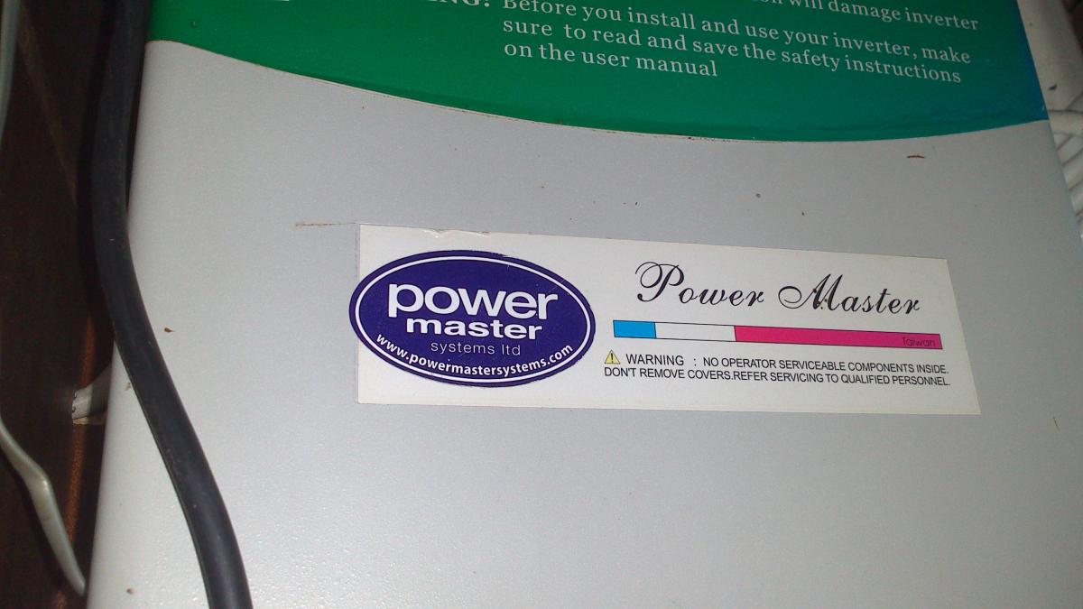

  7. Hi all, The inverter is pretty tight to the wall and one side can't be seen. Today I stuck my phone down this side and randomly took pictures in the hope I'd find some info. And found this! I'm really pleased. Now just need to find out why my leisure batteries arn't holding their charge. I have had them deep charge tested and apparently they're fine.
  8. Hi all, I've had a Powermaster inverter on my boat for the last eight years and has performed well. The problem is I don't know the output. I contacted the company, sending pictures. I had two replies from different departments there. One said it probably could be a 1200 w and the other said it possibly could be an 1800. It seems to run everything, TV, Microwave etc but not the washing machine, but the washing machine is a Zanussi, one of those small ones which for some reason cost twice the price of a normal size one. I also have an 1100cc Beta Marine generator and that wont run the washing machine either.
