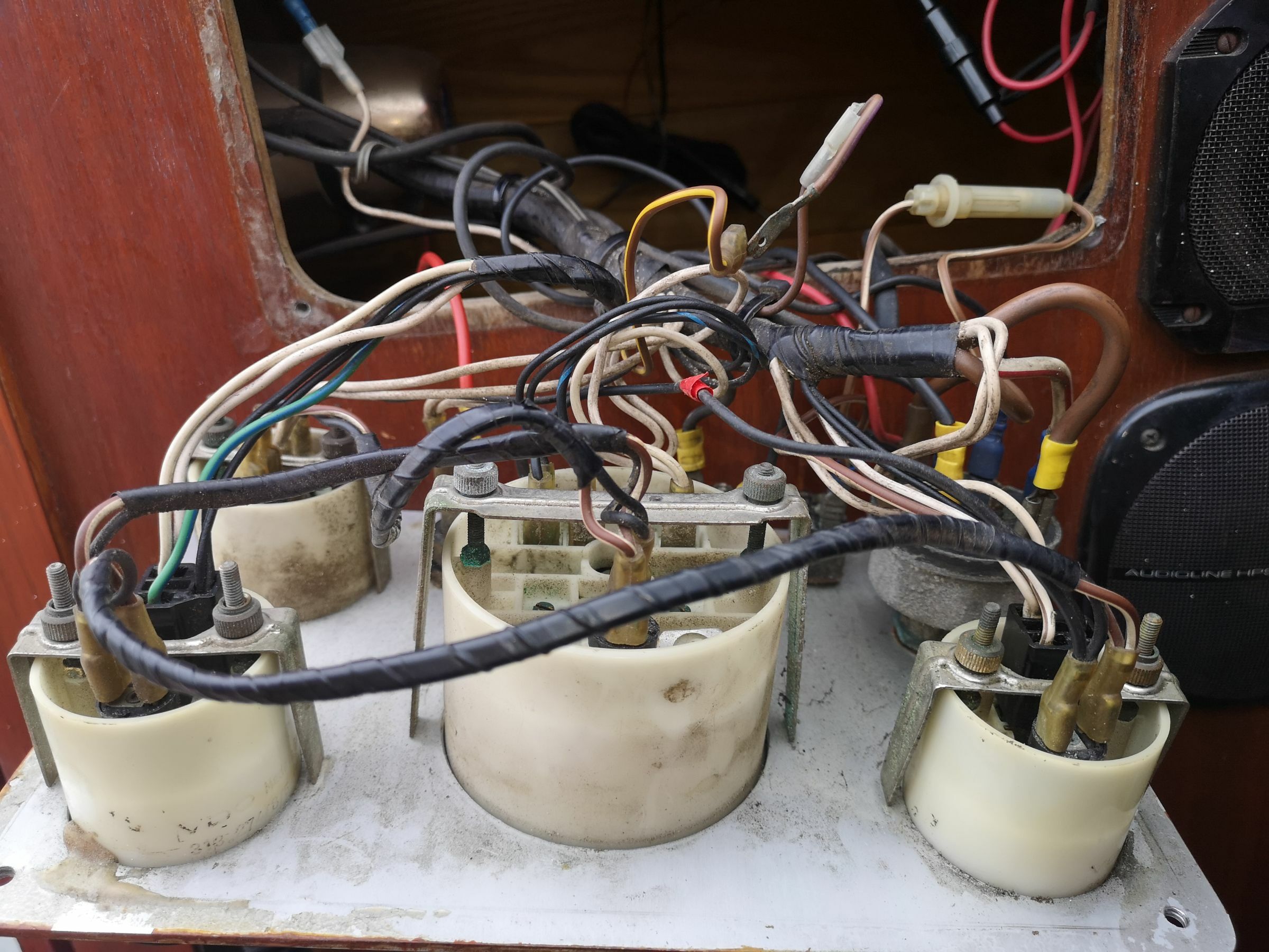

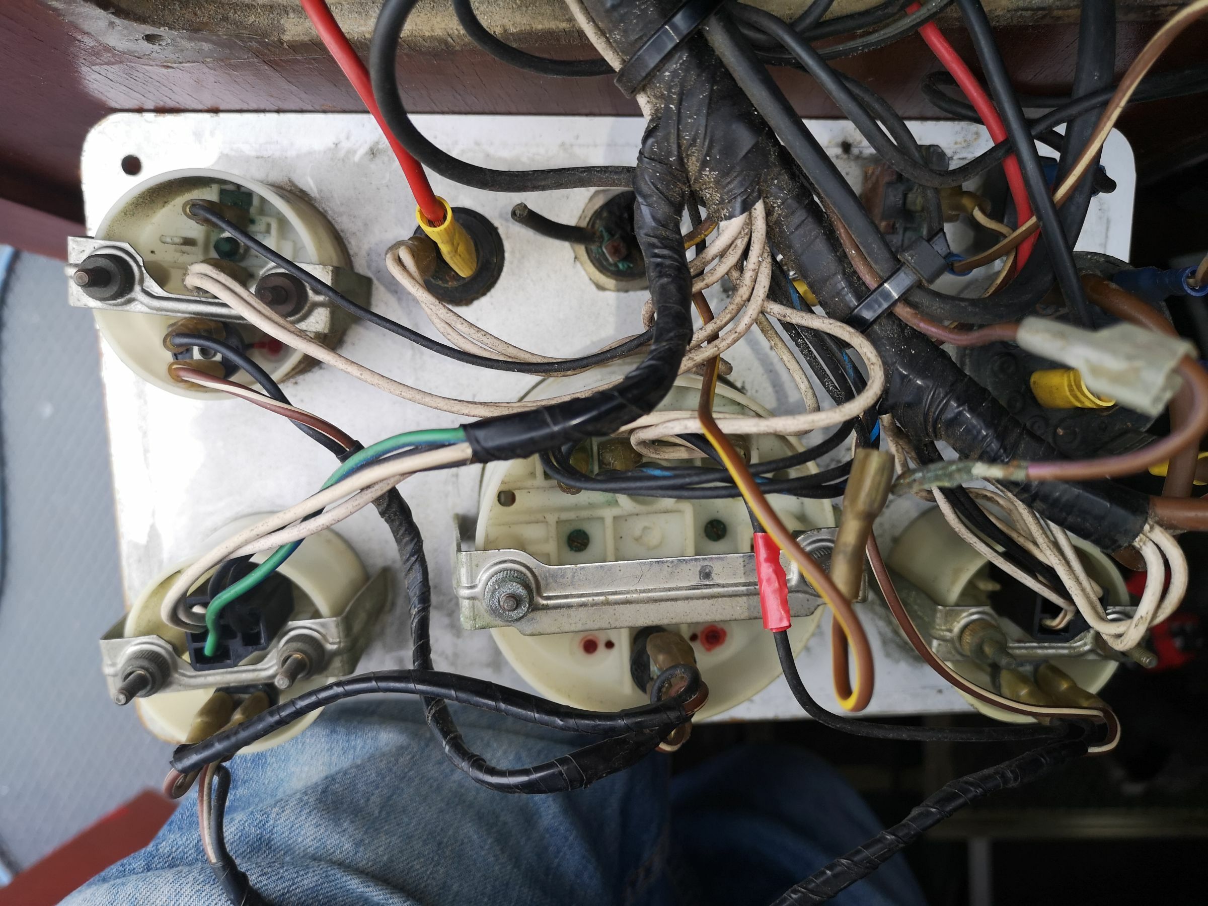

Hi Tracy, as Tony said it may be difficult to separate the sender wires as all in one shroud, but over the weekend I'll see if it's possible as I'm wondering if it could possibly be the sender's. It's a 30 year old boat and may well be original senders. Although the chances of them failing together is doubtful, I wondered could some sort of power surge have knocked them out? Probably not but maybe possible I don't know. Although the rev counter is not working, this failed some time after and not the same time as the two gauges. I'll also trace where that other wire leads to. The prospect of eating camel dung is more appealing than than trying to sort this out but it's gotta be done. Hi Tony, clicks should've spelt clocks, I'll blame predictive texting. Over the weekend I'll try running negative wire from volt gauge and try volt meter between battery positive and negative in the three way shroud. I'll also trace the black wire from the ignition switch to see where it leads to. As I said to Tracy, I was wondering if it could possibly be the sender's, thought very unlikely they failed at the same time, could a power surge have possibly knocked them out? She's a 30 year old boat and possibly the original senders in it, and the rev counter failed some time after the clocks stopped working, so poss separate issue. If so, I may have trouble getting replacement sender's to match the clocks as may now be obsolete. But need to find out if there is a working negative, which hopefully these further tests will confirm either way.
Hi Tony, I ran a wire from neg batteries terminal to oil then temp negatives. Clicks still behaved the same. I'll now try running wire from volt meter neg to oil and temp neg
Hi Tracy, I have traced the brown yellow to the alternator, I think it's redundant from an earlier alternator. There is no male connector on the back of alternator for it to connect to The brown wire is a bit of a mystery. It may be to the horn button which is damaged and disconnected, though not sure that's where it went to.

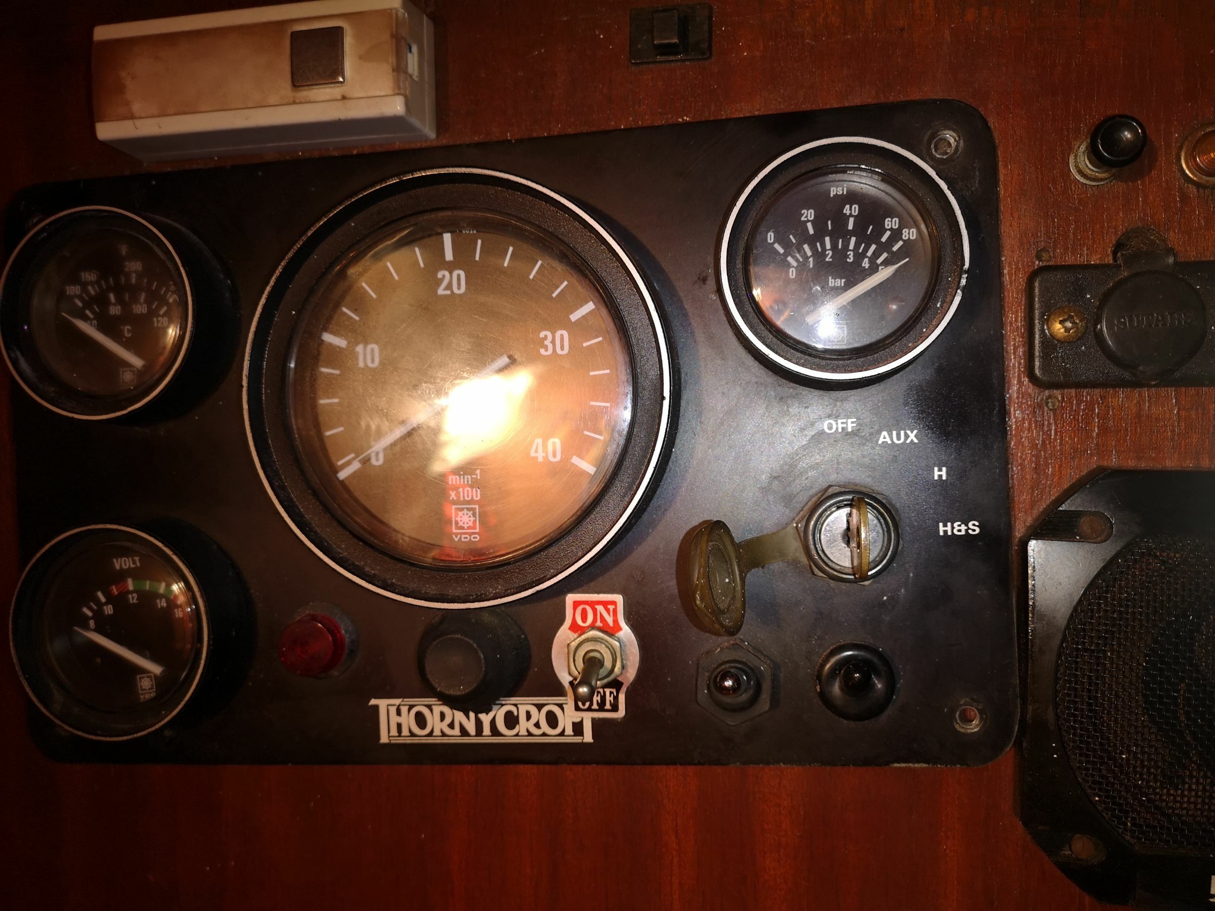

Looking at picture, too left is volt meter which works, top right is ignition set up, bottom left is temperature, and bottom right is oil pressure.
Thank you Tony, I will order these and replace the old ones. Tomorrow I'll do the test you recommend and take a pic of the back of the panel and post it here.

I'm hoping someone can help me please. My narrow boat has a Thornycroft instrument panel with VDO gauges - being a rev counter, temperature gauge, oil pressure gauge and volt meter gauge. When I switch the ignition on the temperature and oil pressure gauge swing across to the far right as though there is a shot circuit of some kind, but are earthed Ok. None of the dials are working, except the voltage gauge. The engine is a Thornycroft BMC 1800 diesel I believe also known as a 108 The cost for a new instrument panel is £850.00 ! It's just far too expensive. Is there any way I can test the gauges to see if the issue lies with them? Or does anyone know of a second hand unit for sale? Any assistance will be much appreciated.
