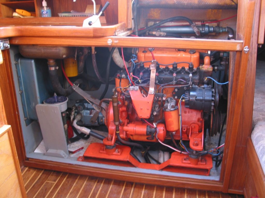

  1. Thank you gents. What would the Hurth gearbox then weigh? Approximately 46kg? All I could find was a Dutch owner's manual that states "Gewicht motor en keerkoppeling: +/- 300kg", which seems too high. I just came across a poorly scanned copy of the Thornycroft 90/2 brochure which I believe states "Type 90/2 Engine with Hurth HBW 100 Gearbox: Weight 232 kg (511lbs)". My sailboat uses a hydraulic closed-loop (hydrostatic) drive, where the engine is mounted sideways aft of companionway and is connected to a manual variable hydraulic pump. The hydraulic motor is down in the bilge. So alignment of the engine matters only to the wet exhaust and to properly sharing the load amongst the mounts. The photo is looking aft with the companionway stairs removed. The centreline of the boat is roughly at the oil filter. Thankfully no weird Metalasic mounts.
