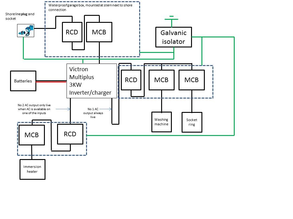

Thanks Paul, If the shoreline were to be disconnected and I was running the inverter off the batteries, would I still not need that second RCD for running the washing machine and socket ring?
The RCD standards say '7.2.1 double pole circuit breakers shall be installed in conductors to all supply circuits'. Sounds like it makes life easier
I have put together a single line diagram for simplicity and to ascertain if I have all the correct components, and wiring routes. I have included the grounding line of each piece of equipment, but not shown the grounding wiring of each RCD/MCB again for simplicity. Is there any route that I have missed? as for second AC output from the inverter, this is some blurb form the inverter spec, ' The second output is live only when AC is available on one of the inputs of the MultiPlus.' As robbo suggested there would need to be an RCD on both inverter outputs, so I therefore we have 3RCDS in the system. Is this excessive or deemed safe? I understand RCBOs could be used to save space, but have shown RCD/MCB combinations here. any thoughts on this would be appreciated. Thanks, Will
With regards to the immersion heater... the diesel boiler we are using has both options of using diesel and an electric immersion heater, with a view when you are connected to the shoreline you can have constant hot water via the immersion. Again as cc, I only want diesel to heat the water therefore will not power the immersion via the batteries.
Thanks for the all the information so far. I am do plan to have an electrician install all the equipment, but as fitting out on the water in London, they are like gold dust to get a hold of for work. Therefore I aim to purchase the required equipment so I can have it all ready for a professional to install. I plan to have a victron multiplus charger inverter 3KW. As CC the 10A MCB was an idea to discourage high AC power use, and an idea i shall put to bed. I shall put together a diagram to aid my description. Thanks again for all the information, Will
Before embarking on installation of my AC system, if anyone could share any information on the following I would appreciate it. According to the RCD (recreational craft directive) is the following AC system acceptable? (I shall start form shoreline connection to AC outlets) Shore line connection plug fed into an RCD (residual current device) within 0.5 meters form the plug, the RCD shall be housed in a waterproof box next to the plug (a garage box). This RCD shall feed into two single pole MCBs, one connected to the diesel immersion heater, and the other connected to the inverter. Out of the inverter I propose to feed another RCD, housed within the electrical cupboard which shall feed two other single pole MCBs, a 10A MCB for a ring circuit of ac sockets (12 sockets, which I know is a large amount for one ring, but with 2.5mm cable and a smaller MCB this will reduce loading the sockets with the full whack of the 3KW inverter), and the other 12A MCB for a washing machine. My main question is... Does the galvanic isolator need to be connected at both RCDS or would connecting it to the first RCD ground the inverter through the galvanic isolator? Or do both RCDs and Inverter require grounding through the galvanic isolator. I will also be connecting the inverter to the batteries but that shall be for another day. Thanks, Will
