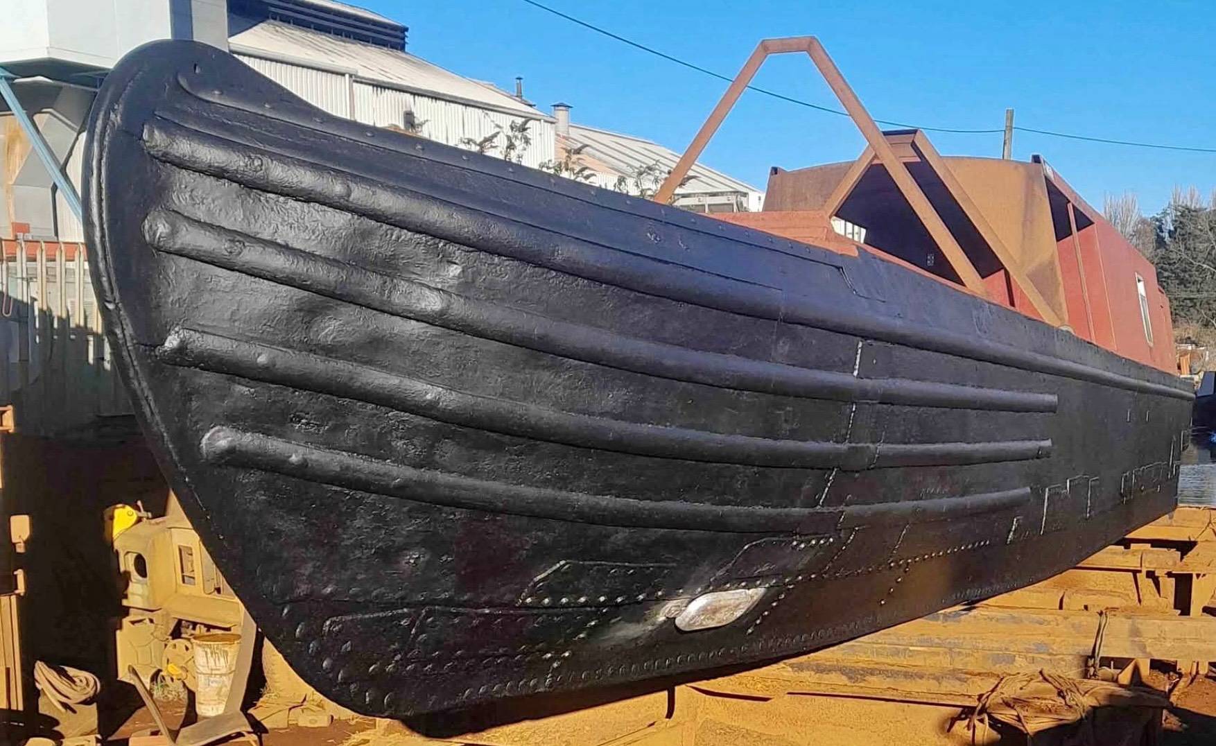

How was that put together? Presumably the whole lot was rivetted originally, wonderfully patched as and when but the upper part of the stem looks to be welded
