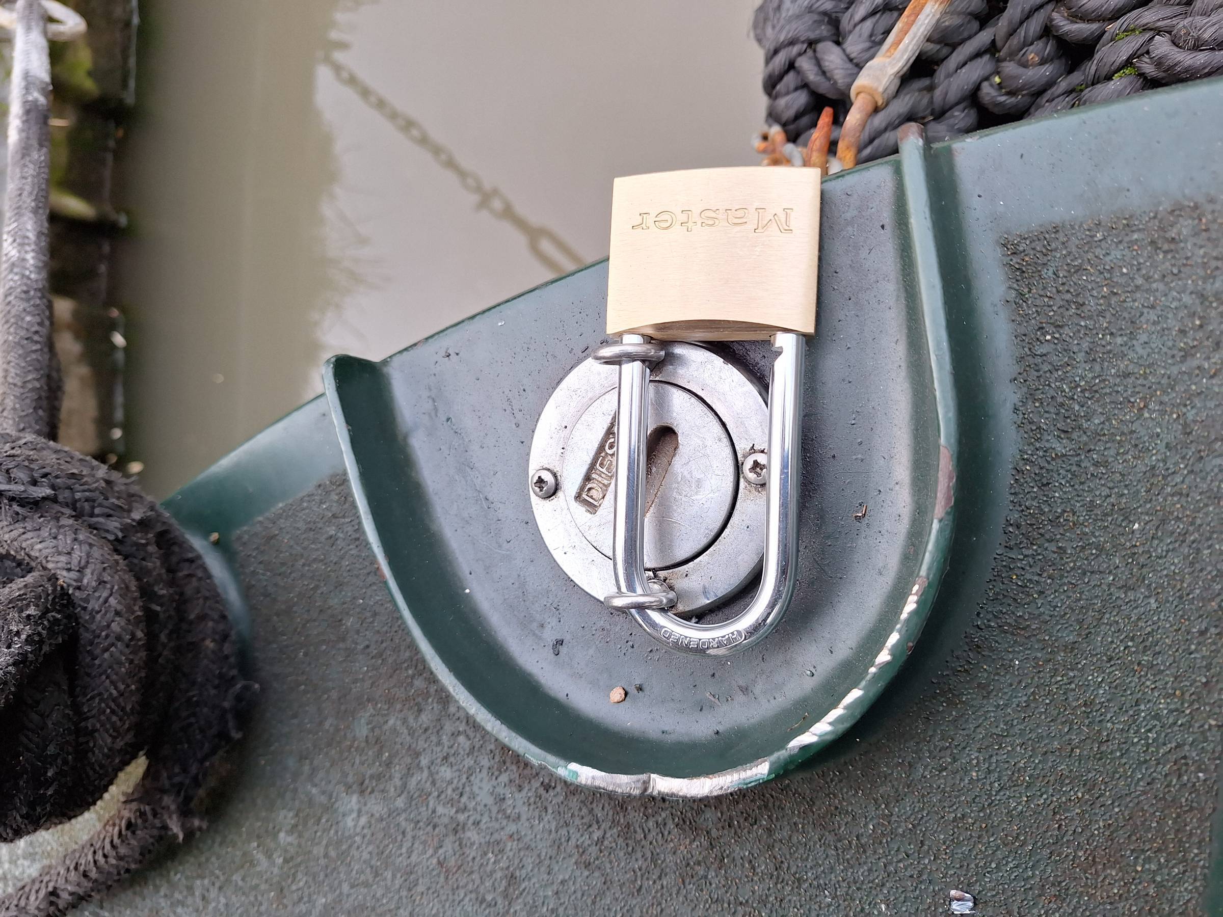

  2. Yes, I think it would probably be OK for some areas (eg the Llangollen, or around Nantwich/Middlewich maybe). And its OK for when I'm generally around, as you say. But if I left the boat somewhere a bit iffy for a night or two, I think it would pretty easy for a scrote to prise the eyebolts loose, or break them. I'm crap at DIY so I'll end up making a mess of the whole area if I do much more ironmongery work, so at the moment I'm leaning towards the £75 lock. Its a lot of money for an event that seems to only happen very rarely, but I'm heading further south, and I'm worried that the people darn sarf aren't going to be civilised like wot us scousers are 🤣
  3. Its a cheap padlock from Amazon (I'm guessing fuel thieves wont be expert lock pickers like some bike thieves are), but its adjustable. The shackle part of it was originally much longer but I ground off a few inches, to allow me to get the shackle through both eyebolts. I also had to grind down a bit of the outer ring in order to get the shackle down at a low enough angle that it would pass through the eyebolts, so that's not ideal. But I can tidy that up and paint it, and it wont be too noticeable. It is locked in the pic, but one of the two arms of the shackle is a bit shorter, and goes only part way through the padlock - if I left that arm any longer, I couldnt get it through there. The diameter of the outer ring is only about 160mm, and the cap is about 80mm wide, so there's very little room to fit in a long shackle without some more grinding away of the outer ring. I'll be passing Braunston in a week or so, and I'll decide then whether to invest in a more secure lock, or take a chance on this one, as its more of a visual/casual deterrent.
  4. Just a quick update, I've put in two M4 eyebolts as suggested by ex-brummie, and a padlock. Its not a very strong setup- the eyebolts I've used seem quite thin, and it could be smashed off with a hammer fairly quickly. The hope is that if approached in the dark and with a need to work in silence, the thieves will be deterred enough to give up. I'm still pondering something stronger, using M6 or M8 bolts set into the deck, but you dont have a lot of wiggle room in the centre of the raised steel ring, and I might still go for the Midland Chandlers lock contraption, as extra protection if an attempt is made whilst the boat is left unattended for a few hours or overnight. But at least for now, I have something better than a cap that just unscrews.

  6. That's a cracking idea, thanks very much. Two M4 eyebolts and a weatherproof padlock, job done. Doesnt have to be strong (for most of them anyway)- they'll see a padlock and just move on. Another option for more strength would an M8 eyebolt. You'd have to drill and tap a new M8 thread into the deck on either side of the filler cap, so its not my first choice unless the M4 ones get ripped out.
