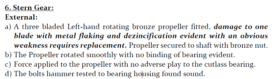

    Good and valid points. I am not a metallurgist, maybe the term is used generically for any leaching from an alloy?  I am going on what the surveyor says which is
    Dezincification is what causes problem in seagoing vessel that have seacocks made of brass these days, and not the better metal, bronze.
    Bronze - copper and tin. Brass - copper and zinc. Bronze seacocks can cost in the region of £300.00, so brass is more common, and cheaper. Corrosion resistant, but still not up to the level of bronze.
