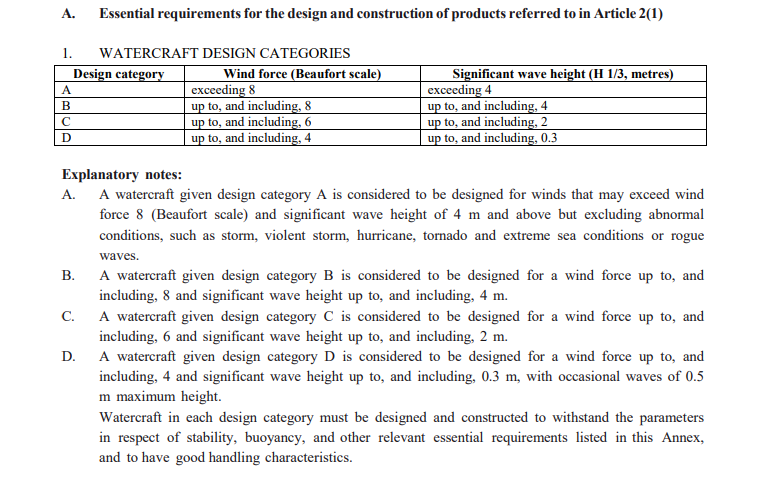

2 hours ago, Alan de Enfield said:I'd still suggest the use of a Truck - it'll cost a little more but it will arrive on the day you want it (no sitting in port for days awaiting that 'calm day') and you get to use it on the calm inland waters that both you and it are 'designed' for.
Having a big engine is of no great benefit, - it is a displacement hull and once you achieve maximum hull speed (about 8 knots in your case and watch the fuel gauge descending) you could have a 200hp engine and it wont go any faster you just start pushing a bigger and bigger mountain of water in front of you.
It is the lack of stability and lack of draft that is the problem. A NB / WBNB is a category D craft and is designed to cope with conditions found on Inland waterways, and as many have found out even the waves on the Thames can be 'concerning' particularly the big wakes from passing craft.
The boat will only be certified for use in waves up to 0.3 metres (1 foot) and winds of up to force 4 (about 12-15 knts where dust wind and small pieces of paper are moved You will get waves up to 4 feet high if the wind and tide are against each other).
"Wind Over TIde Gives A Rough Ride"
It can be a gentle tide and a gentle wind but in certain conditions will give still give a very choppy 'short' sea which is uncomfortable (at best)
You may find that your insurers will not cover you for the the tidal part of the journey, or will demand a large premium 'added'.

40 minutes ago, Alan de Enfield said:
The Sea conditions can change within hours if not minutes, the sea is no place for a slightly portly flat-bottomed narrowboat.
Unless you are an experienced sea-skipper and understand the 'signs' and making tidal passages I'd strongly recommend using a truck.
I am not experienced but know a skipper who is and is happy to help. I wouldn’t normally risk with a NB type it the engine is so powerful I think could be OK on calm day
