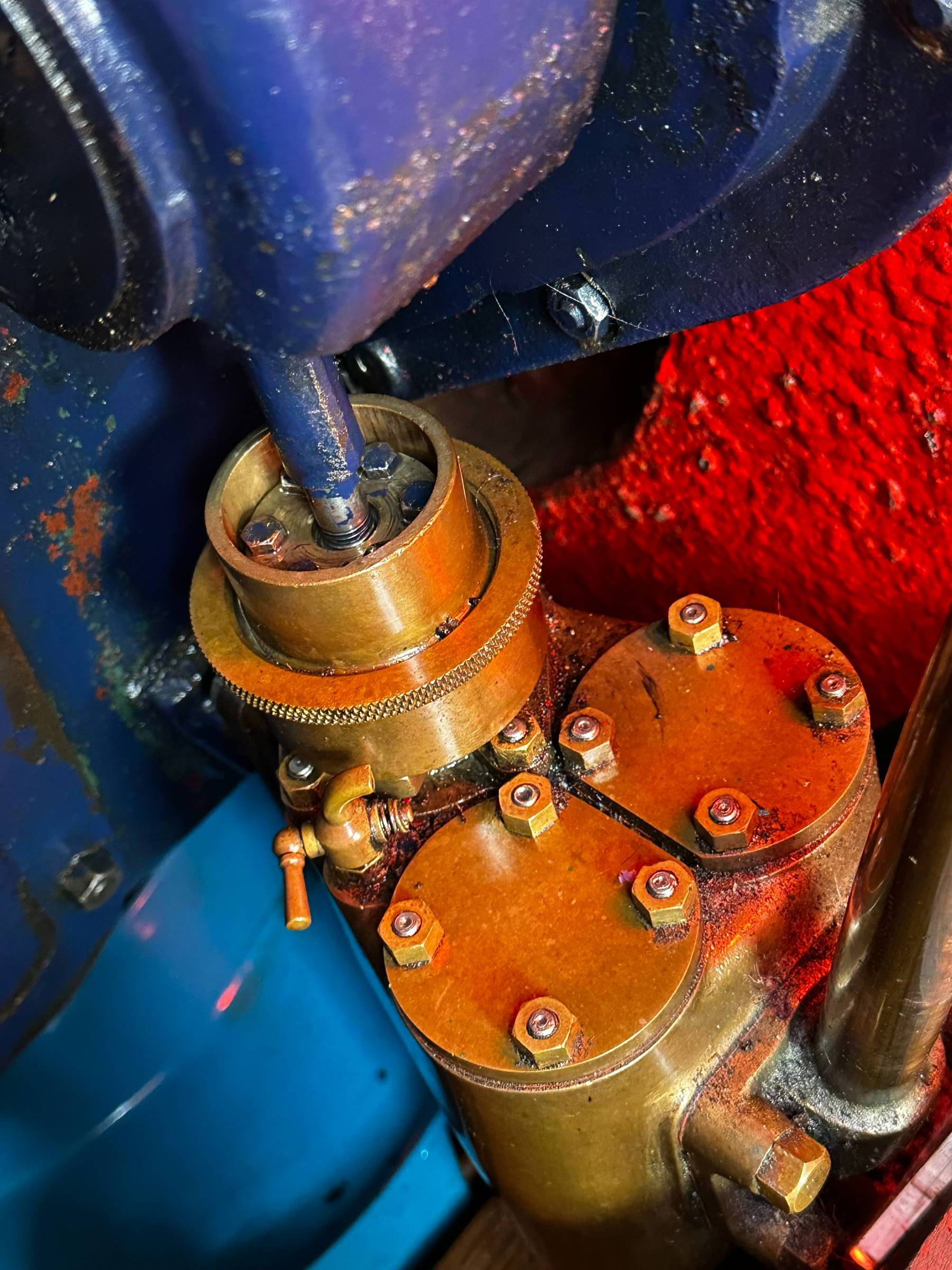

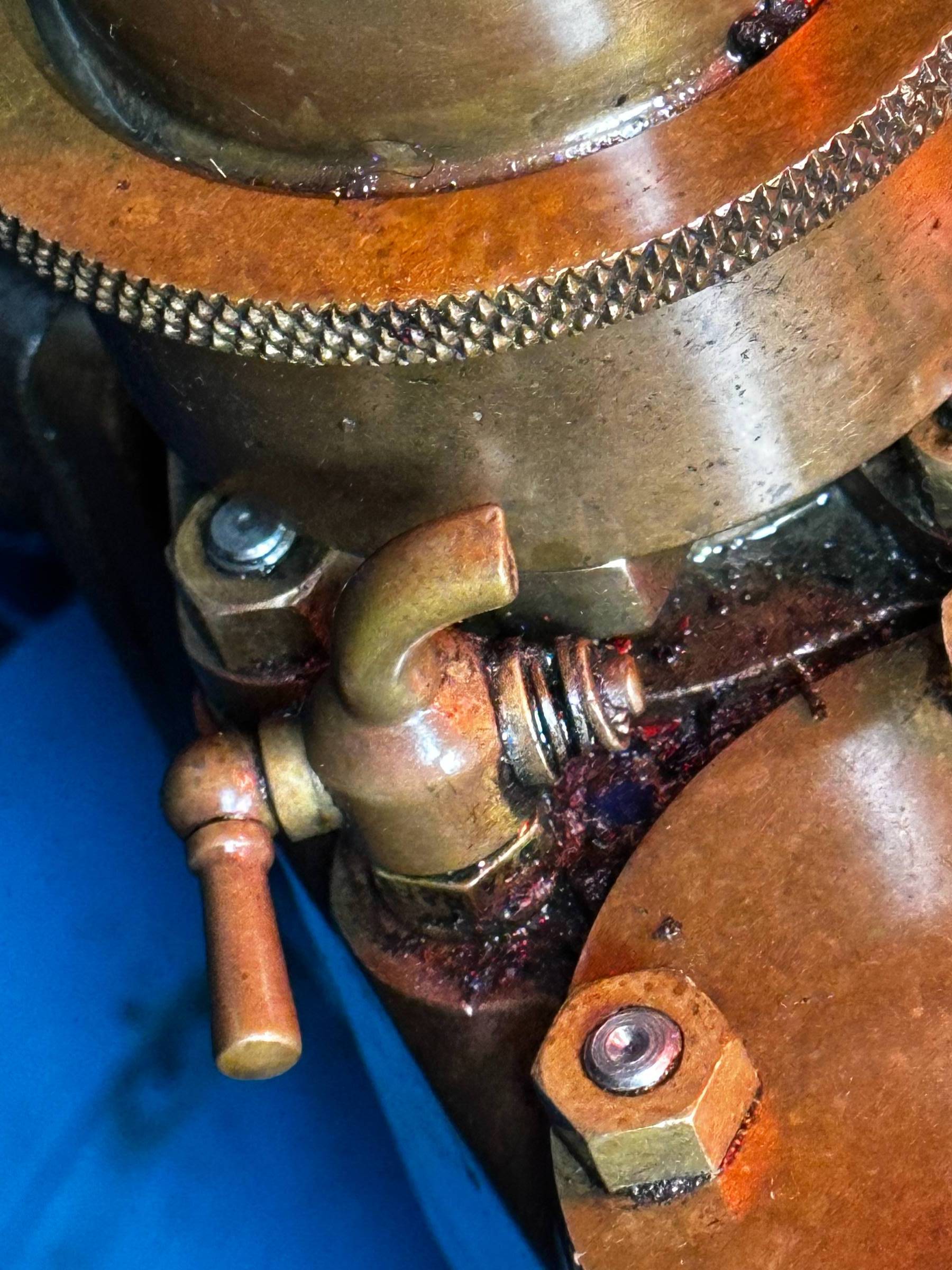

  6. Hi All, Picky Brain Time. During my visit today, and a couple of weeks ago, my engine may have developed an issue whereby until it reaches optimum temperature, the fuel appears to drain from the Governor, which then makes the engine cut out. When i turn the throttle wheel up, and restart, there is no issue and all runs well. Can i ask one of you officiadoes, what do you believe could be causing it. I have no apparent fuel leaks, so not sure why it is not filling correctly. Do you think it could be filter related? Thanks in advance.

  10. Hi All, Thursday's visit was eventful. Once i had cleaned all the water up and dried her out, i went through all the checks recommended by you all, thank You, and once i had refilled her, i could hear a spitting noise when turning her over. On further inspection, the Drain Cock on the pump had somehow been knocked open. All other checks were good apart from the fact i couldn't find any pump packing in the toolbox. I will contact Tom later today to see if he can come down and re-pack the pump as it is no good me stripping it down on Monday, only to find i cannot finish the job.

  15. Thanks for the info. I will double check the quantity on Thursday to ensure i have enough. Is it as simple as releasing the ring and the piston will come out at the top?

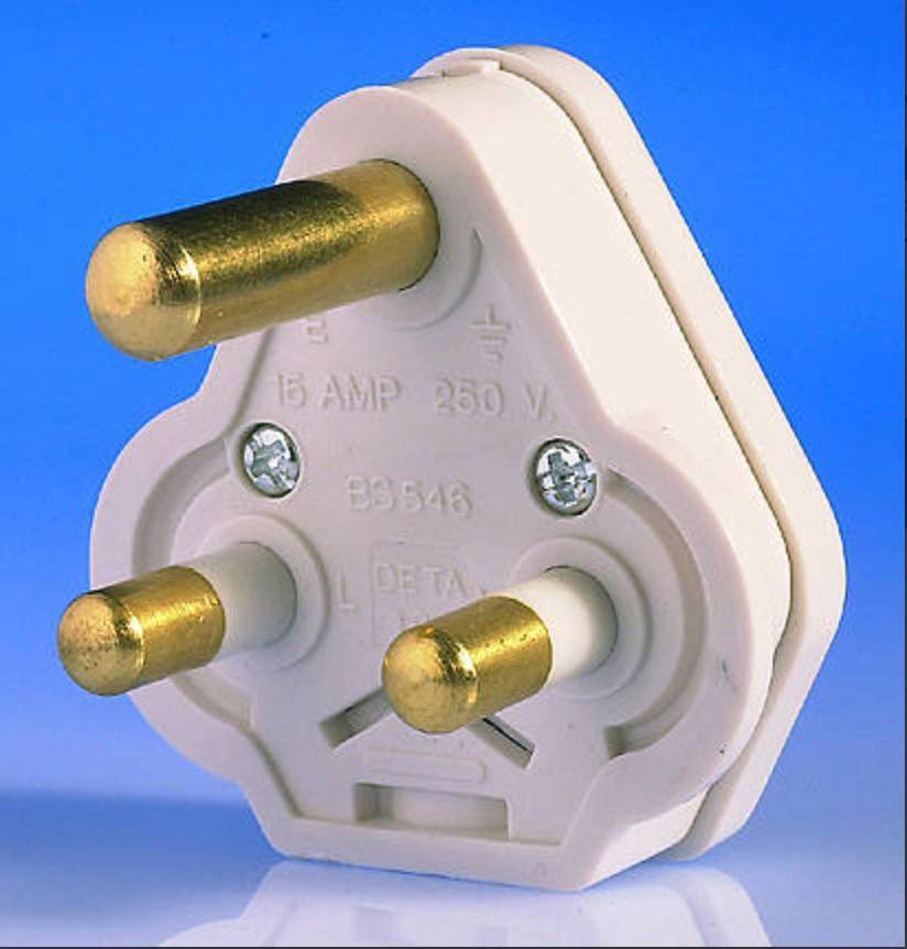

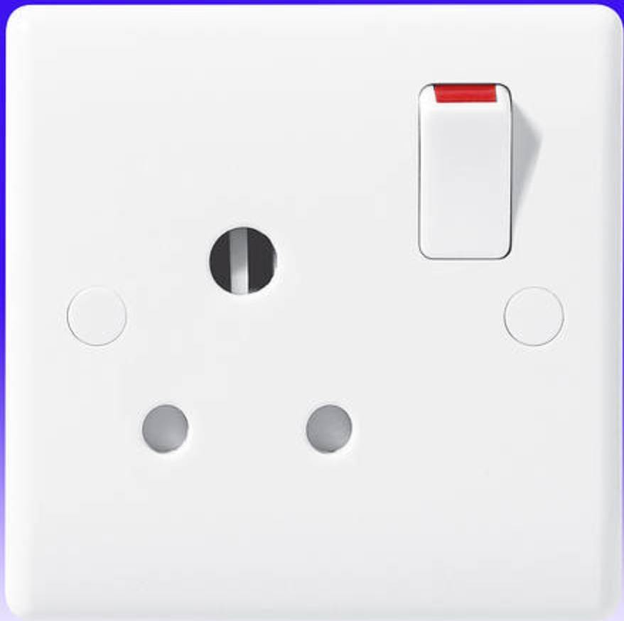

  23. I have different sockets and plugs for the 230V and 12V which are physically the same size, but round pins for the plug and sockets. As the 12v are round, so there can never be a chance of mixing them up. Although they are rated at 15 amps, they are perfect for 12v circuits.
