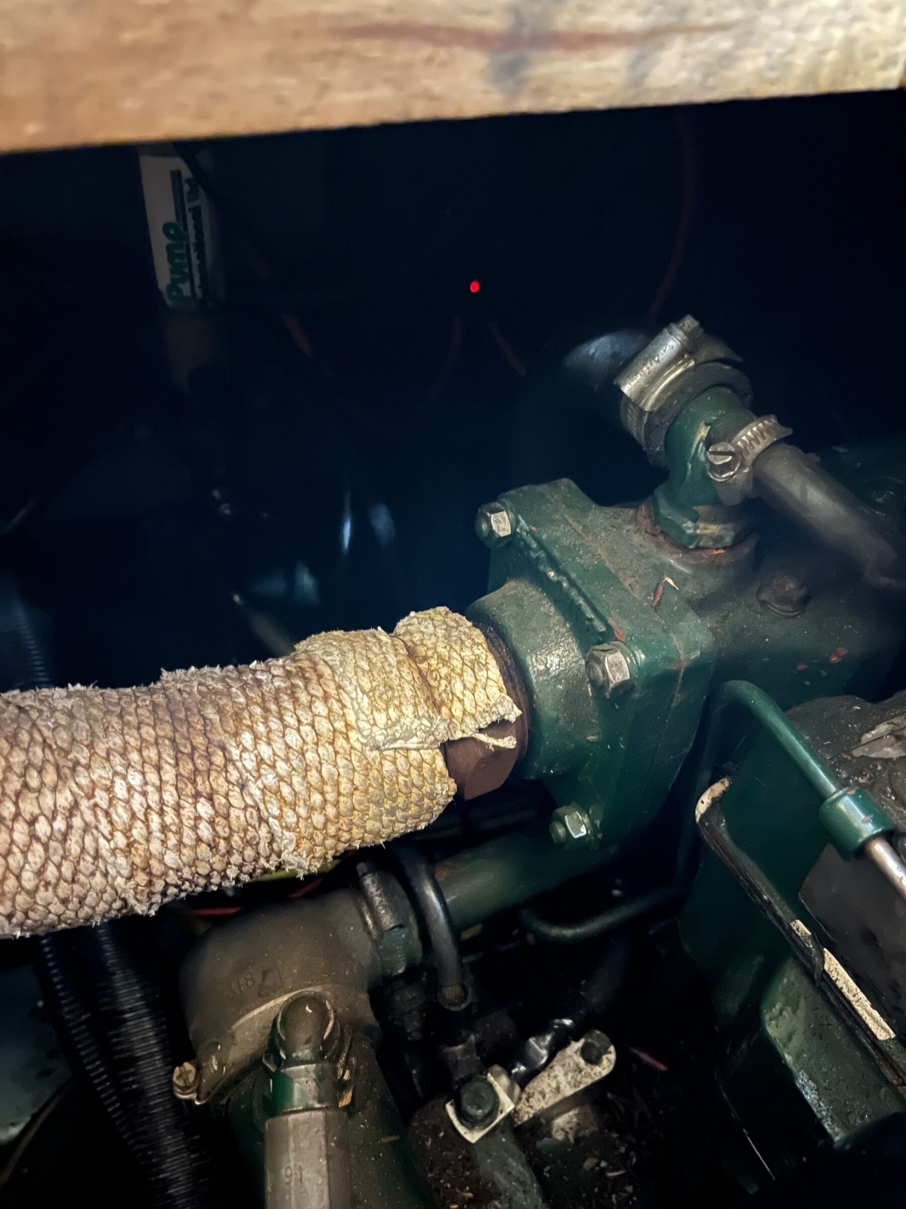

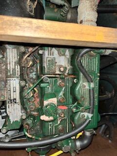

i’d be surprised if the pipe isn’t a flexible the hex end looks identical to mine and the way these engines shake it would crack pretty quickly if it was solid. To be safe unwrap a little bit as a Tony says.
well you certainly have persuasion skills !
I also find it interesting hence asking so many questions and wanting to figure it out.
I’m going to have a bash at it, worse case scenario the engineer who is already coming out can fix but sounds like not much can go wrong ? Whilst I’m at it I’ll re wrap the exhaust in new wrap
19 minutes ago, Peugeot 106 said:
Go for it. those are the 4 M8 nuts!. I think/hope you will find that the exhaust as I previously said under the white glass fibre is braided hose. You don't need to take the insulation off just undo the nuts and waggle the white covered pipe out of the way. You will I'm sure find its flexible braided stainless steel don't worry it is virtually impossible to break There should be a fibre gasket held between the flanges (square flat surfaces) held in place by the studs (bolts). Gasket should look probably similar to brown card . It should be solid , undamaged with no holes apart from the 4 stud holes. If it looks at all knackered or has any holes in it get a new one.
The nuts look pretty new so should come off easily. If you use a spanner you should be OK and not strip anything. If you have to use an adjustable spanner take care as they are longer and hence put more force on the nut. I am only saying be careful with the nuts out of caution as I don't think you are familiar with spanner work. Even if you did strip one it is not total disaster. They can be fixed
When you undo the nuts the nut may stay on the stud (bolty bit) . Thats fine just wind the whole thing out. It'll only take you 5 mins probably!

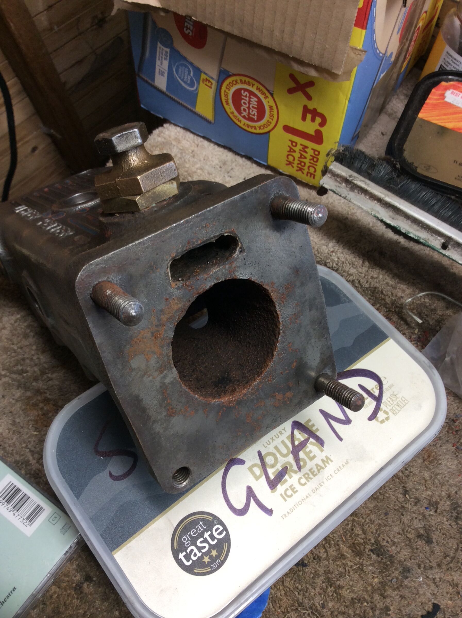

5 hours ago, Peugeot 106 said:
I’m assuming that you have skin tank cooling and not raw water cooling. The exhaust manifold will probably look like my photo although there are some specifically for skin tank cooling without the slot.
For skin tank cooling the slot is covered by a full gasket stopping water coming out of the slot and into the exhaust. The water instead exits via an elbow in the top of the manifold into the skin tank. If this full gasket fails you will get coolant leaking into the exhaust (and also into the cylinders). (For raw water cooling the coolant comes out of the slot and is “injected” into the exhaust so the manifold with slot is used for both methods of cooling). This would explain the spitting from the exhaust (as would water that has leaked into the exhaust) the oil is probably out of the exhaust it can be yukky inside it! You can buy new gaskets from Sleeman Hawkenbut specify the one without the slot! I think it could be a good idea to prevent reoccurrence with a metal plate as well as the gasket. This is a known problem with these engines and can cause terminal damage if left.
A bit of black smoke if you change revs quickly is quite normal caused by temporary over fuelling.
I think the oil leak is probably a separate issue but you need to attend to the manifold gasket promptly to avoid damage if that is the issue
Hope this helps. I have had issues with oil leaks on my LPWS2 and can probably help in the future but fix the water first!

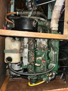

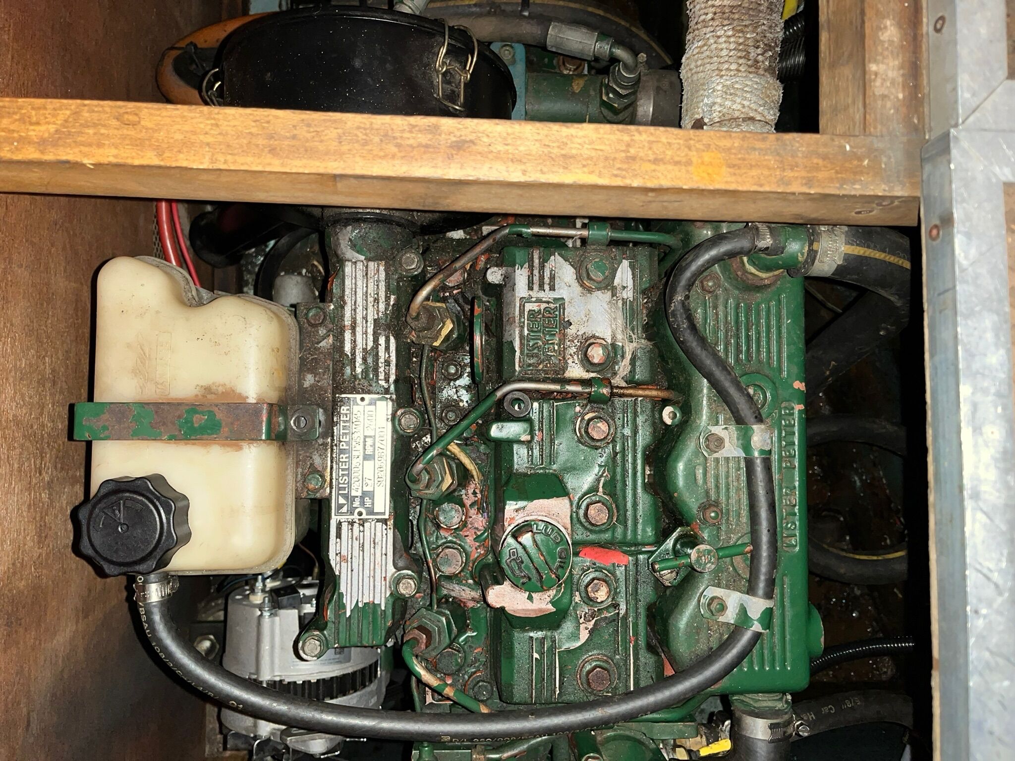

28 minutes ago, Tony Brooks said:1. A minor fuel leak from a banjo bolt is unlikely to cause any problems.
2. The lost bolt is almost certainly a nut and set screw (a set screw is a bolt with the thread all the way to the head. Any old matched nut and screw of the correct diameter will do.
3. That header tank is an automotive unit, I doubt Lister paid to have them specially made, so the markings relate top a vehicle with a far lower coolant capacity than a tank cooled canal boat. Accepting what was said about that exhaust flange gasket it sounds to me as if the coolant loss may well be because you are overfilling it for your coolant capacity. If you do not top it up and kit drops another 5 to 10mm, then another 5 to 10mm then it indicates a leak, but if it does not drop then you were over filing it. See my advice above for establishing the correct maximum level.

53 minutes ago, David Mack said:
White smoke can be caused by unburned diesel or water in the exhaust. If it doesn't clear pretty quickly after starting the engine that could be indicative of injector problems or a failed head gasket. Either way it needs looking at by someone who knows what they are doing.
The smoke is not constant it’s only ever when I rev quite high but yes agreed will get someone out who knows what they are doing, cheers
48 minutes ago, Alan de Enfield said:
I'd say - YES and probably all down to lack of maintenance.
I have the workshop manual for the LPWS engines and if you would like a copy, send me a message with your email and I'll forward it to you.
The LPWS engines (when well maintained and serviced every 100 hours are superb engines - mine had done well over 10,000 hours and never used (or lost) a drop of oil. When we bought the boat the bottom of the engine bilge was covered in white kitchen roll and it never ever showed a 'spot' of anything between services.
I rate them VERY VERY highly, but they are not just "use and forget" engines, you have to give something back.
Edit to add : I also have the operators manual, detailed specifications and full part number list of every component if you would like them.
Hi as not done enough posts on here I can’t access/ send PMs. Would be very useful
Lister petter Lpws3 exhaust spitting/ leak
in Boat Building & Maintenance
Thanks Steve this is good to kno!
and Tony good to rule things out so I will have a look tmrw along with testing the header tank and the exhaust manifold.
question which may seem simple but just want to clarify- buy filling up to the brim do u mean right up to the the opening of the header tank or the line inside the tank?
and by venting do you mean, conduct the test with the cap off ?
Again apologies if seems obvious
