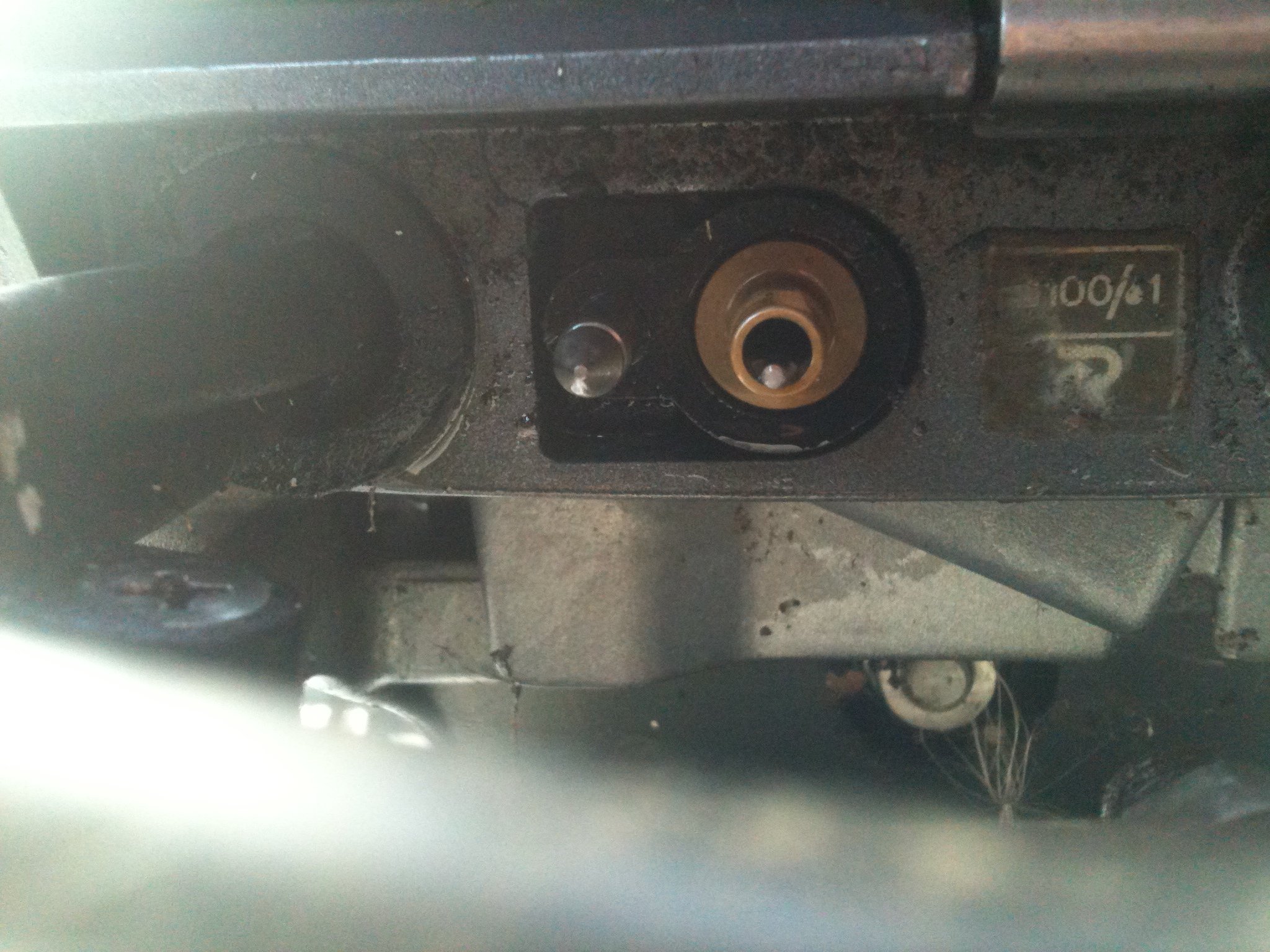

  22. hey tony, yes you are completely right the 'tray' im referring to is the transom. and you are completely right that this is a picture of the socket on the engine with the fuel line disconnected. I'm gonna go back to my boat and remove the cover of my engine and have a look. I think i need to try to find a mechanic that might come and have a look at it for mates rates because i have got no money ha ha. but thank you so much for your help. I have at least narrowed it down and at best learned a little bit about my engine. thanks for your help. x x x x x
  23. Wow thanks so much Tony, really detailed and helpful advice. its a bit tricky for me to follow saying as i dont know anything about engines. I have pretty much found the drip. the engine still runs fine but when its running the dripping gets really fast drip drip drip drip and i can see it falling into the tray that the engine is bolted onto. Im pretty much convinced the leak is coming from where the fuel line connects onto the engine. I have taken a photo of the socket that the fuel line plugs into. Am i correct in thinking that the socket on the right is the needle valve? leading to the carburetor? (apologies for my ignorance ha ha but im trying to learn) Is it normal for the metal pin in the needle valve to slump down like that? or should it be dead center? could this be my problem? Or is it more likely to be some damage to the fuel line plug? Because i guess if it is the needle valve then i need a mechanic and if its the fuel hose i can just buy another one. I know i am asking you to try to diagnose my fuel leak from a photo which is pretty much impossible i would think but just any pointers or advice would help me out as to my next step. Thanks again for all your help and patience with a total newbie. thank you x x x x xx
