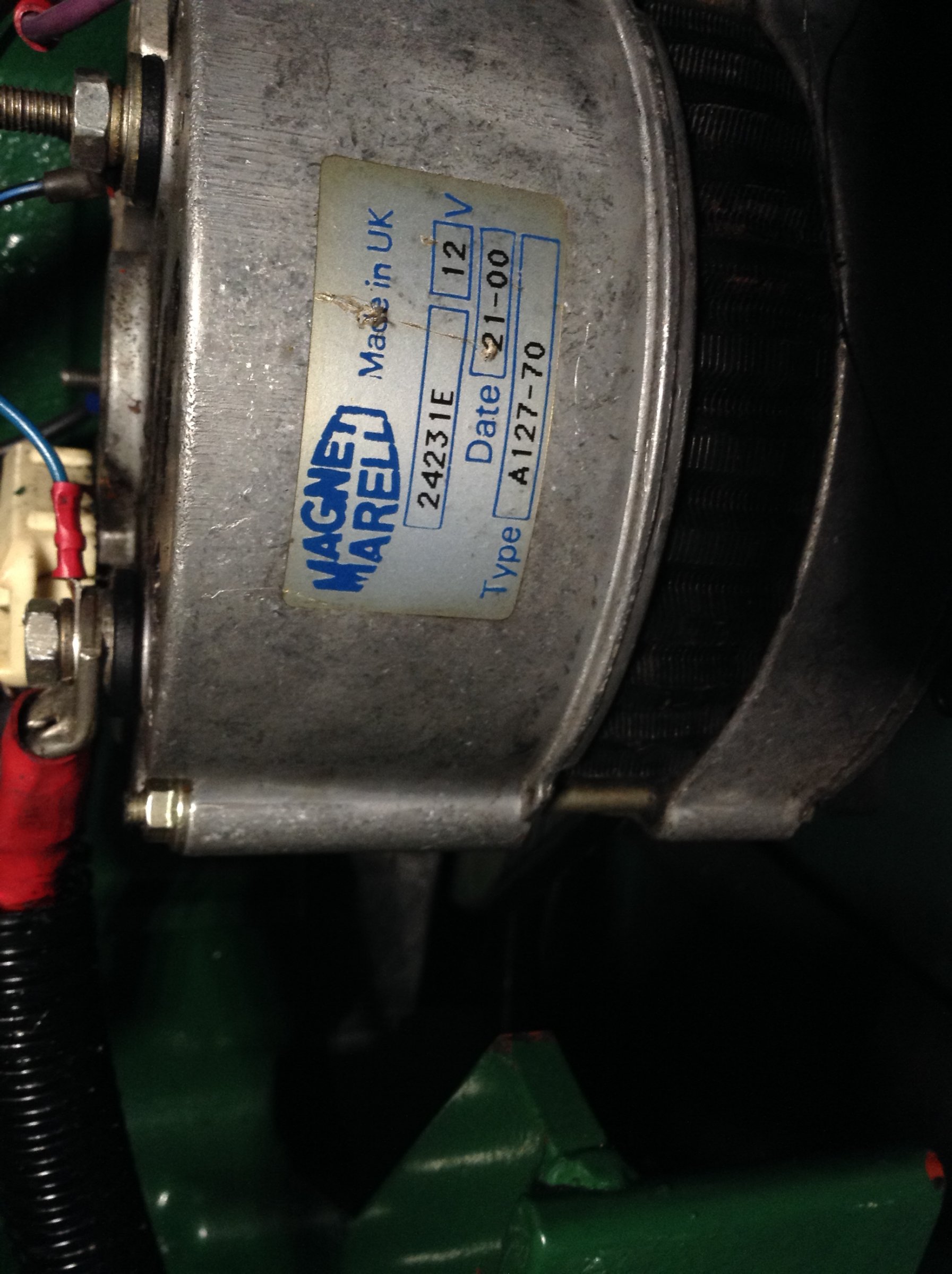

Just a quick update some days later; with the boat blacking done I could finally get around to swapping the old alternator for a new one today. The old one came off easily enough, the new one largely went on without too many issues though as someone suggested, I did have to swap the (thin, v-shaped) pulley on the new one with the old (lots of little v-shapes) pulley. That was a right palaver, since I lack the appropriate tools but a large spanner on the pulley nut (banged with a lump hammer) with a screwdriver simultaneously shoved into the old alternator to stop it spinning gave me enough leverage to get the old one off. The new one I had to use the same technique for but a bit more carefully since I didn't want to mess the new one up. Managed it somehow, swapped the pulleys, installed the new one and it works (well, the batteries immediately showed 14.5V as soon as the engine started, having previously been showing 13.something with the engine off). So once again thanks for all the help. (edit) Oh, and should also mention that the new alternator is not steaming hot while everything's off, either! -

Here's a not terribly good pic. Am I right in thinking that disconnecting that +ve means I've got to be very careful the spanner doesn't touch any of the rest of the alternator as that'd be ground and then there'd be a big bang? I didn't understand a word of that, sorry but I don't have any lights on anywhere although I'm not sure I even have a "charge light". Ignition is off though inasmuch as the switch is off and the key is out -

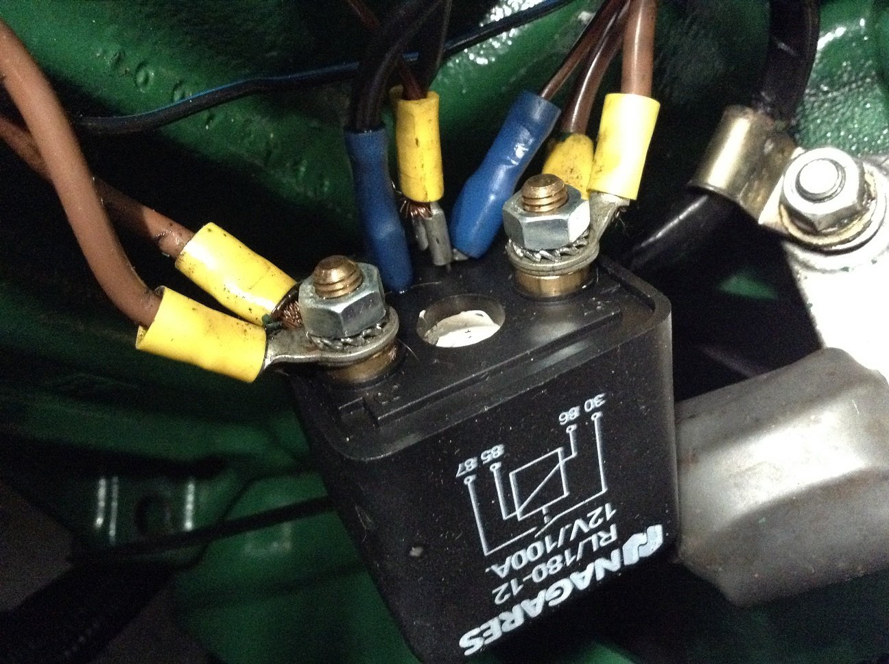

If it were a voltage-sensing relay then I imagine that would make sense (and indeed be desirable perhaps). It isn't though, it's one of those relays that has a distinct "trigger" across two pins of the relay and that should normally be off unless the engine and alternator are on. Or, has someone transformed it into a VSR by virtue of connecting up the leisure bank to it? I suppose it depends what voltage the relay needs to trigger but it seems odd in my limited understanding of these things. -
Hello After some work was done on my engine recently (not by me), I noticed the starter and leisure batteries were showing exactly the same voltage which seemed unlikely. Several measurements were taken and in each case this was true. For reference, i have 3 x 110Ah AGM leisure plus one 95Ah starter. Charging is from alternator through split charge relay, Victron (when on shoreline which I am not at present) and MPPT solar. The voltage across the relay's trigger pins is 12.0V. The solar is currently sticking 13.2V into the batteries which I have also measured across the alternator terminals. The alternator is getting quite warm which alarms me. Moreover, when the sun goes down this evening, i will presumably be drawing fridge power etc from all the batteries instead of just the leisure ones. Being very non-expert at this, should I - for ease until someone can look at it next week - simply pull off the blue-capped wire that goes to the alternator earth (number 85 on the relay) overnight so as to de-energise the relay and only drain from the leisure bank? I also noticed while cruising yesterday that the voltage (being observed on the solar charge controller) never went above 13.2 but I'd have expected the alternator running to shove it up more than that unless maybe the relay de-activated itself while engine running (in which case I'd merely have seen whatever the solar charge controller was putting in which may be 13.2 perhaps) I have attached a pic of the relay connections. There are three wires going to "86"; one with a blue tip stems from the alternator and I would presume to be the expected trigger for when the alternator is running. The other (yellow-tipped connector) has a (disconnected) Adverc brown wire plus another brown/black wire which disappears off towards the starter motor with the +ve cables from 87, possibly (though I can't see it) onto the starter motor +ve as this is where the cables from 87 attach. It's all a bit peculiar because I thought it had all been put back the way it started, and it's been like that for the last two years since I had the relay replaced. Thanks David
