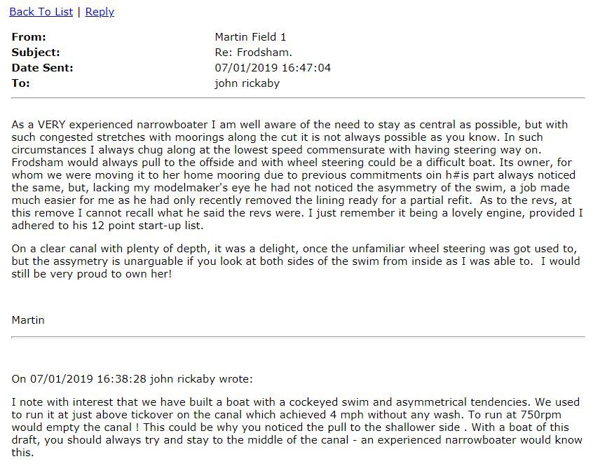

Hi Mike, I wonder where the 'missing' cylinders got to, they must have been up to no good in the engine room to produce a J4. Possible reasons for pulling to one side - prop walk, and the longer than average swim combined with the length of the rear deck overhang. The hydraulic hoses are Volvo and designed for the Volvo tipper trucks, they were provided by Uncle Paul who owned Reliance Tankers of Runcorn at the time and ran a fleet of trucks - the truck racing at Donington was great! Cheers, Pat. p.s. what is your new engine?
