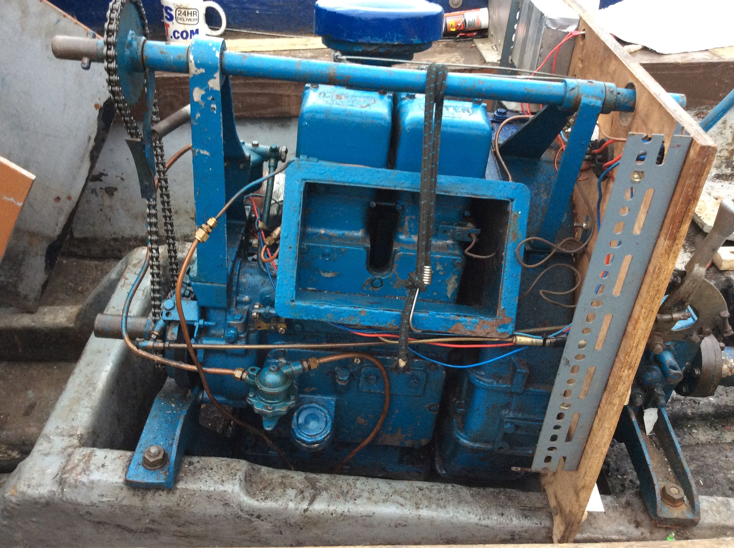

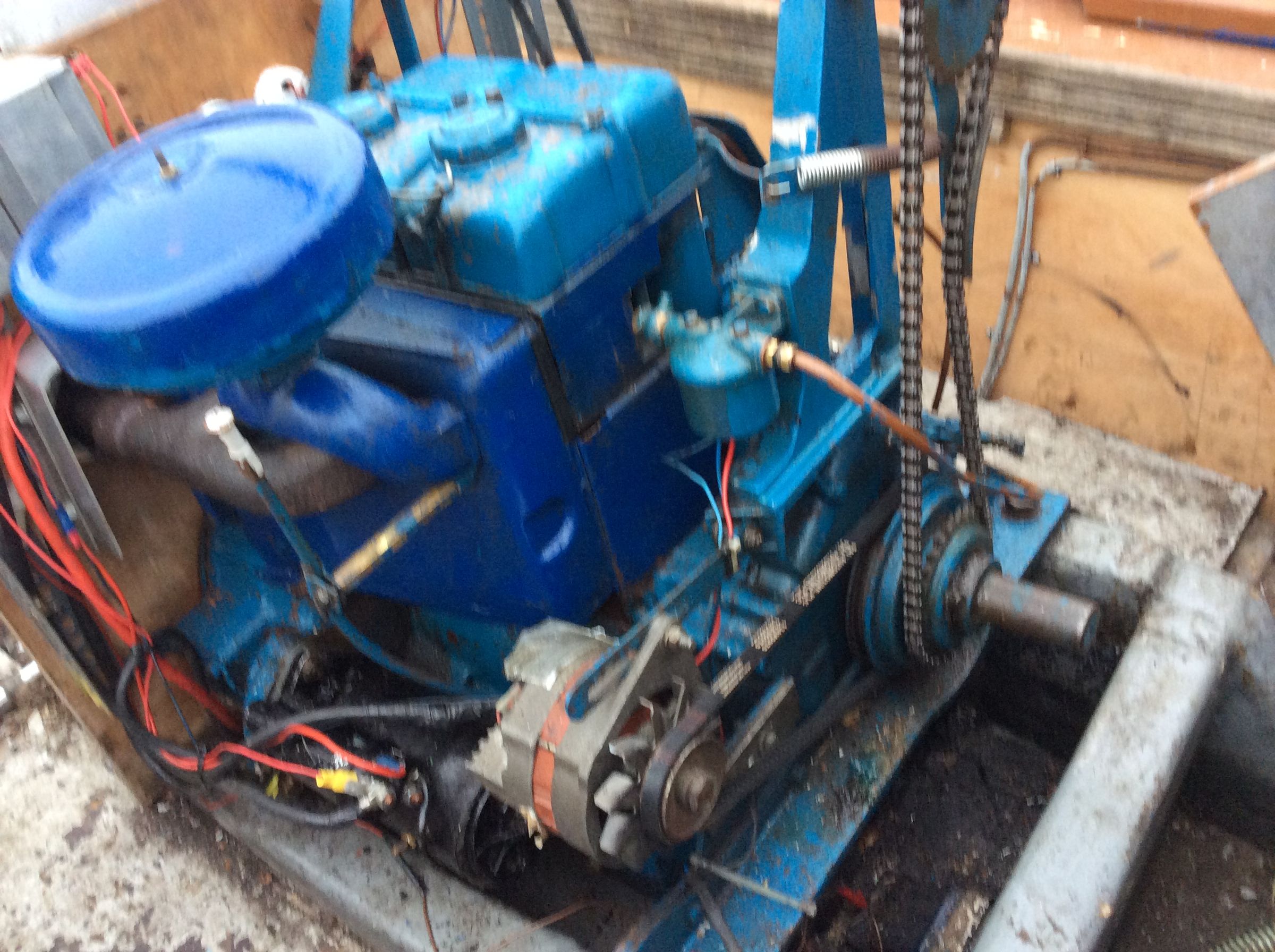

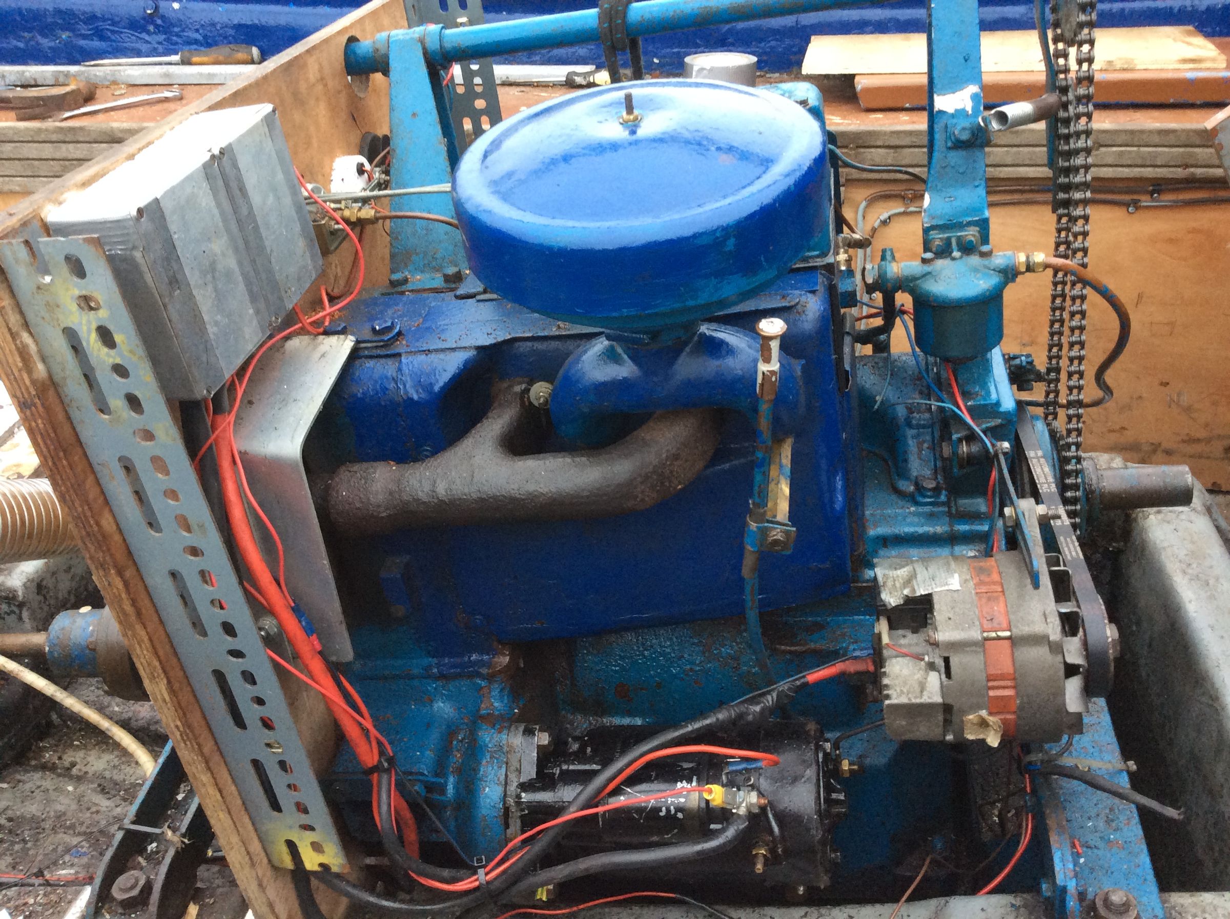

Roxylass Posted December 9, 2018 Report Share Posted December 9, 2018 Started the engine today sr2 to see if there was good voltage in the battery plenty power to fire her up noticed just above idling a knocking or slapping coming from cyl no 2 gave it some revs could still hear it no excess smoke coming from the exhaust checked the mountings engine firmly bolted down checked oil reading top mark on the dipstick all information greatfully appreciated Link to comment Share on other sites More sharing options...
