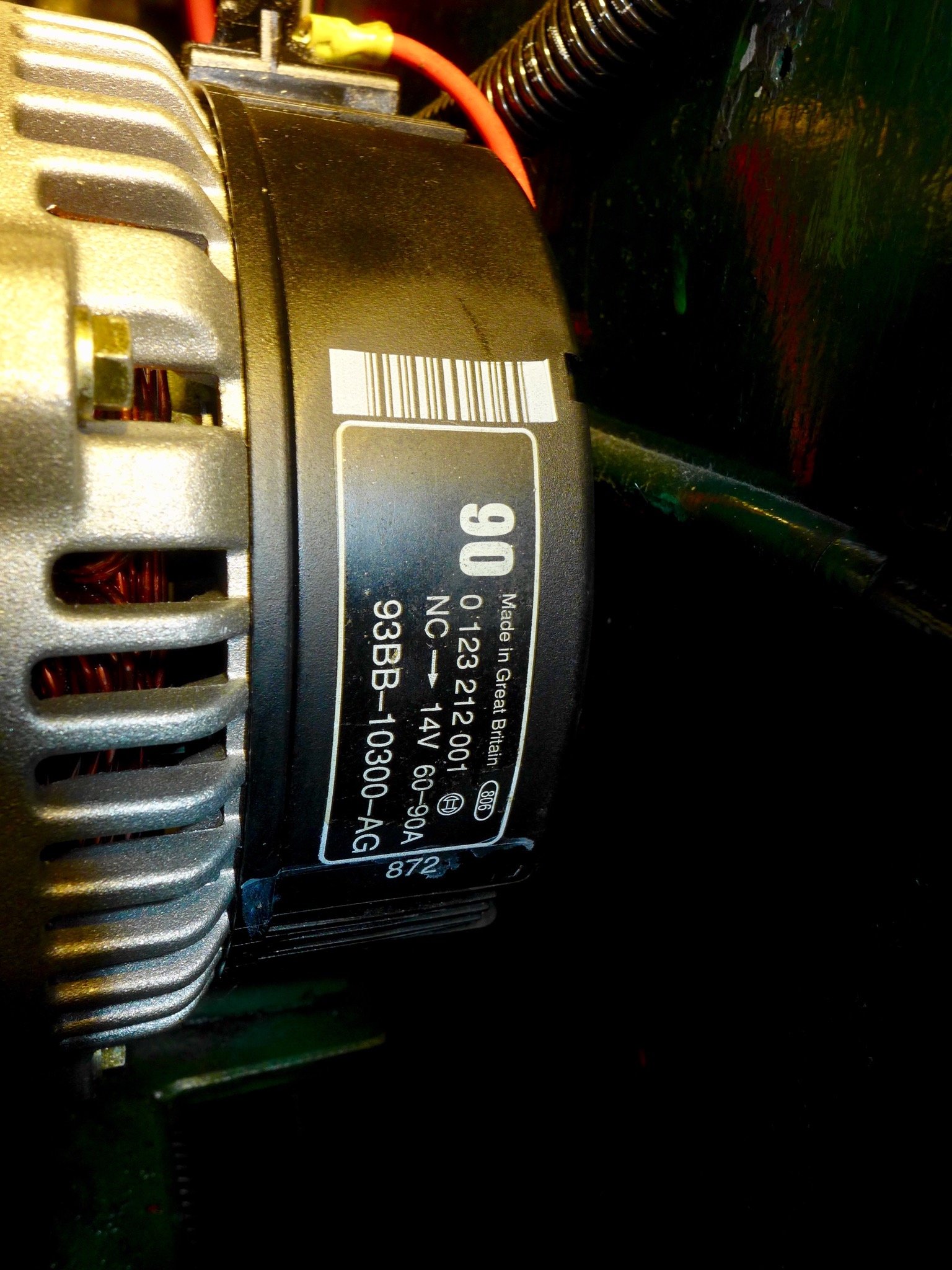

BEngo Posted November 24, 2018 Report Posted November 24, 2018 Could somebody tell me what this alternator is please? I know the output is a staggering 30 A or so but it only charges the start battery which is rarely used as I prefer to hand start. Thanks N

Alan de Enfield Posted November 24, 2018 Report Posted November 24, 2018 19 minutes ago, Sir Nibble said: Definitely Bosch. Jerry-built then. 1
BEngo Posted November 25, 2018 Author Report Posted November 25, 2018 Thank you. I would like to see if I can a. Find a spare and b. Get a fan for it. N
bizzard Posted November 25, 2018 Report Posted November 25, 2018 1 hour ago, BEngo said: Thank you. I would like to see if I can a. Find a spare and b. Get a fan for it. N It might have an internal fan, Snibs will know. However start up and hold a smoking Joss stick at the back of it, if it has a fan the smoke will be drawn in and exit at the pulley end. Choose a nice aromatic one like Jasmine.

Sir Nibble Posted November 26, 2018 Report Posted November 26, 2018 External fan. Just about any fan for 17mm shaft will do. If you can post a picture showing the mountings I may be able to identify a replacement.

gbclive Posted November 26, 2018 Report Posted November 26, 2018 1 hour ago, Sir Nibble said: External fan. Just about any fan for 17mm shaft will do. If you can post a picture showing the mountings I may be able to identify a replacement. Just a thought Nigel - I had to replace the alternator on my Kelvin a while back. My first “economy” attempt was unsuccessful as the alternator is mounted backwards compared to a typical car situation, so the fan ran backwards ? It was also very noisy due to the fan being an external type - a horid whine could be heard between the ”chugs” of the J2 ☹️ The solution was to fit a much more expensive Boshe type alternator that had a dual-directional internal fan which is effectively silent. A couple of pics attached in case they help. 1
Sir Nibble Posted November 26, 2018 Report Posted November 26, 2018 Many of the internal fans are directional.

BEngo Posted November 26, 2018 Author Report Posted November 26, 2018 2 hours ago, Sir Nibble said: External fan. Just about any fan for 17mm shaft will do. If you can post a picture showing the mountings I may be able to identify a replacement. Thanks. I have a spare A127 fan so can try that. Mounting pics may be more of a challenge but I will try next time we are aboard. I know it is a left handed adjuster (from the rear) and the main mounts are onto an H frame I fabricated and which is welded to the floor. For Boater Sam. I had thought of running it off a gear to the starter ring but lubrication would be a problem as I dare not wear out the cast iron teeth on the flywheel. I also thought of a tyre on the drive pulley running on the flywheel rim, but have not found a suitable tyre/wheel. N
gbclive Posted November 26, 2018 Report Posted November 26, 2018 10 minutes ago, Sir Nibble said: Many of the internal fans are directional. Thanks for that info Sir Nibble. I was sold mine as being dual direction, but I’ve not been able to track down a data sheet. I’ll try Bizzards joss stick trick (advanced diagnostic procedure ?) to check. Do I understand correctly that the reason for the airflow intake being from the opposite end to the pulley is to reduce belt dust injestion?
Sir Nibble Posted November 26, 2018 Report Posted November 26, 2018 1 minute ago, gbclive said: Thanks for that info Sir Nibble. I was sold mine as being dual direction, but I’ve not been able to track down a data sheet. I’ll try Bizzards joss stick trick (advanced diagnostic procedure ?) to check. Do I understand correctly that the reason for the airflow intake being from the opposite end to the pulley is to reduce belt dust injestion? The reason for airflow being back to front is to favour the rectifier with first go at the cool air. An internal fan machine tends to have a fan at each end discharging radially
gbclive Posted November 26, 2018 Report Posted November 26, 2018 5 minutes ago, Sir Nibble said: The reason for airflow being back to front is to favour the rectifier with first go at the cool air. An internal fan machine tends to have a fan at each end discharging radially That’s very interesting - Thankyou
