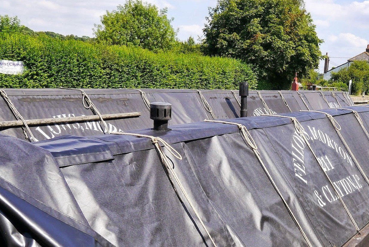

Ex Brummie Posted November 13, 2017 Report Posted November 13, 2017 My Bubble runs quite happily with a 4" S/Steel flue pipe inside a normal boat chimney. This 'double skinning' helps the draught as it keeps the flue warm for its whole length. Attached to the top of the S/Steel pipe is a Swedish cowl, which has a skirt around the cap on the top. This eliminates down-draught in all but the strongest wind. Y our bubble incorporates a draught stabiliser as shown in K K's lower picture. The Swedish cowl looks very similar to the rearmost example in his first picture.

Bro Posted November 14, 2017 Author Report Posted November 14, 2017 19 hours ago, Ex Brummie said: My Bubble runs quite happily with a 4" S/Steel flue pipe inside a normal boat chimney. This 'double skinning' helps the draught as it keeps the flue warm for its whole length. Attached to the top of the S/Steel pipe is a Swedish cowl, which has a skirt around the cap on the top. This eliminates down-draught in all but the strongest wind. Y our bubble incorporates a draught stabiliser as shown in K K's lower picture. The Swedish cowl looks very similar to the rearmost example in his first picture. Thanks Brummie. My chimney is double skinned but for sure it doesn't have KK's draught stabiliser (wish it did). I can find several designs for "Swedish" cowls (some even feature a divergent-convergent cone body). Does the one you use have side slots in the body (same as KK's pic's)? 19 hours ago, charleec said: i just thought i'd mention that i have one of the cowls in koukouvagia's picture for sale, the one on the left, my boat came with it without the heater. Looks like KK beat me to it!
Ex Brummie Posted November 14, 2017 Report Posted November 14, 2017 No slots in the skirt. Only the top and bottom are open.
