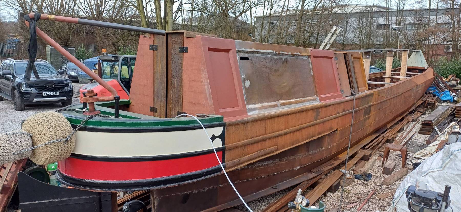

i certianly will. not much done today, a splash of primer and a couple of other bits...
How are you preparing that steel before priming?
Welding it...
  • Author
with an awful lot of elbow grease, linishing, sanding, and more of that, back to bare steel. The reason we didn't prime it to start with is we wanted the millscale to rust off, which is pretty much doing. still a lot of work to get back to bare steel but if we'd have paid for blasted and primed, it would have been rusty by now due to other work commitments.
To add.... the large panel absolutely hasn't been prepped yet!

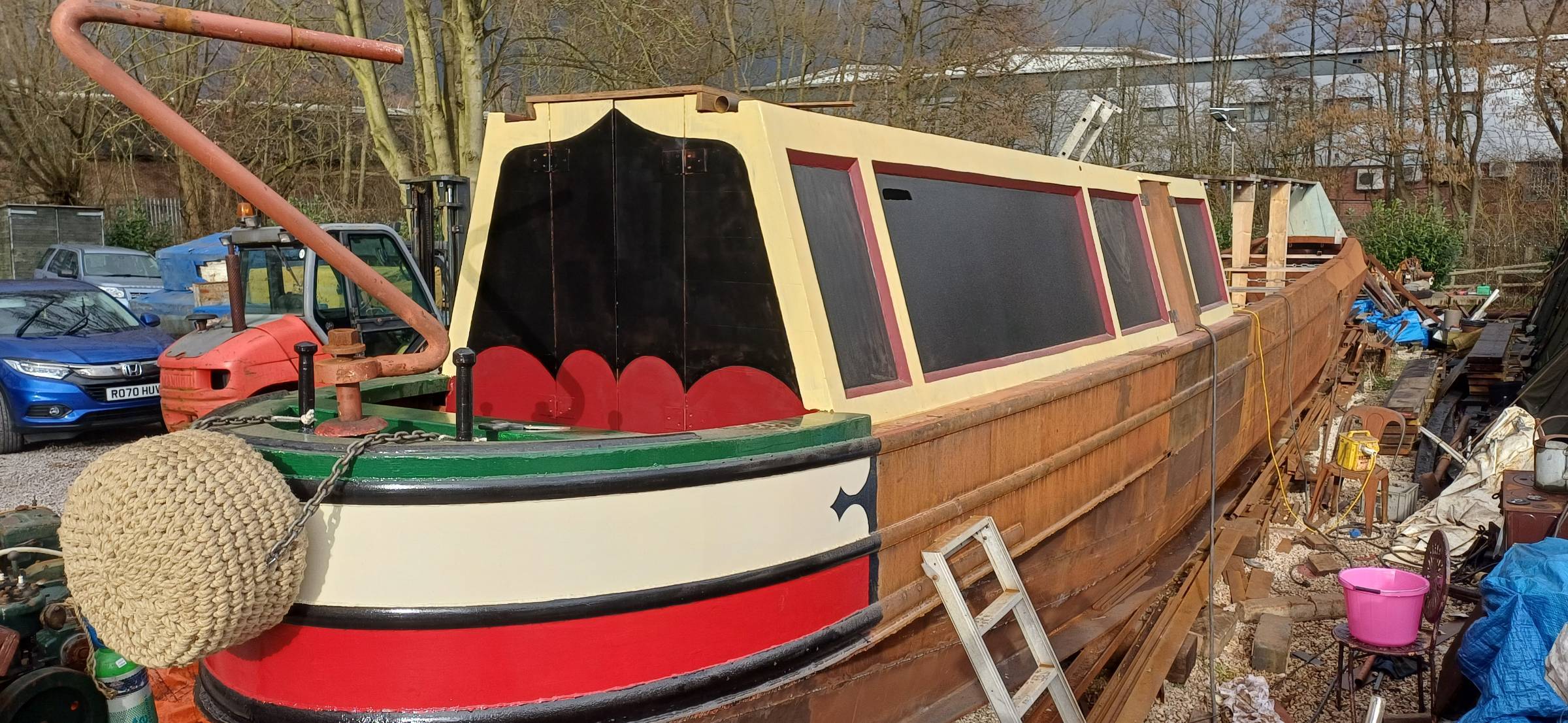

a bit more colour today, 1st layer of Undercoat is on one side, more linishing of the cabin tomorrow whilst the sun is out!
That's a damn fine boat!
  • Author
thanks Bee, i'm quite fond of her too!! the other side has been primed today, the weather isn't great for the rest of the week and i'm moving Hamilton to Southampton next week, but the week after is looking nice so maybe some gloss work might find its way on.....

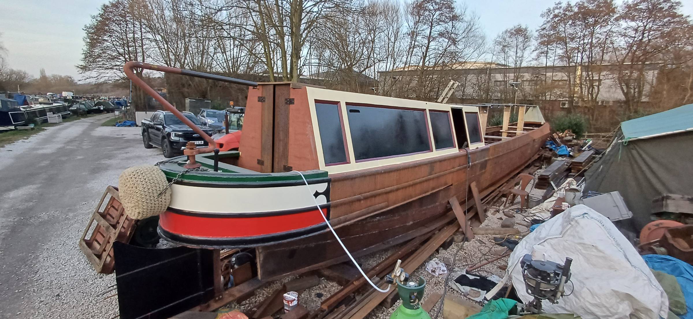

  • Author
this'll do for a bit, cabin sides and rear bulkhead undercoated with their first coat, and here's a comparison of paint styles nearly 100 years apart, with this rear bulkhead style only seen on those with drop counters. I guess its nice to bring back old styles not seen for years.....
