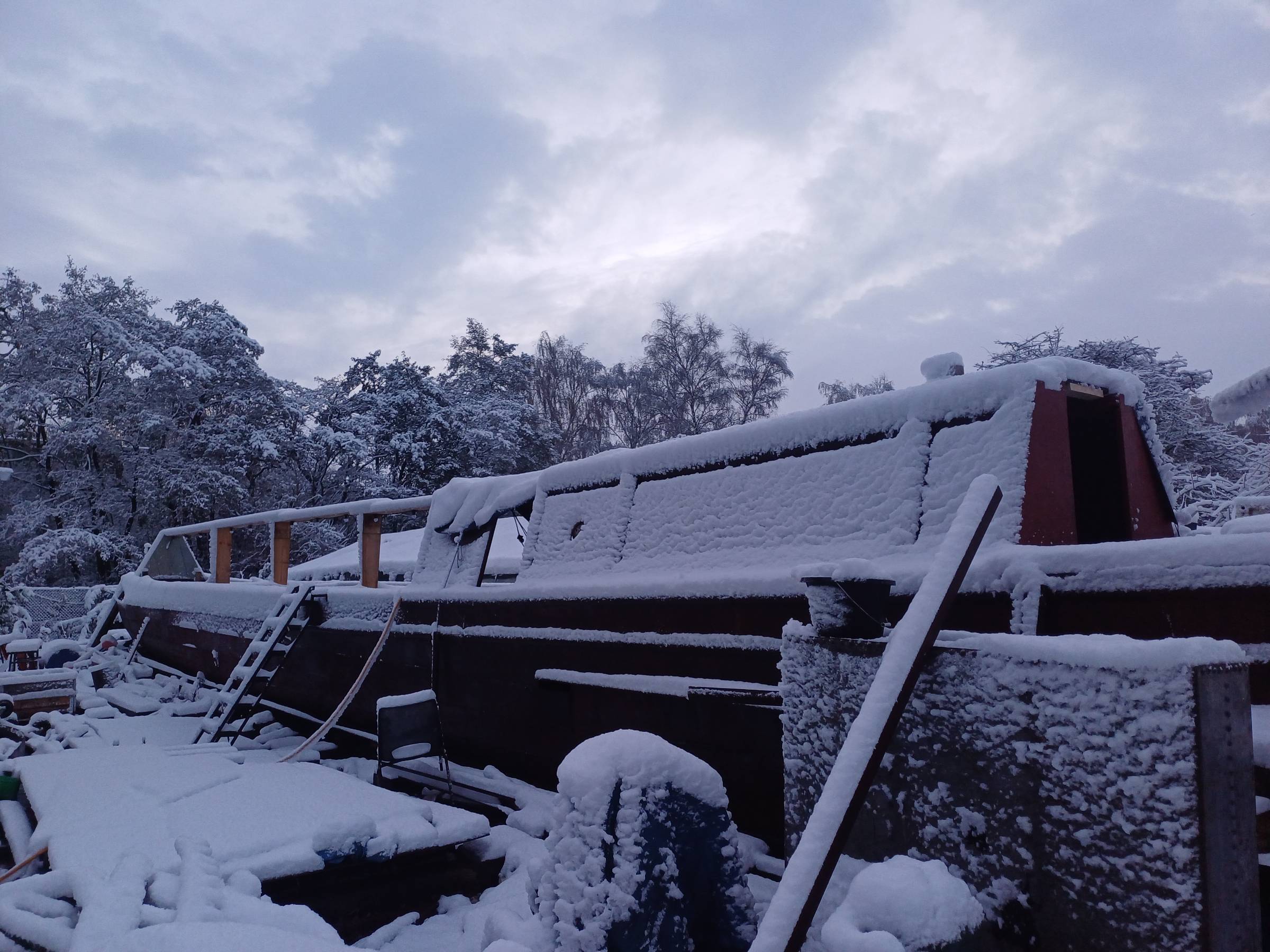

4 hours ago, jacko264 said:
Slow and steady is the way to go  looking good  👍 jobs like this get hard in this weather cold and wet
G
absolutely..... a week between welds should give it time for the heat to dissipate........🤣🤣

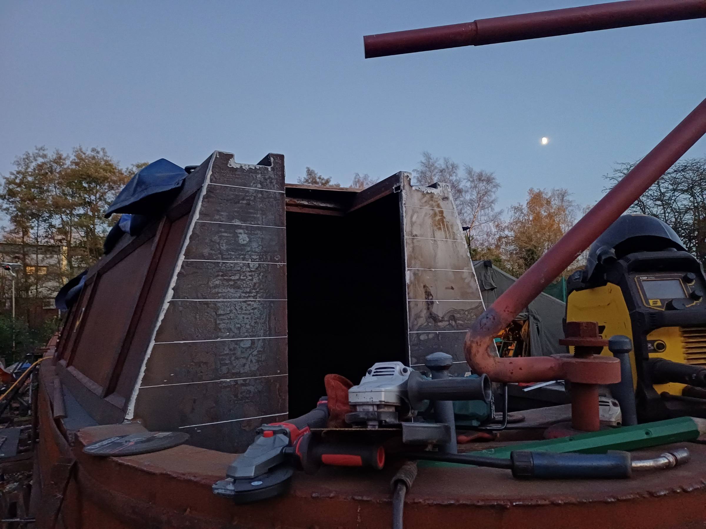

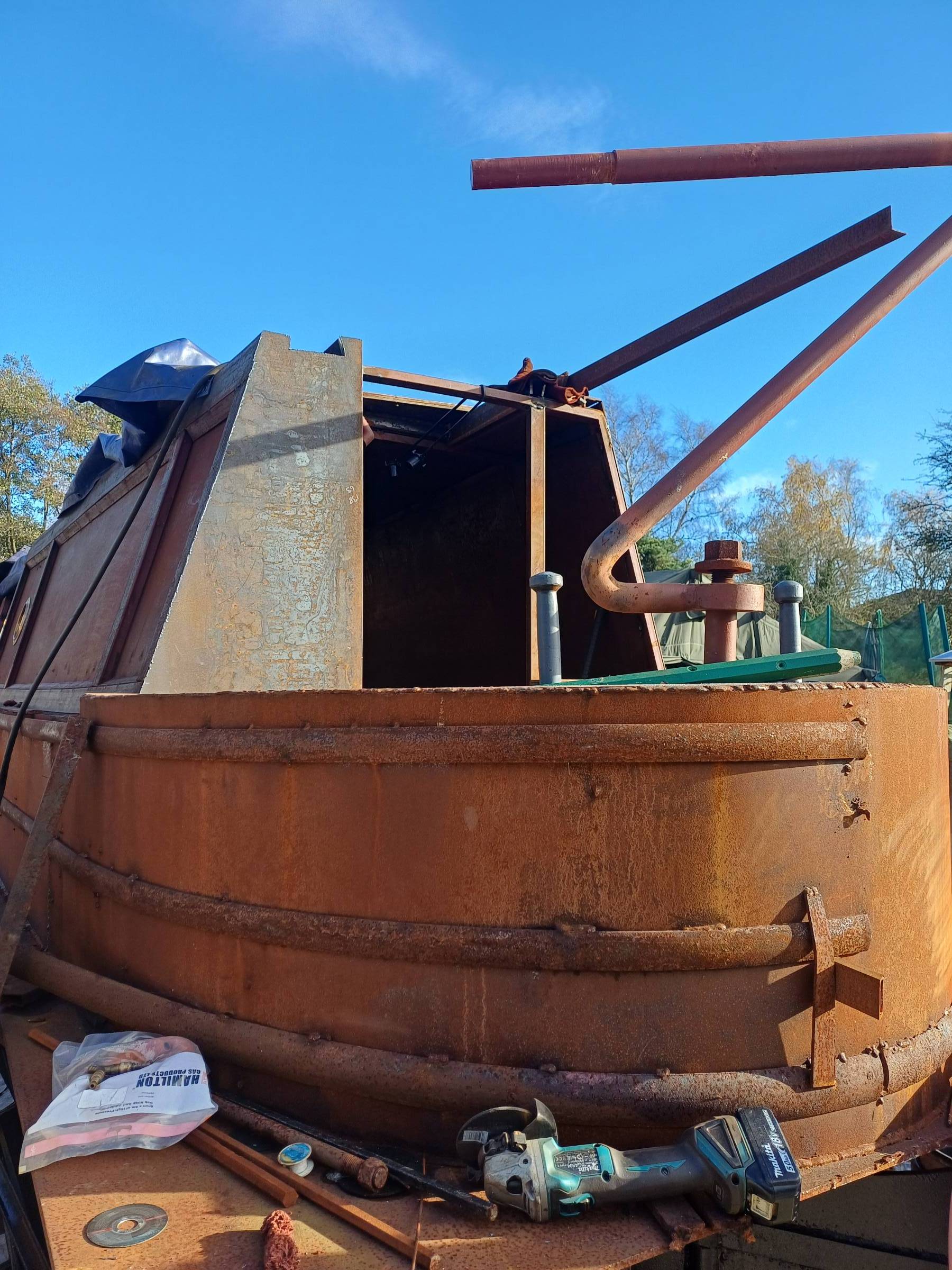

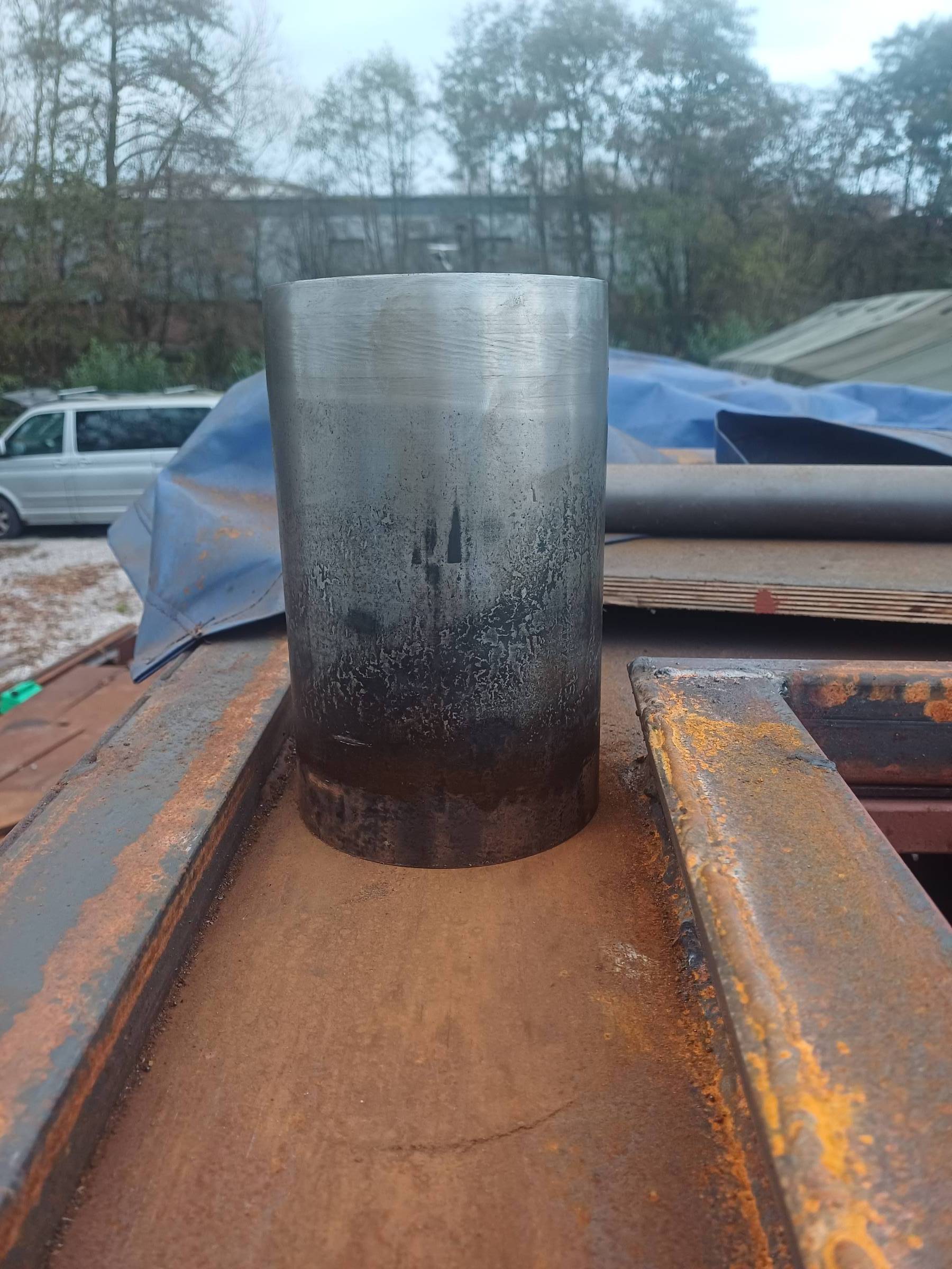

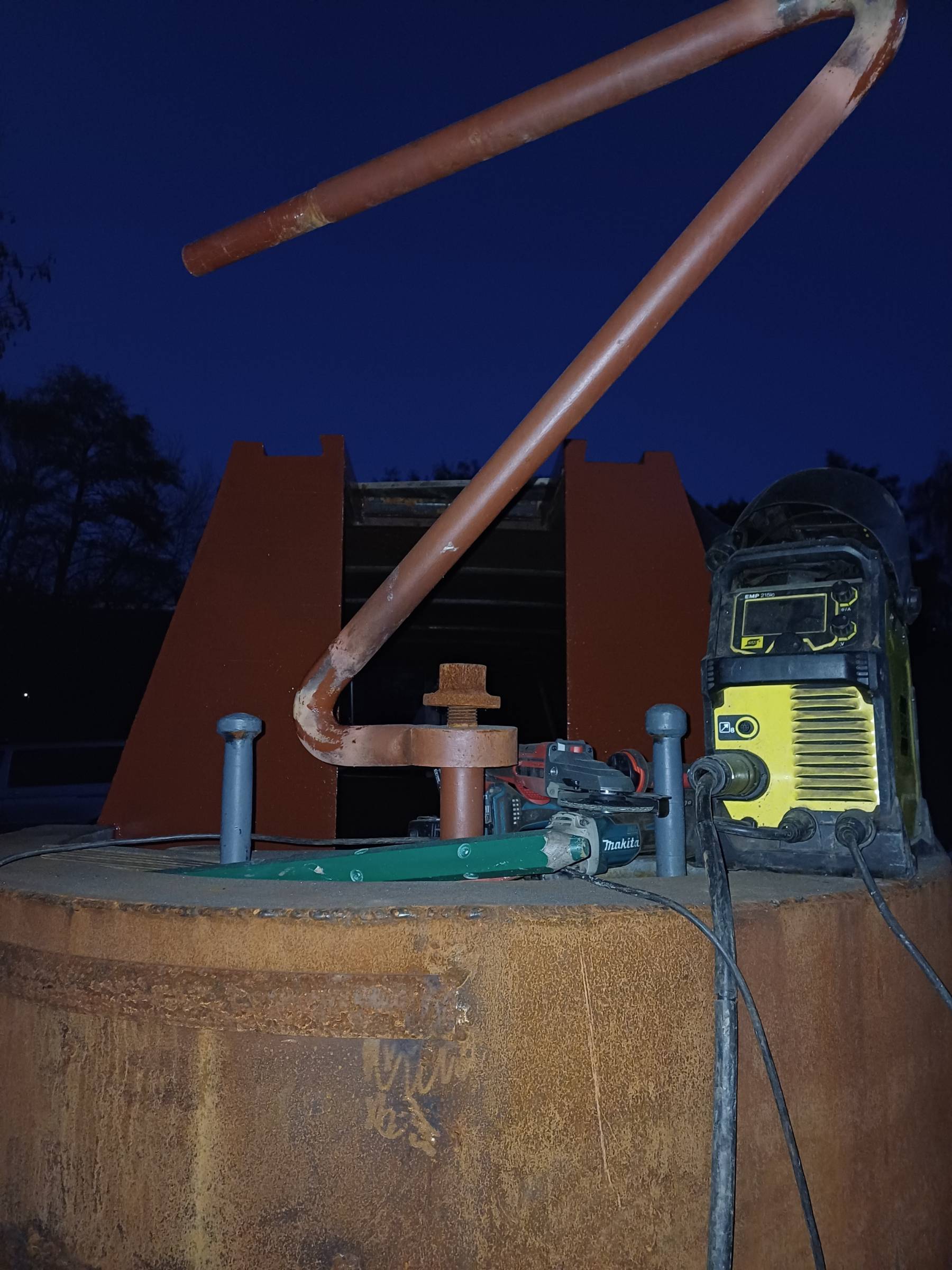

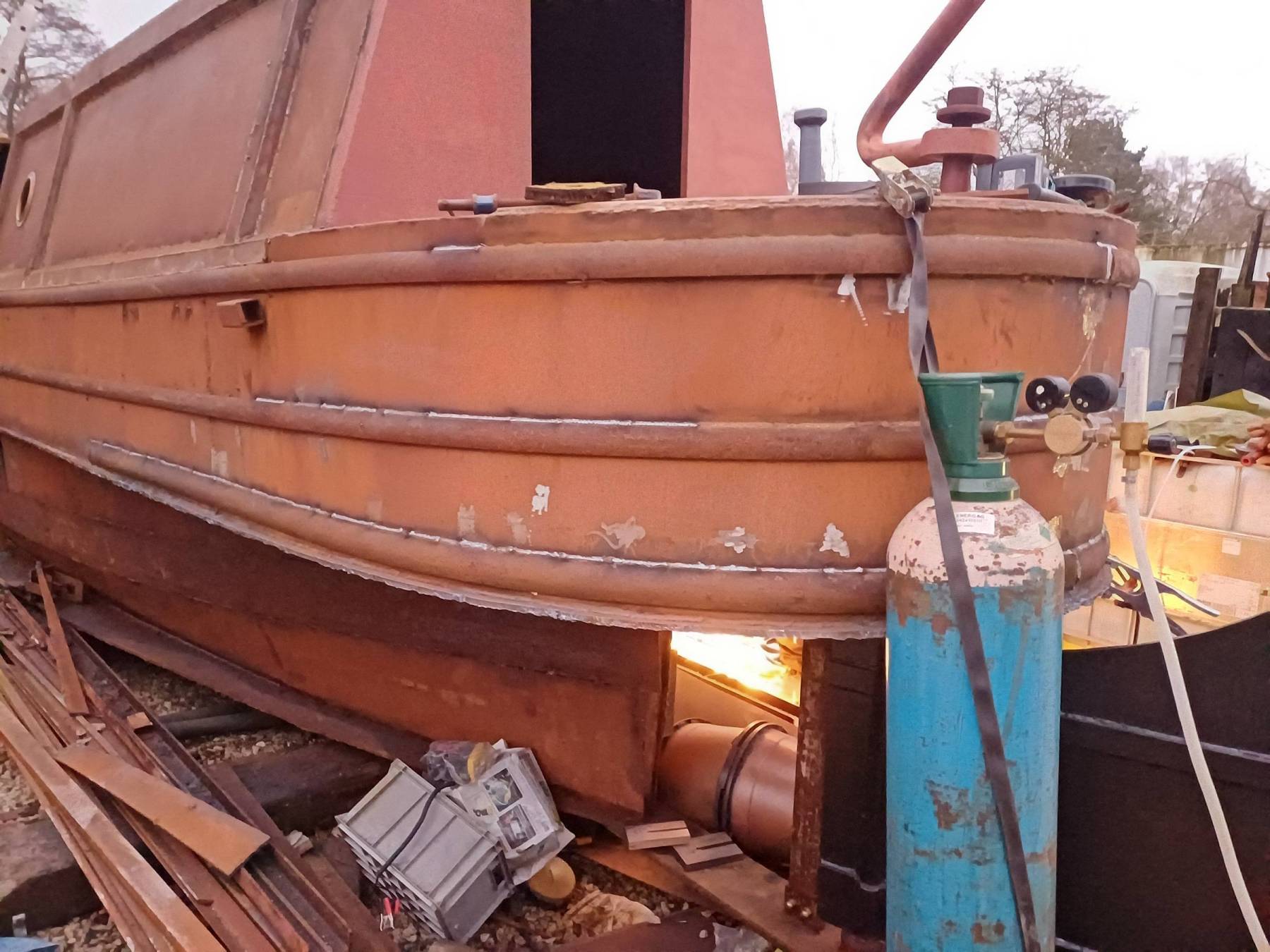

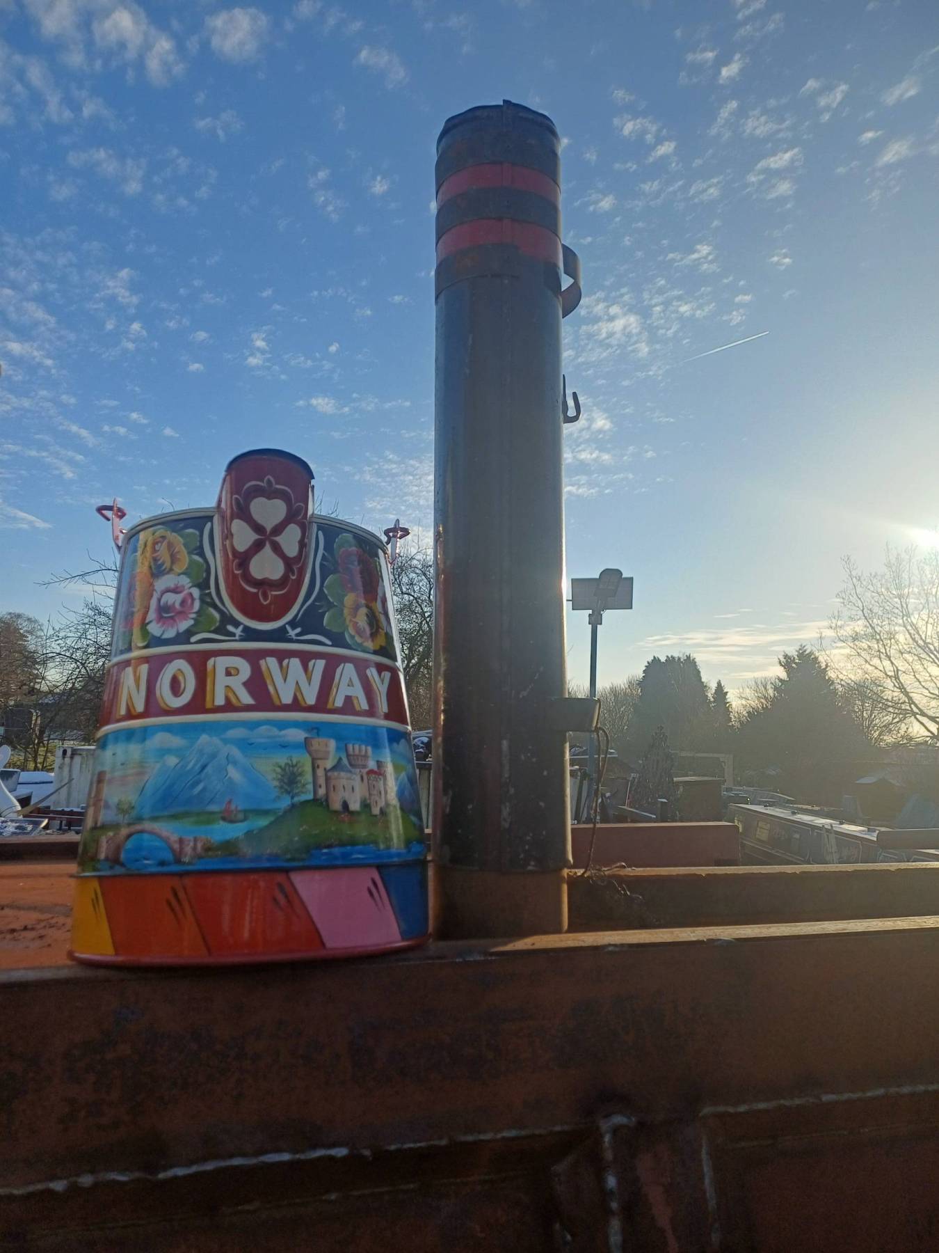

so here's a thing........ Anderton boats are renowned for their steep tumblehome on the cabin sides. When Norway was built she was built without gunwhales, which leads us to the issue of what is more important, gunwhales or a wider cabin top. obviously, we opted for gunwhales, this is the only compromise i was willing to accept. Given the dimensions in the Anderton Notebook this makes for a narrow cabin doors bulkhead, and the knock on for a chimney collar. We knew this would be very tight, a 6" collar is a non starter, a 4 1/2" chimney would look wrong, and therefore we opted for a 5" one. We still can't fit a full collar in, so will be welding in a 5" pipe through the cabin top, with a 1 degree turned taper so at least it looks like a collar. This will be sleeved inside the cabin so it resembles a 6" collar. Because of the this the slide runners will be slightly narrower, but overall, I think we will manage to fit it all in just about!

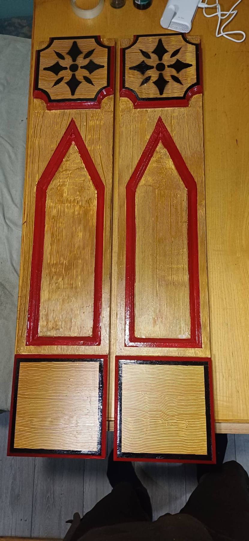

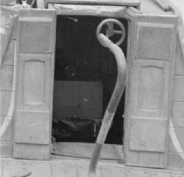

I like those! Different from the usual layout. Is that a documented Anderton style, or just something you have come up with?
I am about to do the back cabin doors for Belfast, and I am minded to do them like those shown on this 1944 photo, almost certainly of Belfast - pads set up from the bottom and down from the top, and with stopped chamfers on the central panels rather than the usual mouldings all round. (I'll still have scumbling, roses and castles though).
Hi David, they are a documented Anderton style, there were quite a few different ones, we have one photo of an unknown Anderton motor with a drop counter showing this style of door so thats what we went with! I think it's important to show off these different styles and bring history back to life a bit, and, photos don't lie!!
