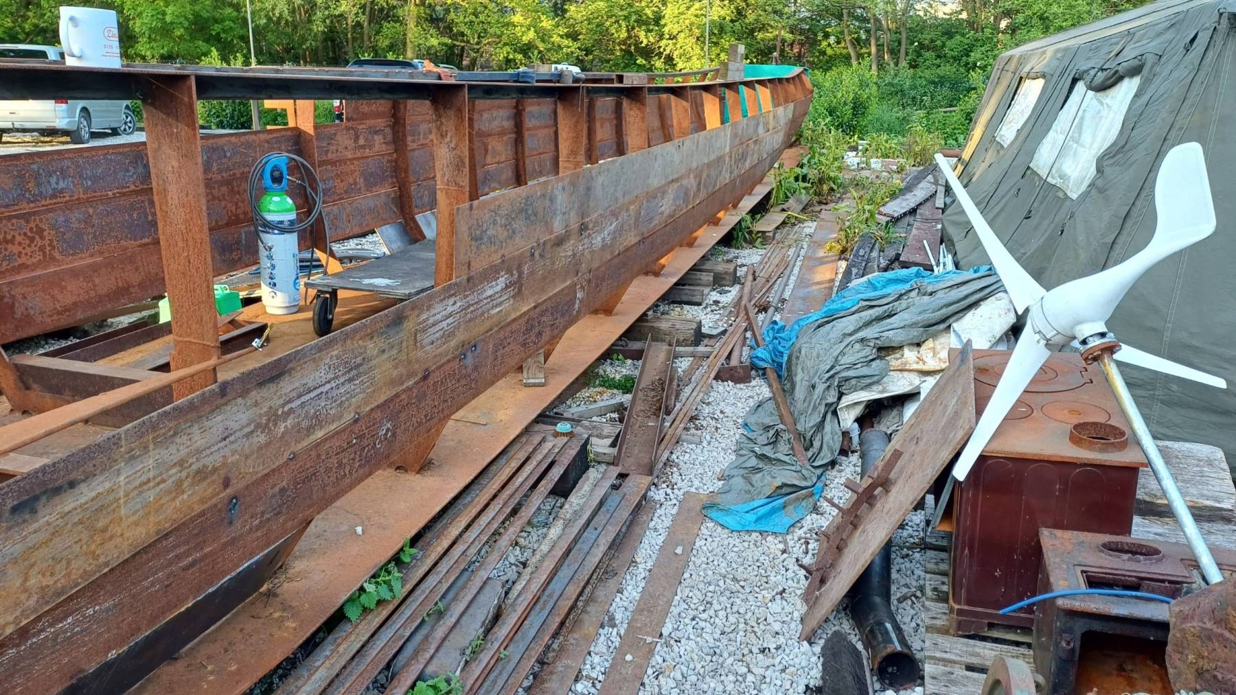

Thanks for your kind words Graham, we're using a combination of mig and stick, weather dependent obviously, we plan to use 7024 iron powders on the outer chine weld, where we can we will mig but i've also got a load of 4mm rods which will be used in places. The tricky bit will be reducing heat deflection, but we have a plan for that.......
All that sounds good to me ,
And  of course  running welds can be used to your  advantage  with   Bends in the plate
G
Edited by jacko264
Spelling
Not much from today, other than a section of chine plank and a rather nice twisty chine plank running into the stern post. That will be it for a few days, Hamilton moves from Edinburgh to Bristol this weekend so it's back to theatre for a bit!

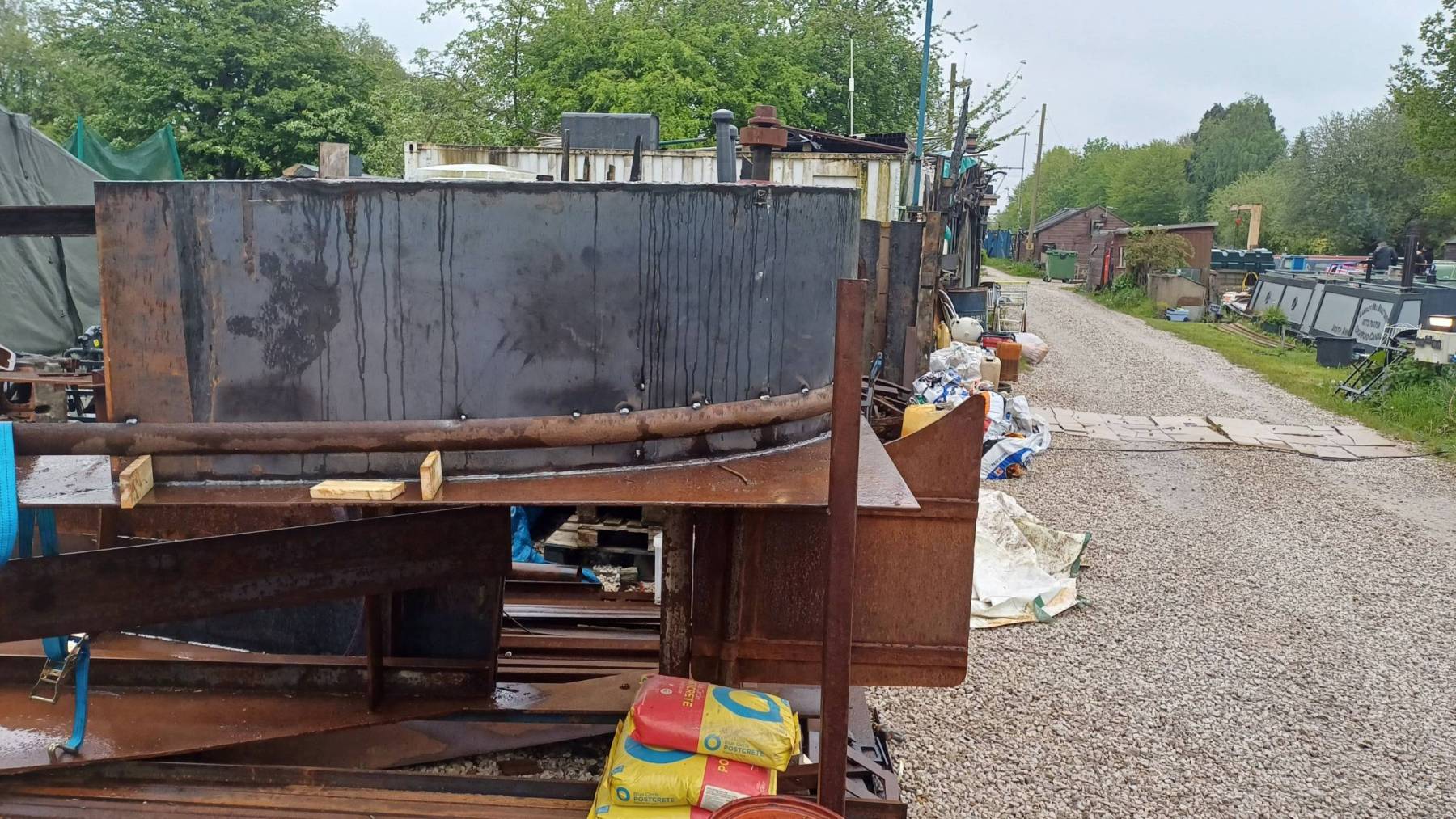

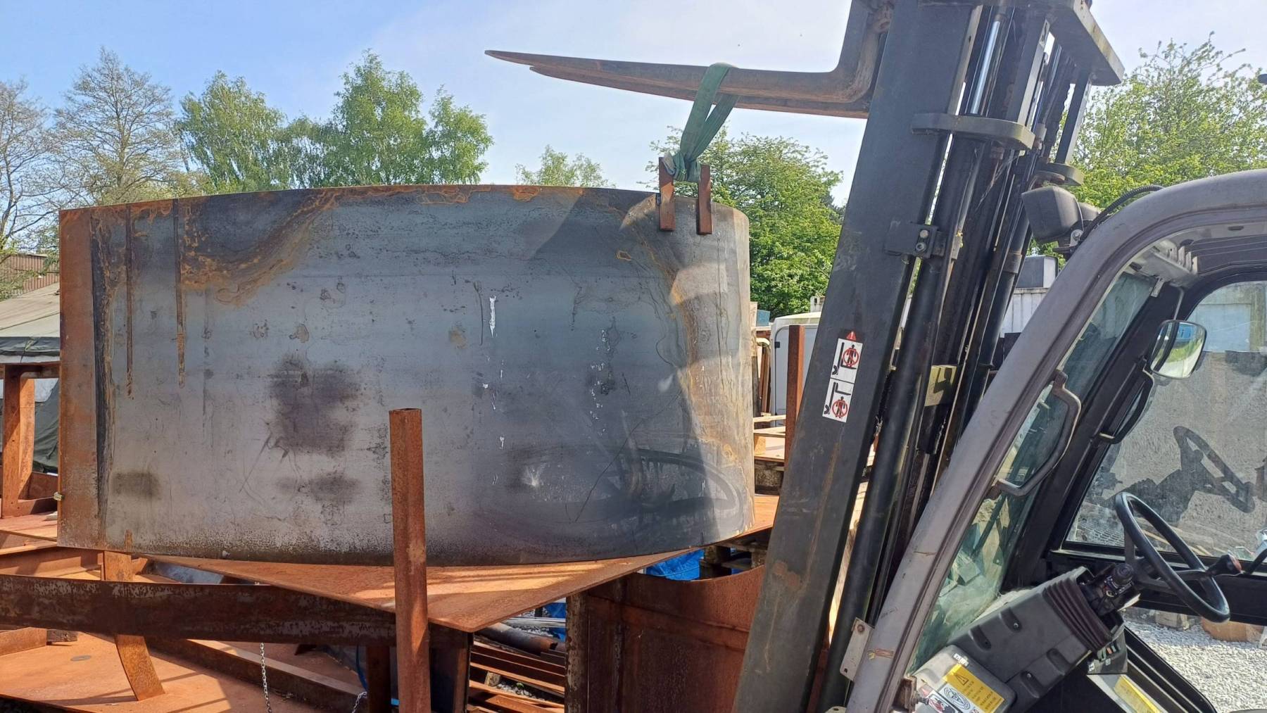

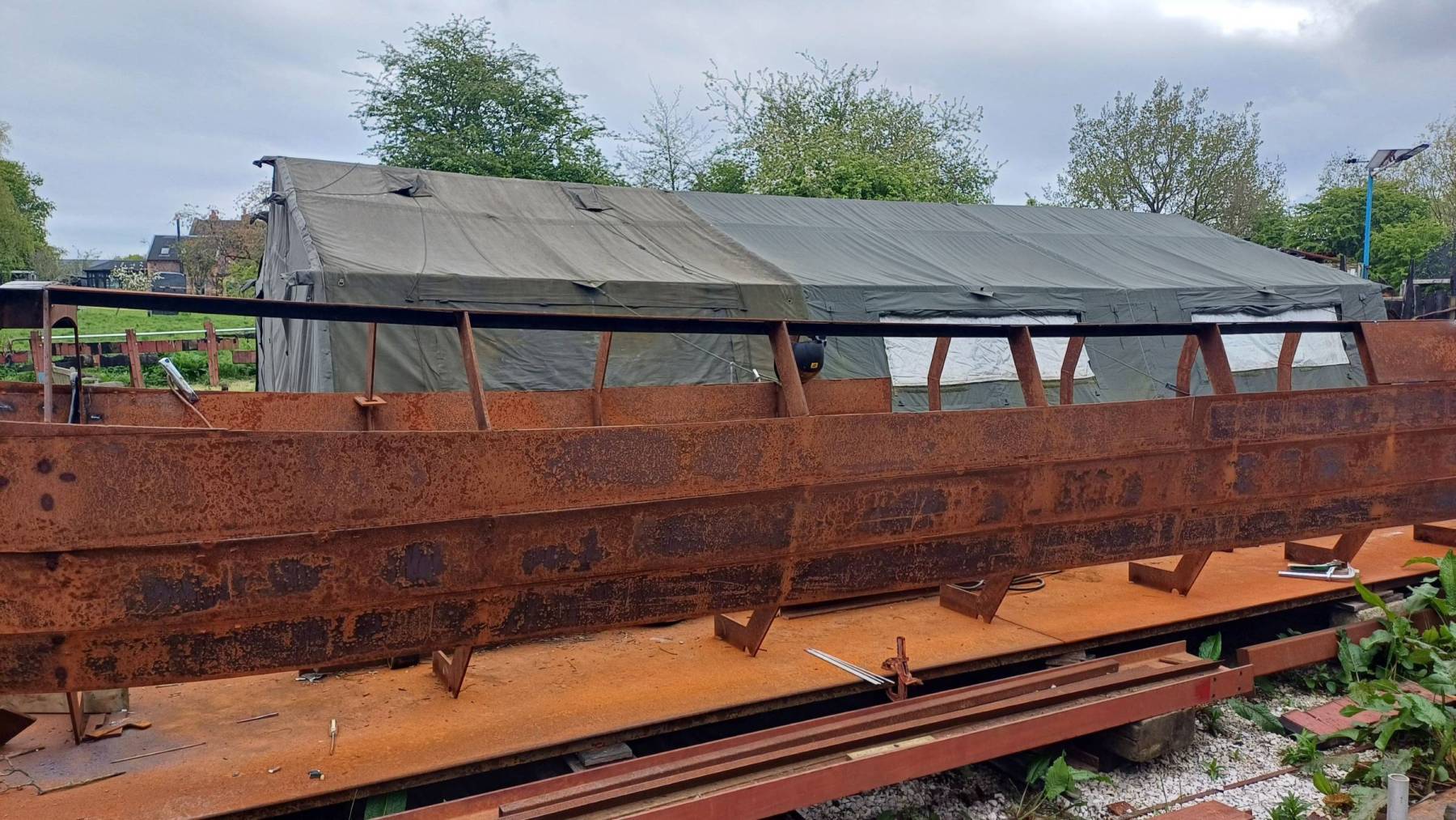

Onwards and upwards, we had a few quiter, sunny days at the yard so decided to get on with a few more bits of steel , the second chine plank at the stern has gone in and we have also got the counter on, as well as a length of 3" guard iron, which was donated by a local boater. We are once again, battling the gaps in the weather to complete further templates etc as its all just a bit too wet!

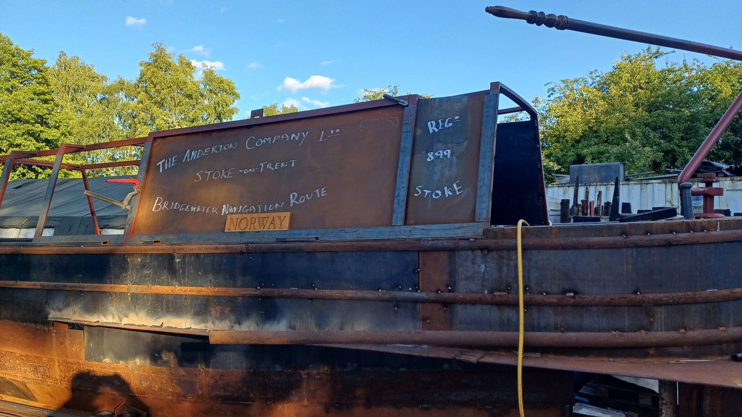

I see you've spaced the guard iron up from the counter plate. On the riveted boats I am used to the guard sits along the bottom edge, with rivets through the guard, counter round/side plating and the chine angle. But on reflection I guess that on wooden boats the guard would be located along the bottom of the side plank, and the transverse counter planks would be nailed on below. Is that the case?
Hi! yep, the guard was above the uxter plate when she was originally built, showing below.... the guards will ultimately be a bit different, as she originally didnt have any full length ones which i think she will need, so the middle one will probably end up running all the way up to the bow, whereas it was historically short.

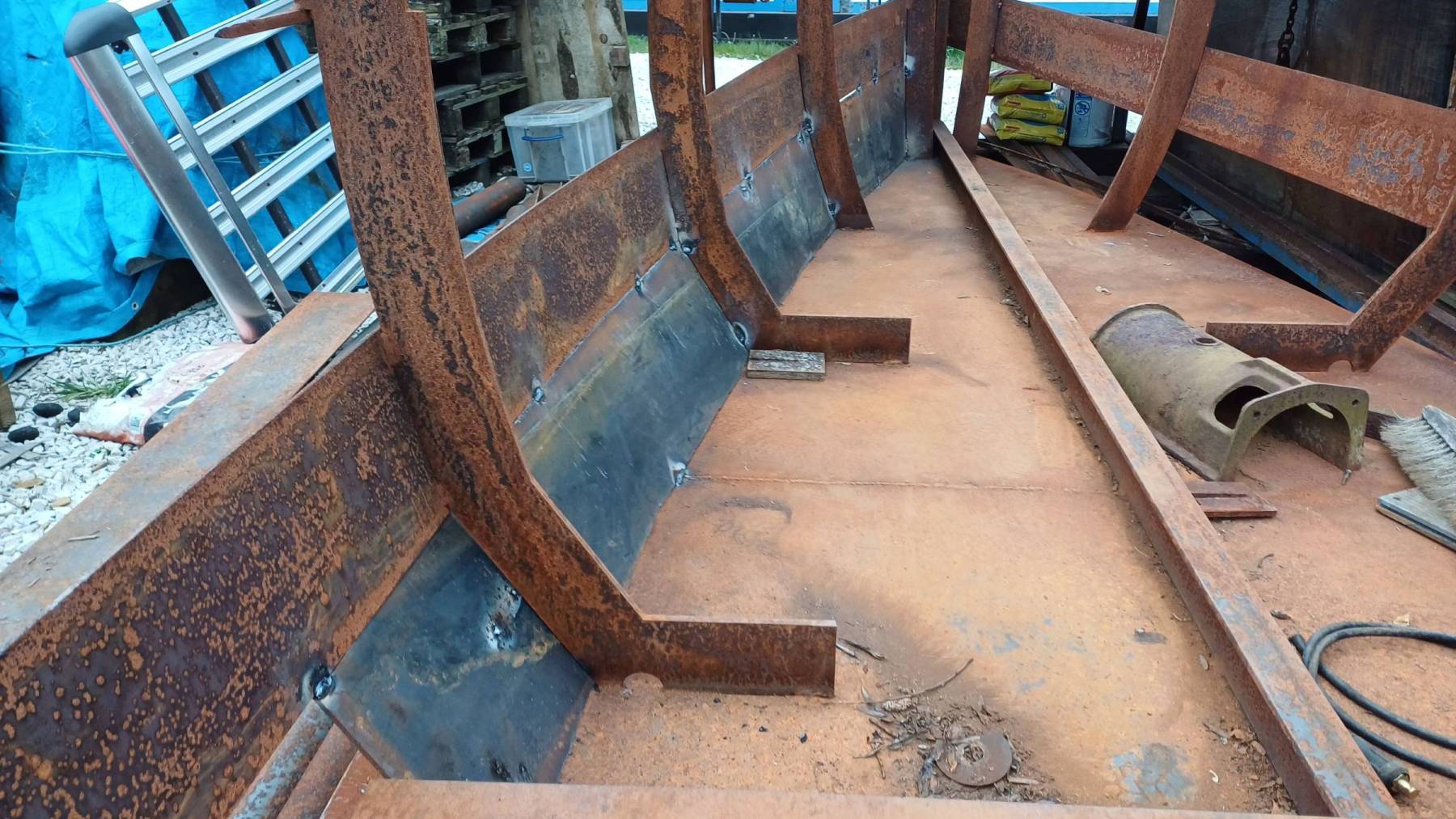

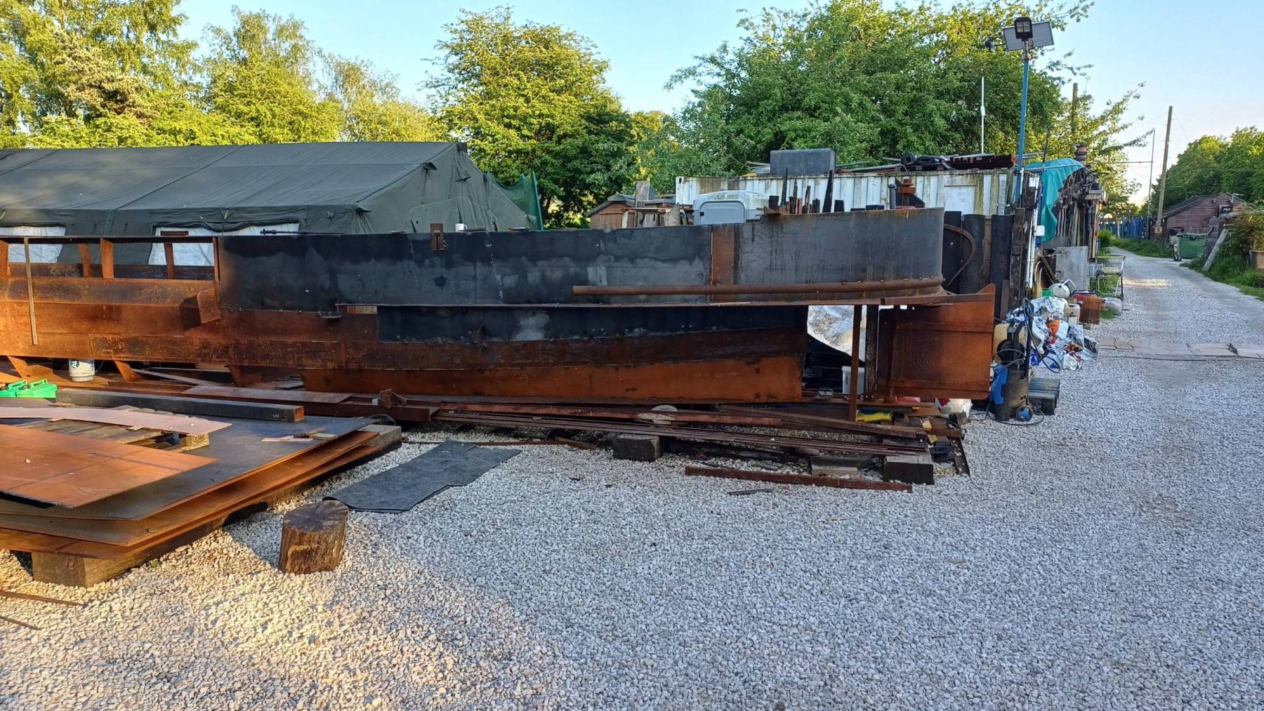

Just before the weather turned we managed to get one of the chine planks on running into the stem post which threw up a few issues with the knees, which I have got slightly wrong when i drew them. We've also had a steel delivery so we can start looking at sticking the cabin frames on to add some strength into the back end of the hull.......

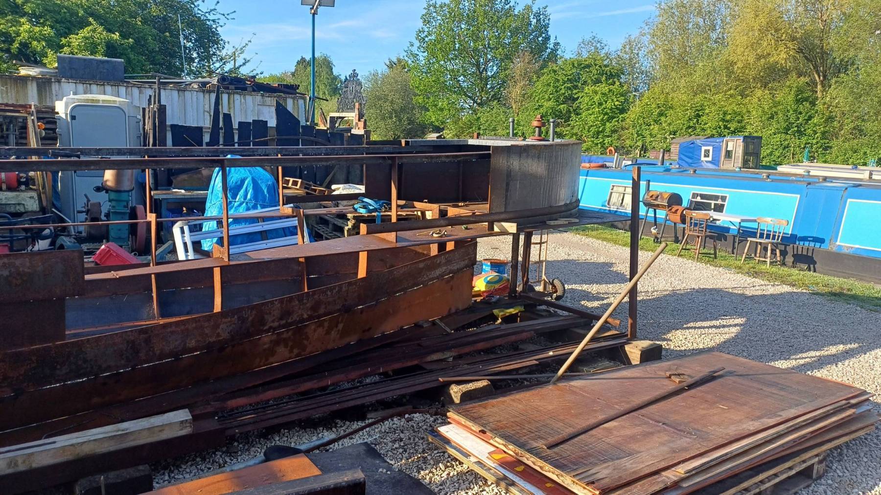

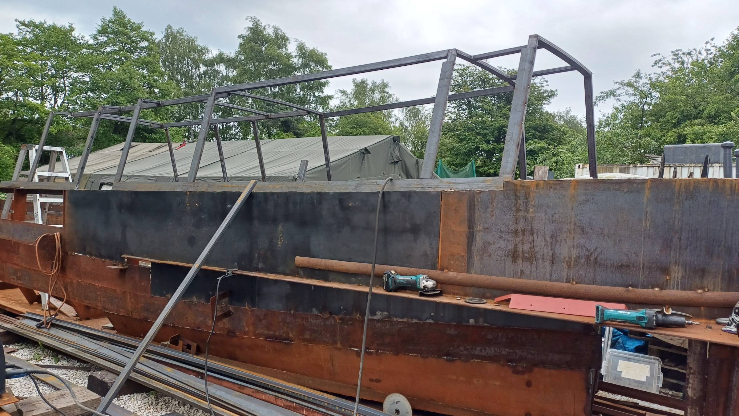

Anyone is more than welcome to swing by. The build is visible from a public footpath too. We've now done some cabin works and more hull planking will be done tomorrow weather dependent!
Thank you for your kind words. Everyone thought I was mad trying to replicate these boats in steel. We're not there yet but it's nice to know people can see what we are trying to achieve!

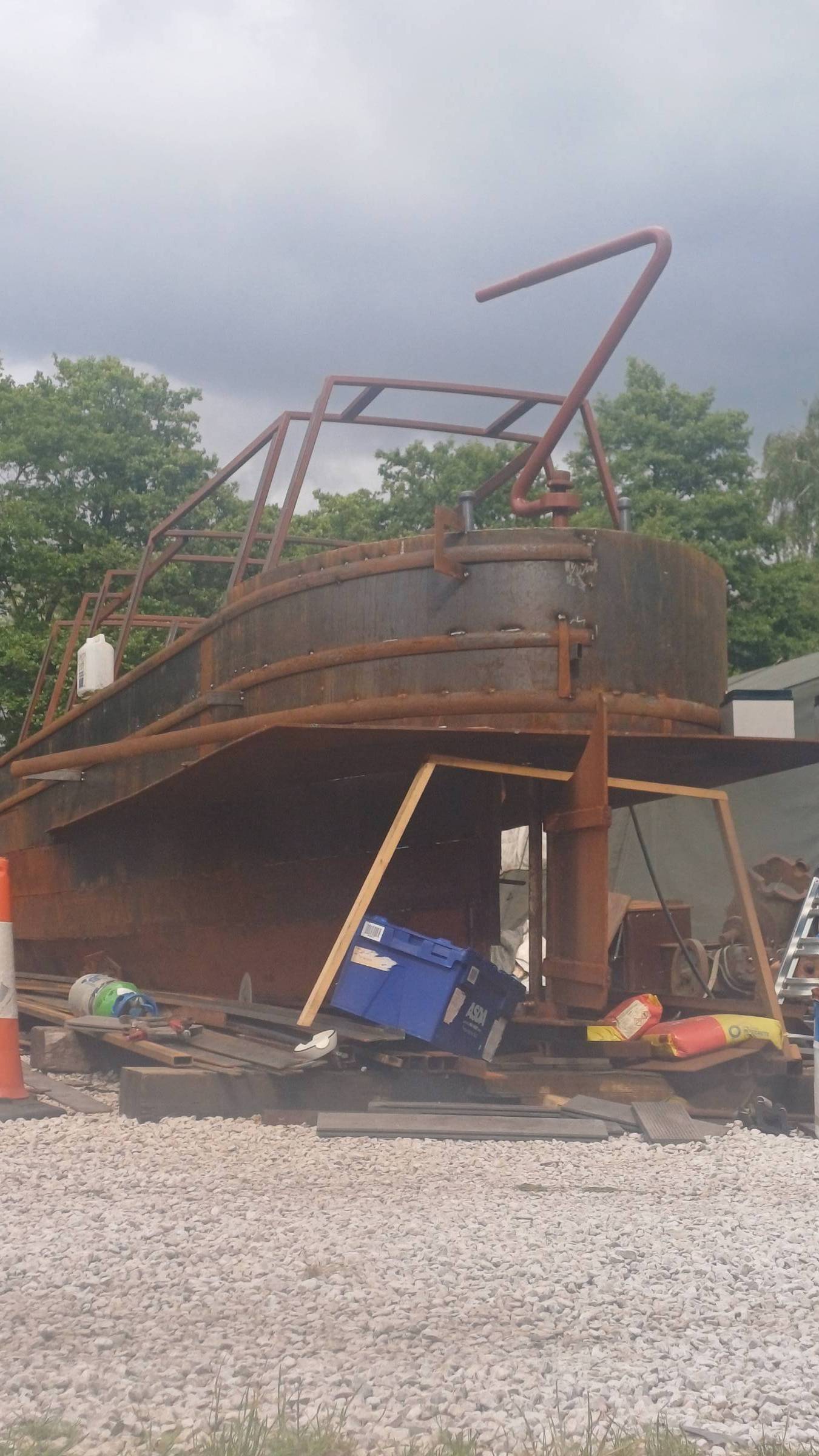

we did well. we had a lovely 1 day of summer and now we've been rained off again..... we did however make the Swans Neck/Ram's head/ Z iron *(delete as appropriate) which involved an awful lot of oxygen propane to bend the 50mm solid round bar to the right shape. it will need a final tweak to get the rake of it correct now it is fitted and welded to the boss. we've also got some counter guards on which is helping it look more boat like each day. we need to drop the lower guard, originally it sat above the uxter plate, but the positioning looks wrong in this configuration as we want to put a guard all the way round, which she originally never had.
