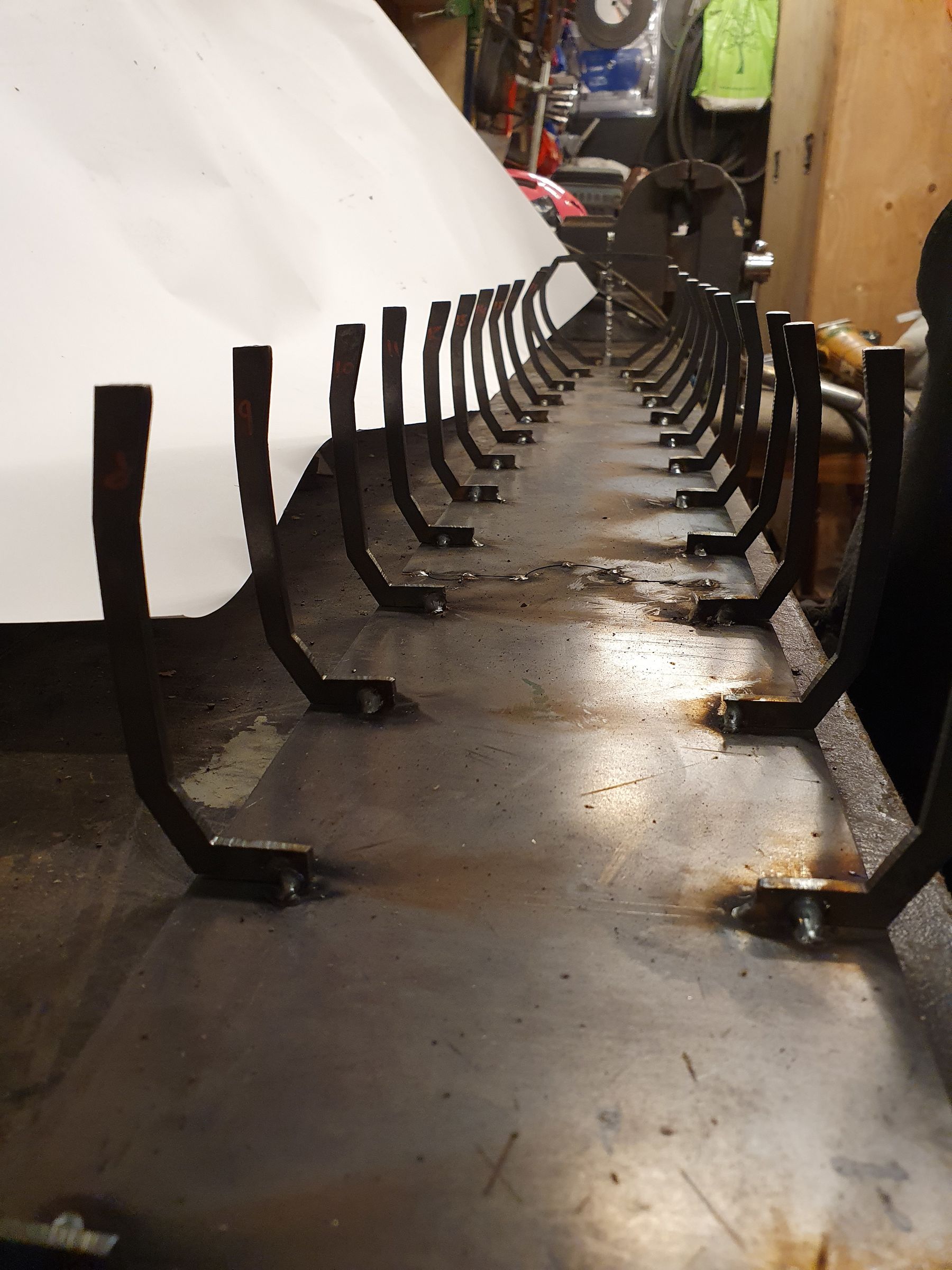

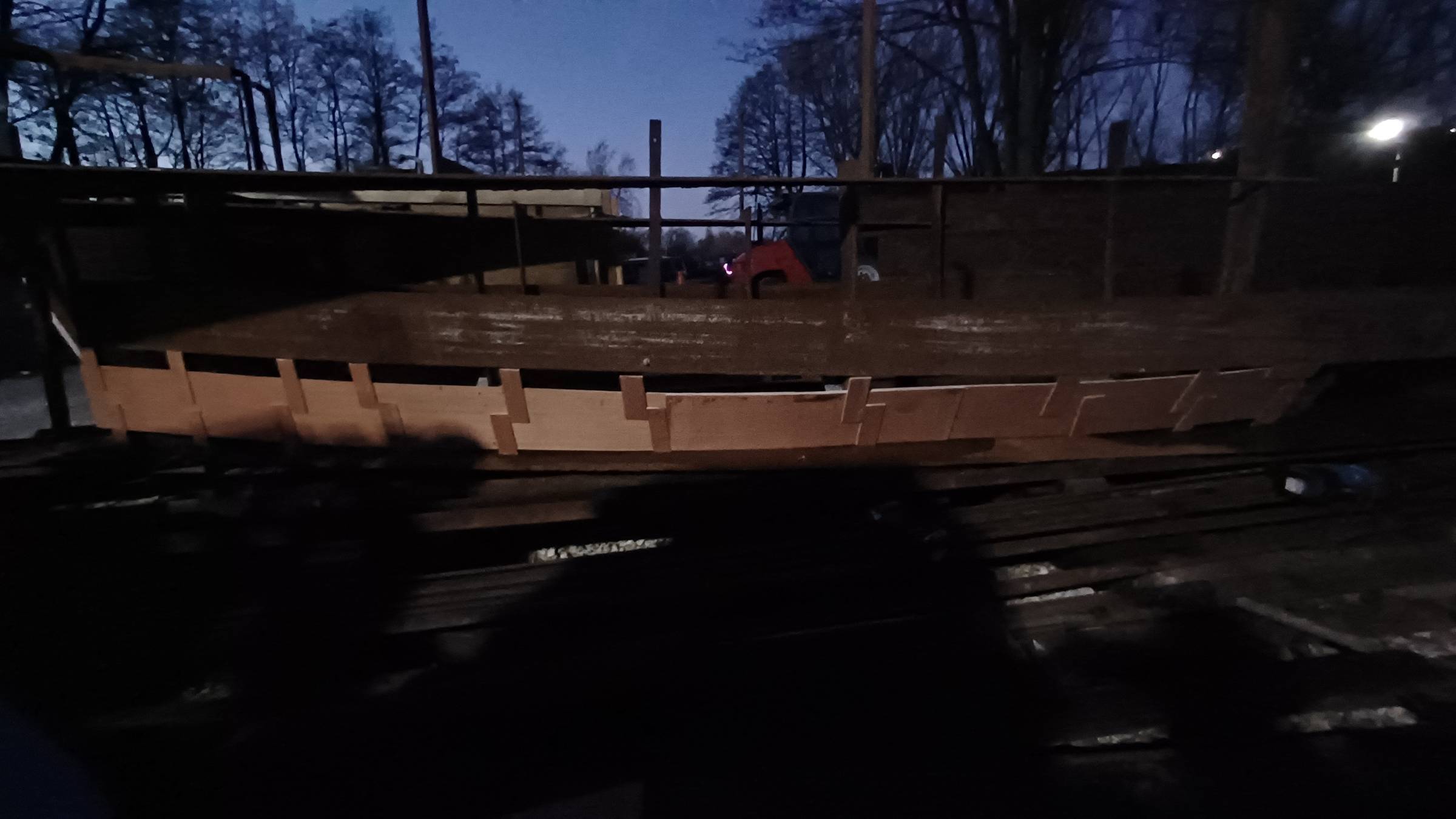

We have someone who will be cutting a 12th scale baseplate and knees which we can then "plate".... watch this space!

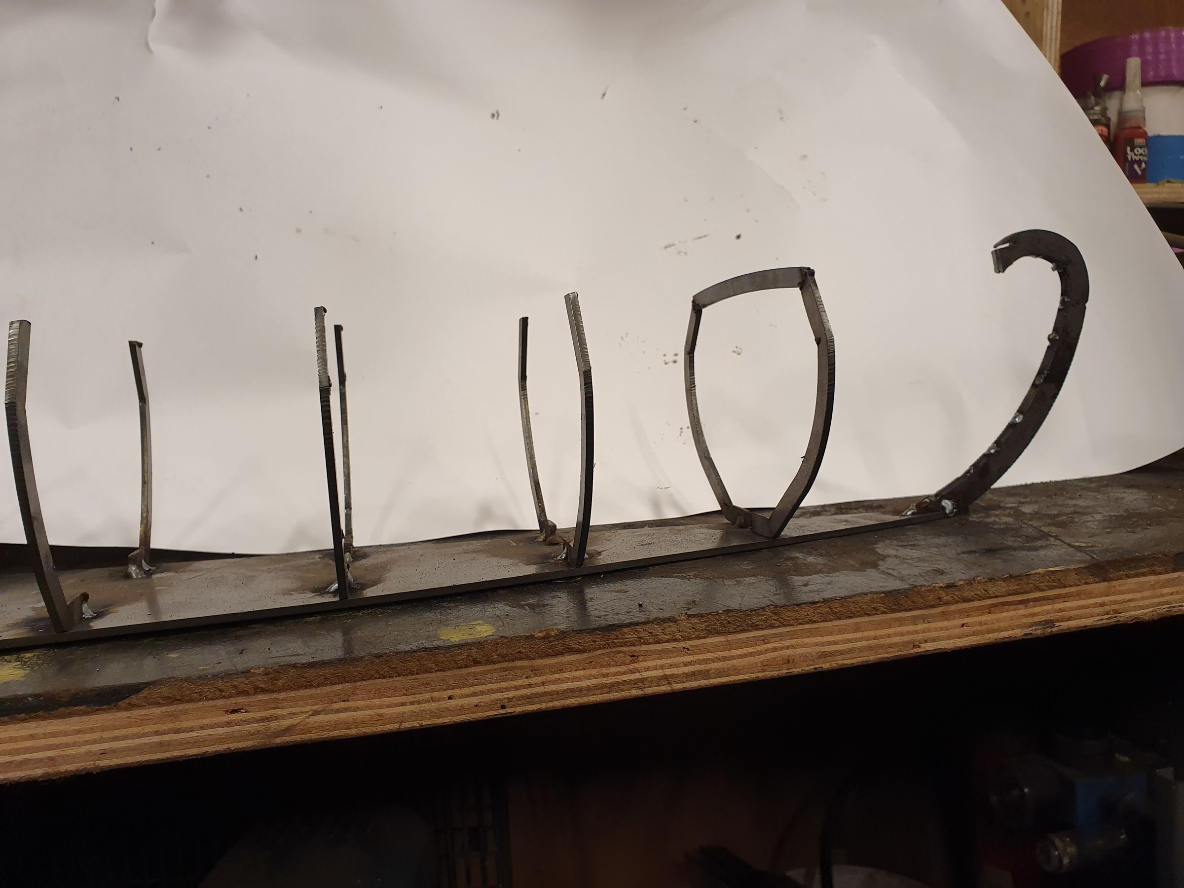

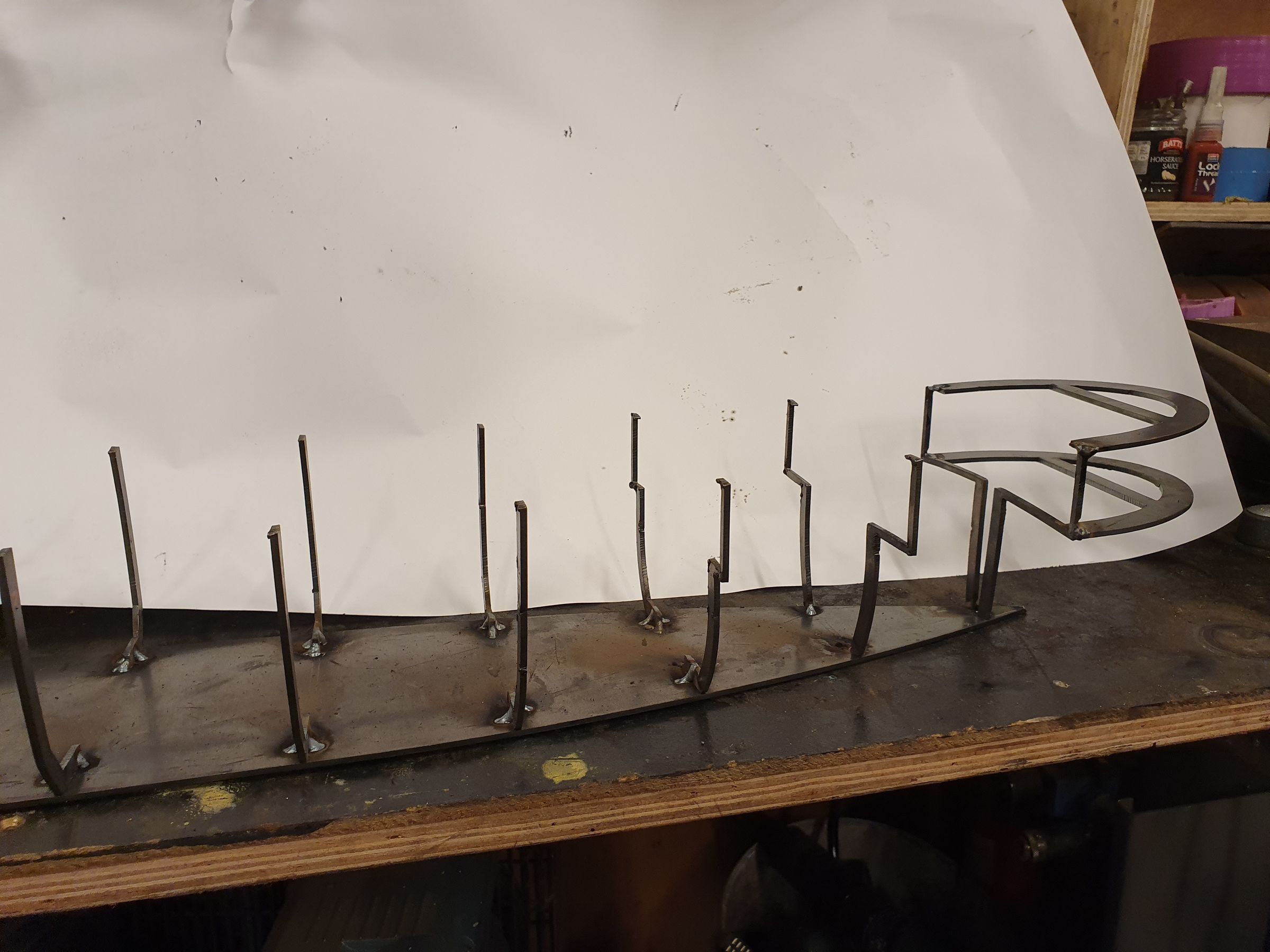

Due to self isolation I've cracked on with the model....... Daniel and Keri from Reverie canal trading co on Lyra chopped out some 12th scale bits for me which we've stuck together. A couple are slightly off and the position needs double checking... but hopefully you get the idea.

That should make a nice RC model when you are finished with it as a development tool.  You could even market them as a kit for home assembly?

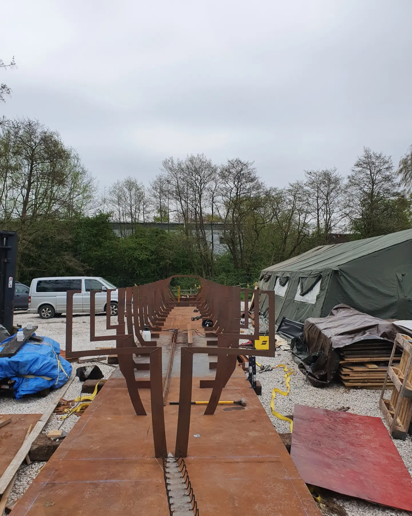

Looking very good.  That is a handy looking adjuster, next the spare flywheel/fan/plate weight.
What is the thinking behind limber holes in the front few frames, but not the remainder?
N
It's a pavers maul, used for smacking theatre show floors around...... all the knees have drain holes in, inset by an inch so we can get a tight and accurate reference point at the chine.

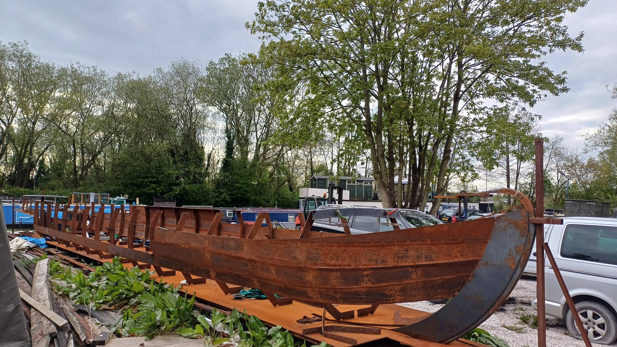

What are your thoughts on the bow section? The planks would of course have originally run right through to the bow, horizontally, but the exterior appearance would have been the ice plates, running vertically. Which do you reckon you will go for?

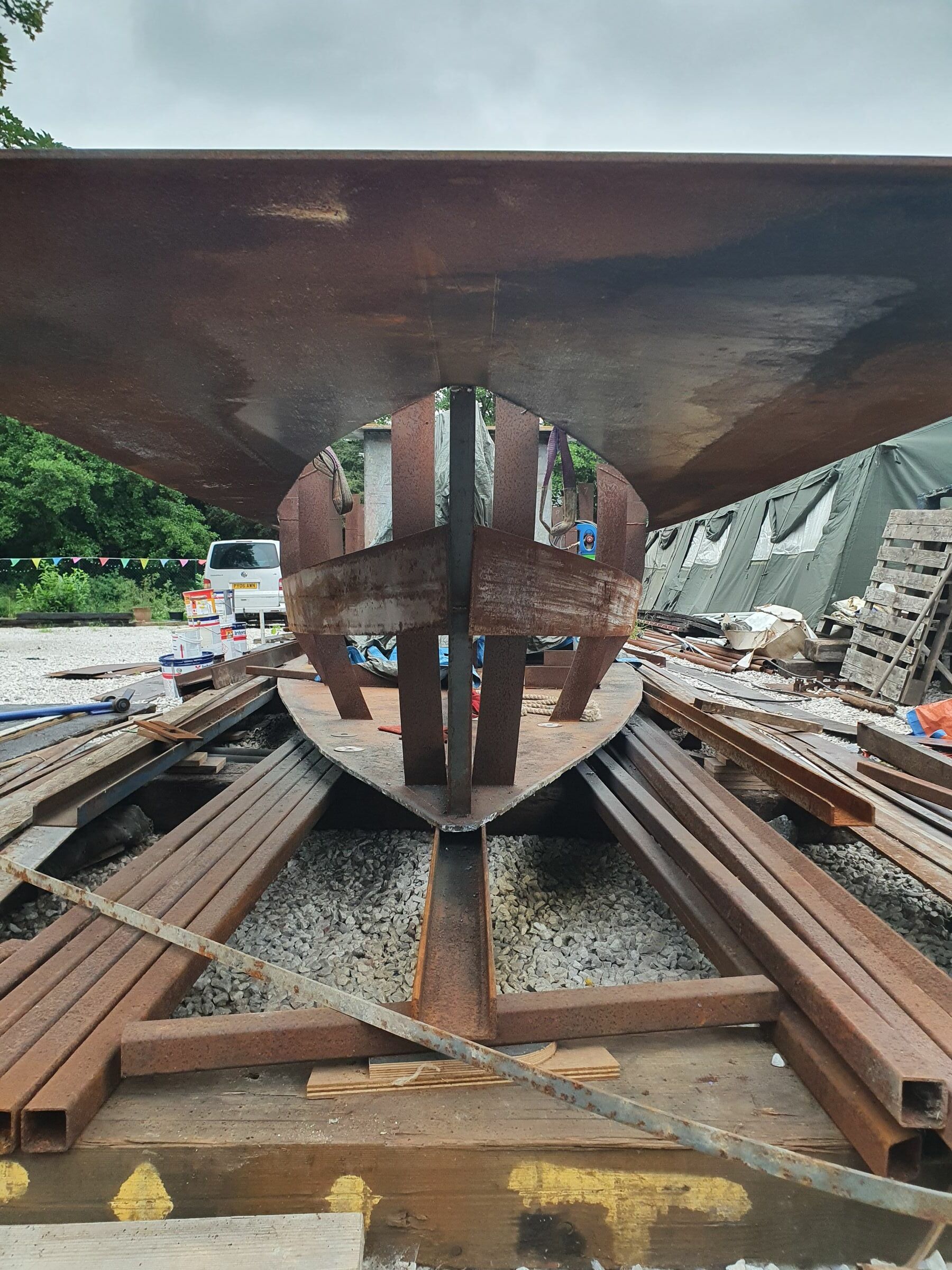

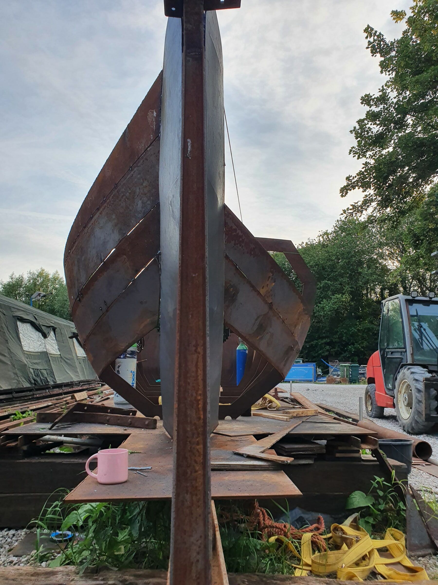

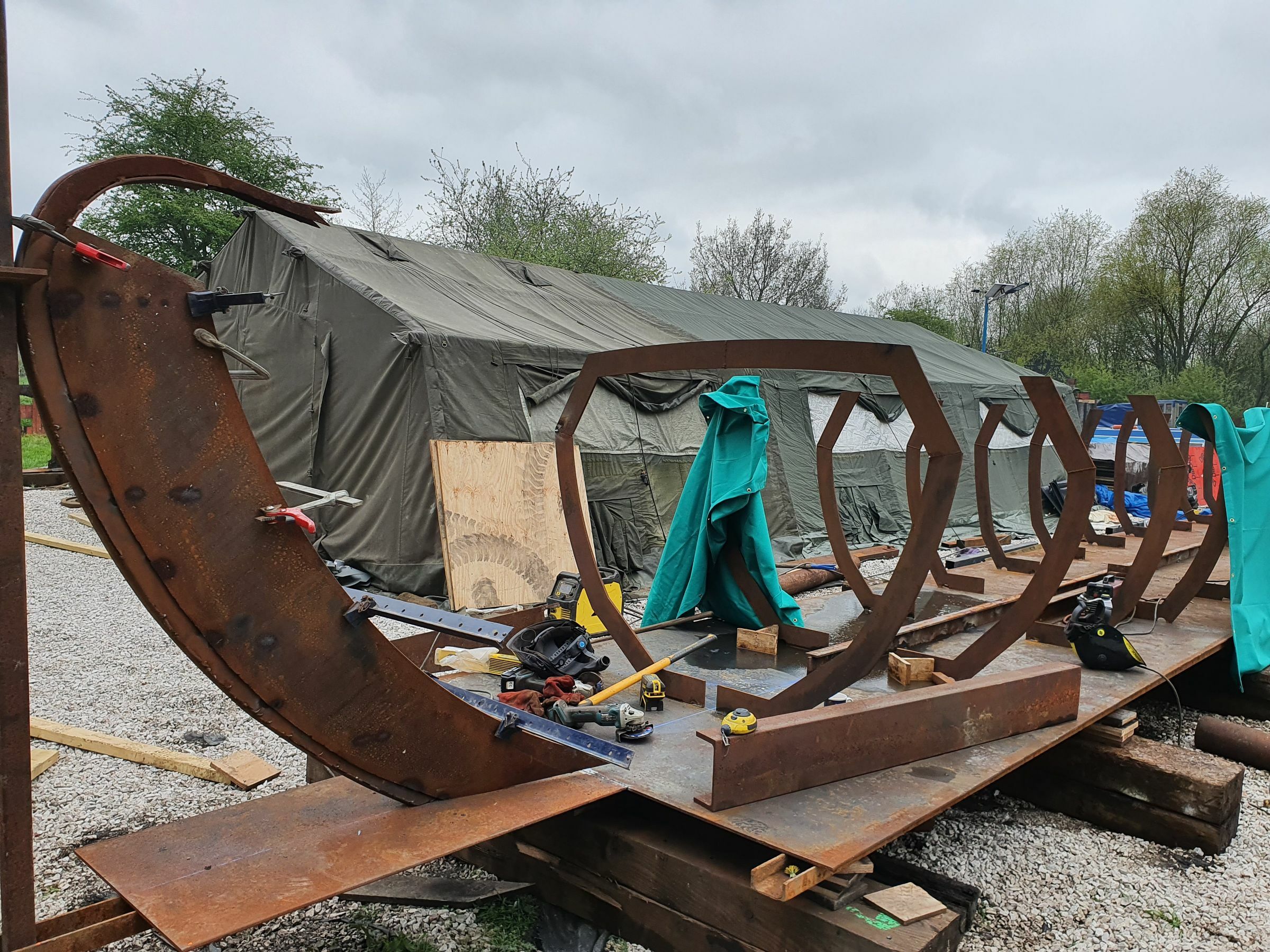

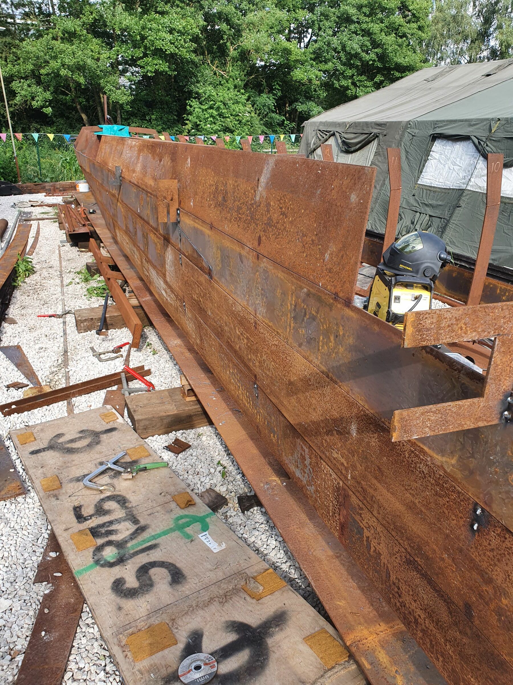

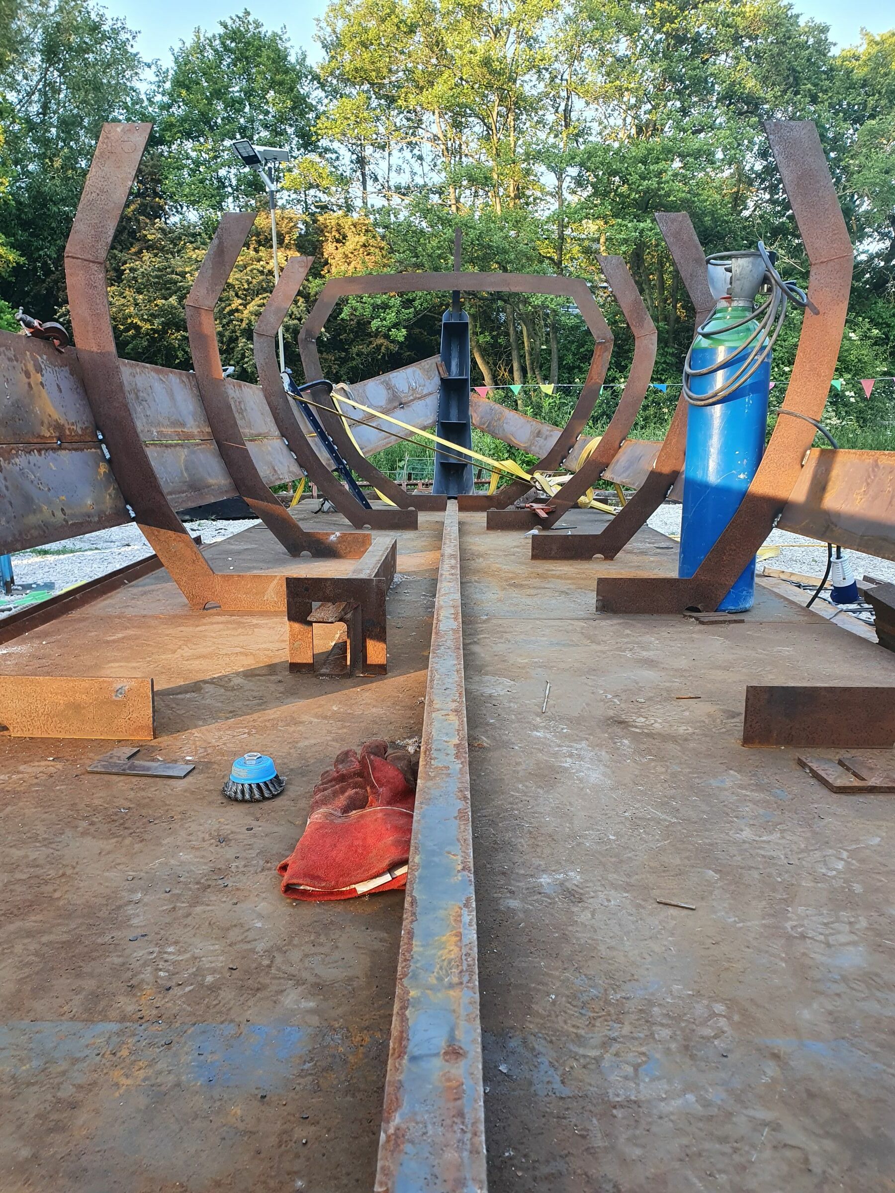

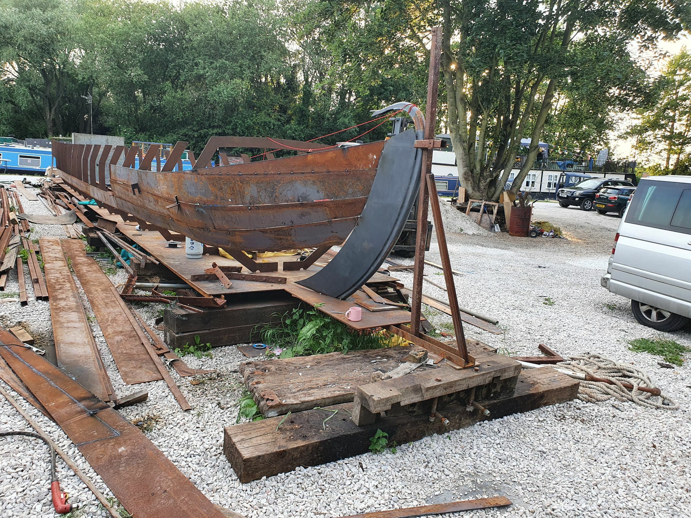

A few weeks on, we've managed to get some more planks on, which has thrown up a couple of curveballs which we thought might happen, mainly due to knee shapes. All we'll do is let some fillets in behind the knees to the planks and tweak the drawing should we build another one......

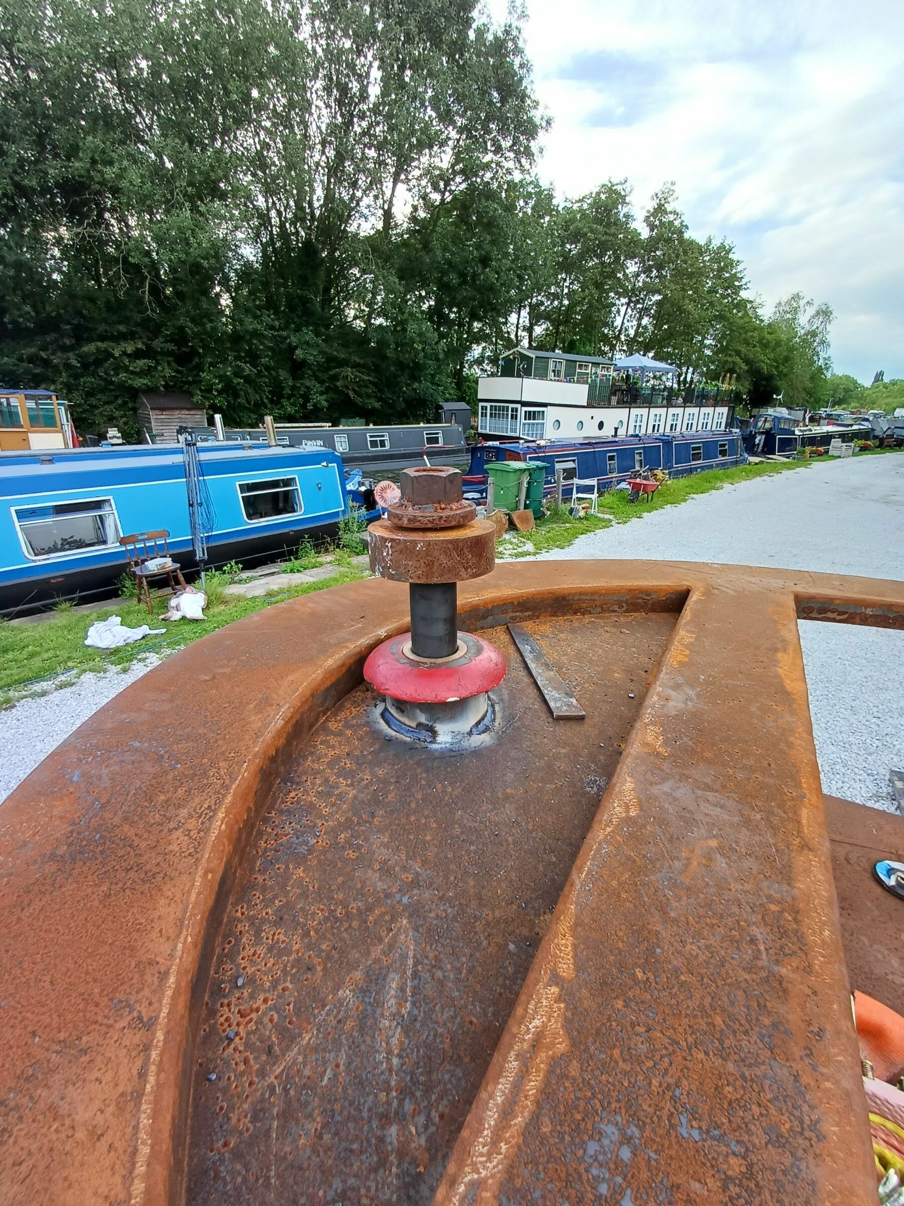

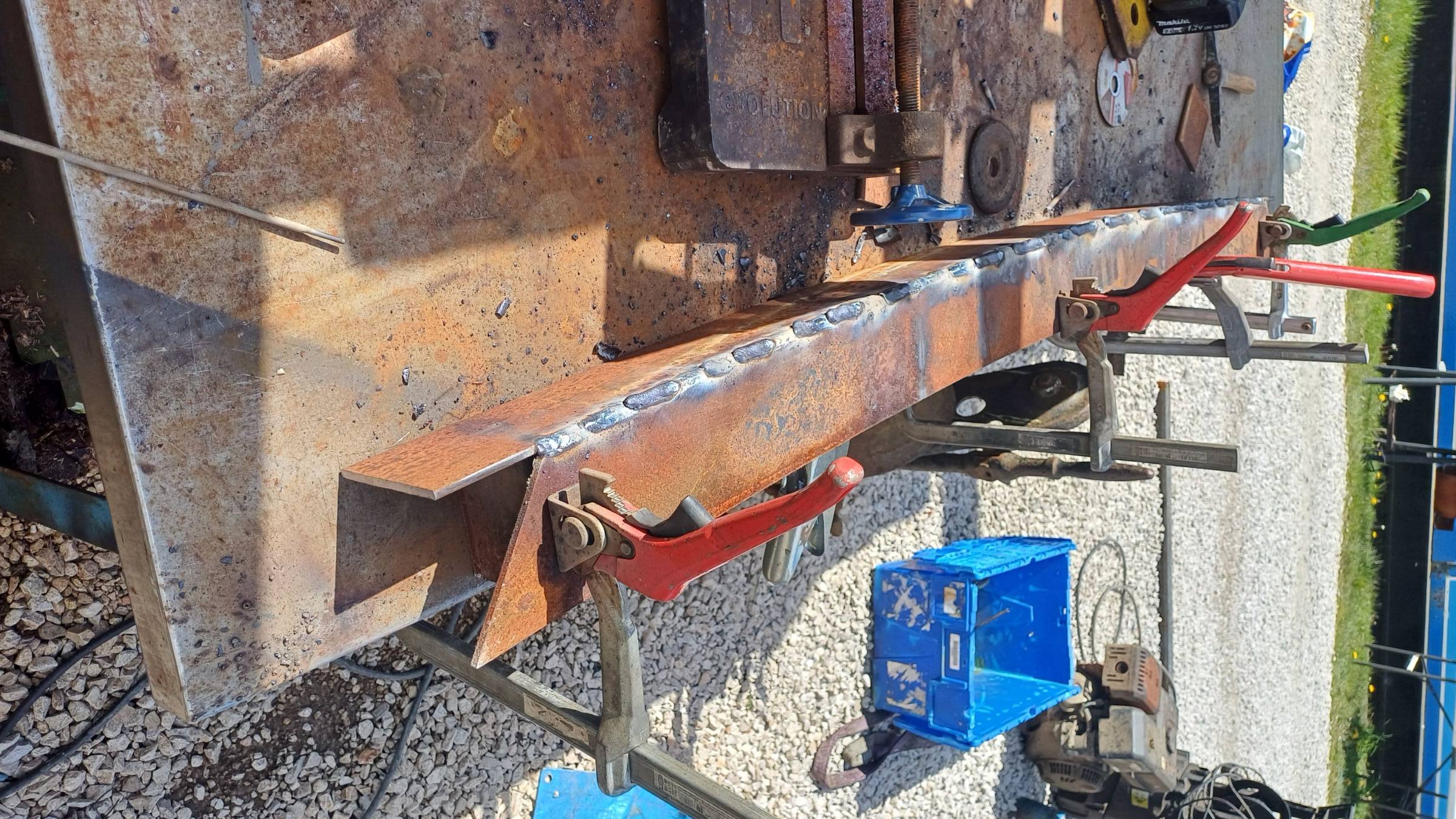

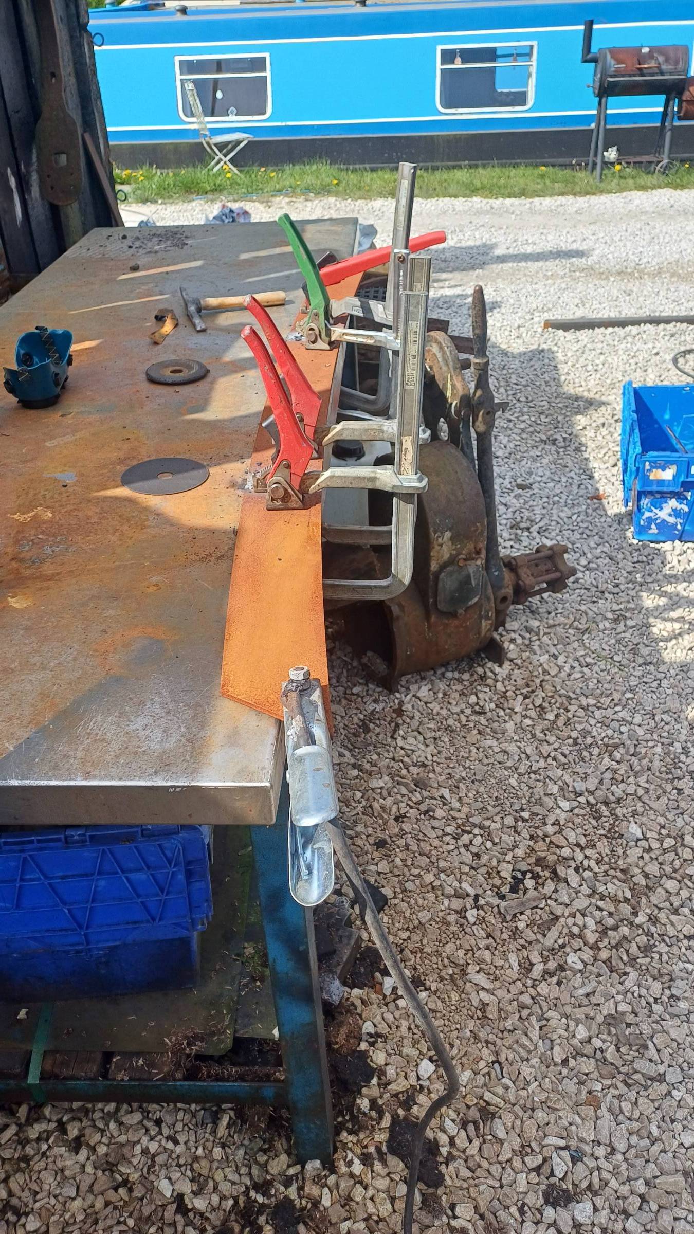

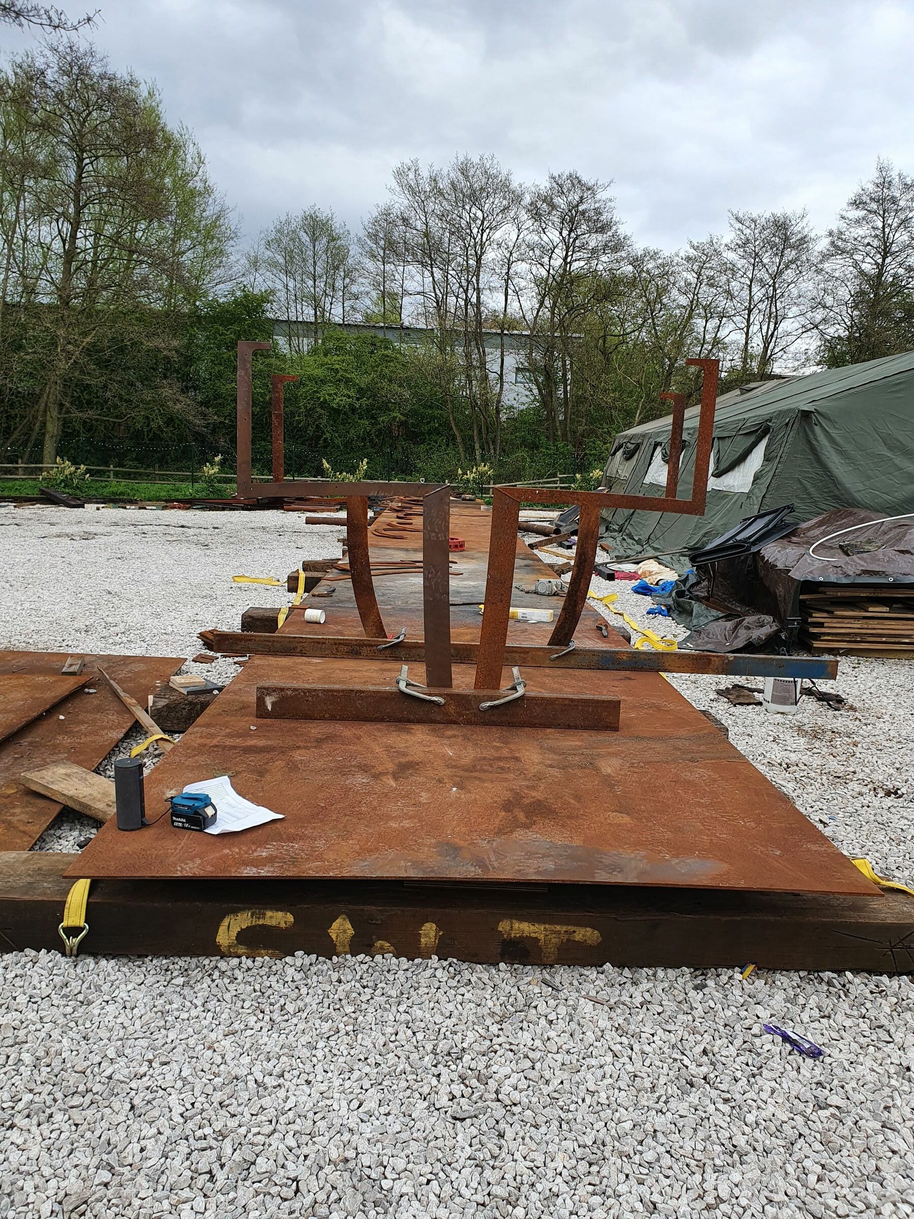

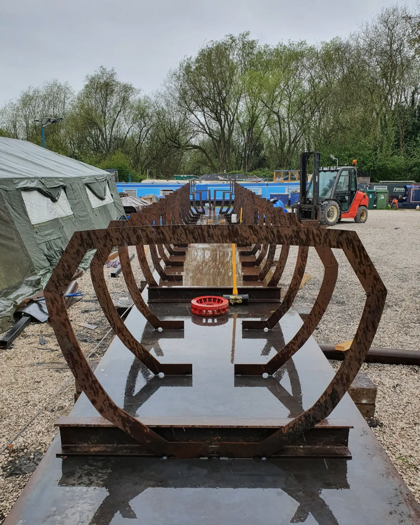

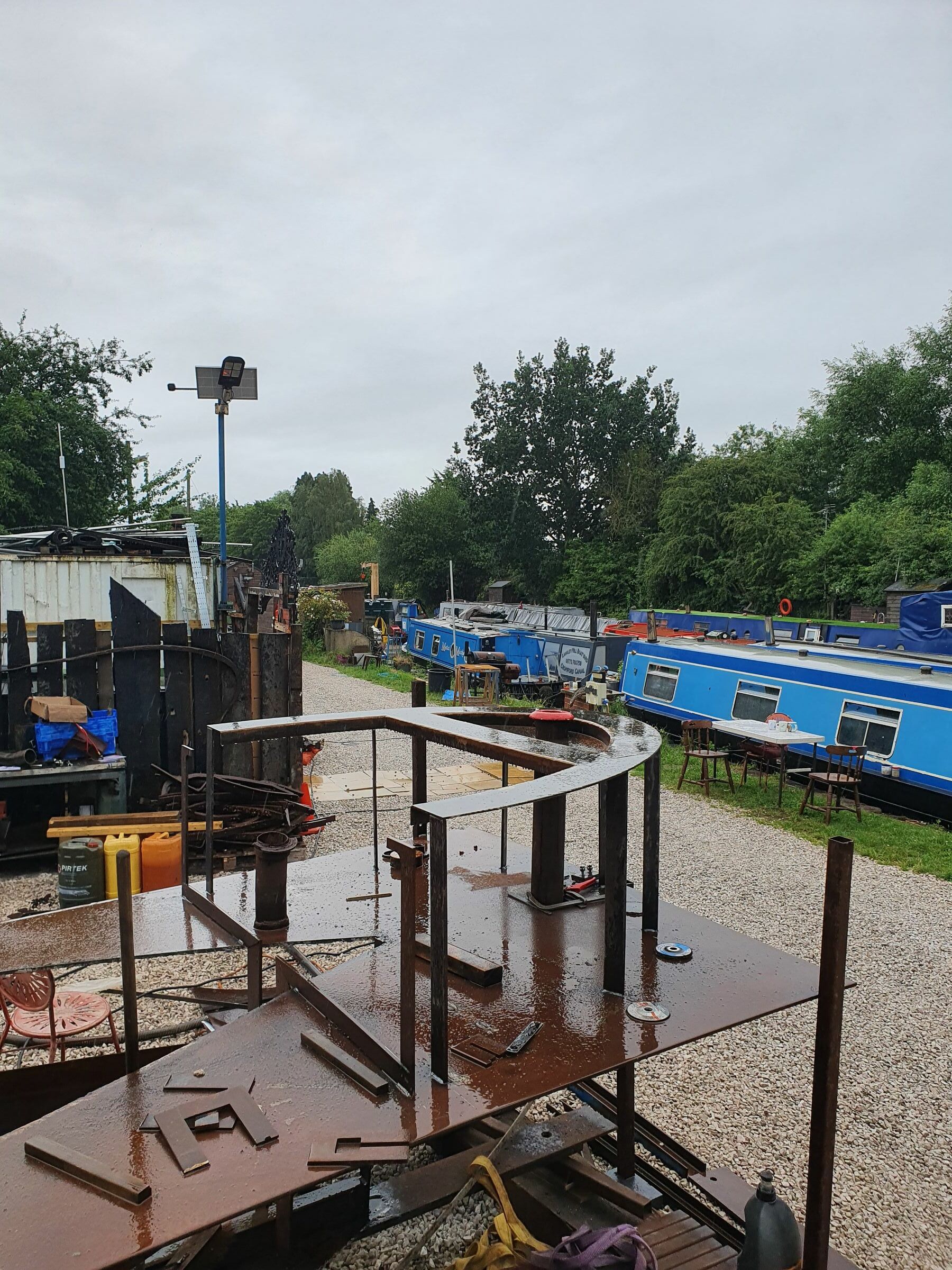

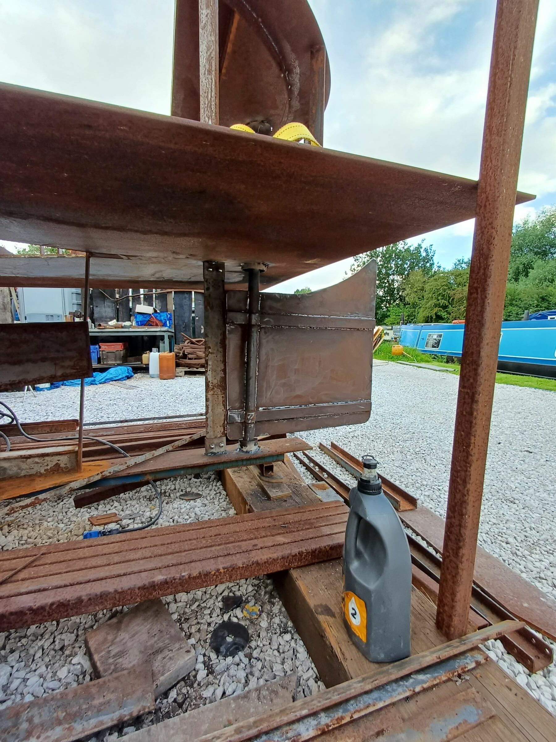

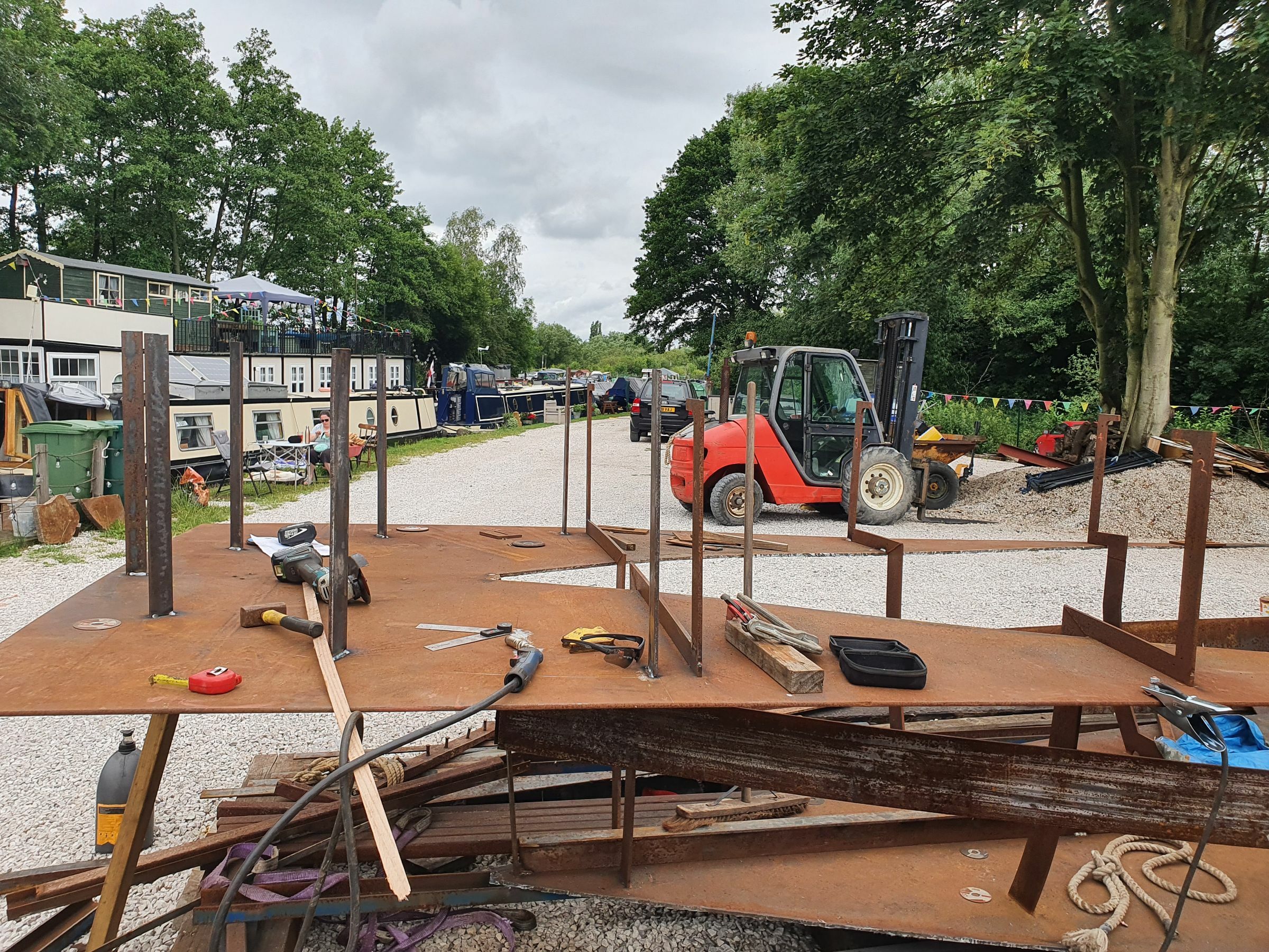

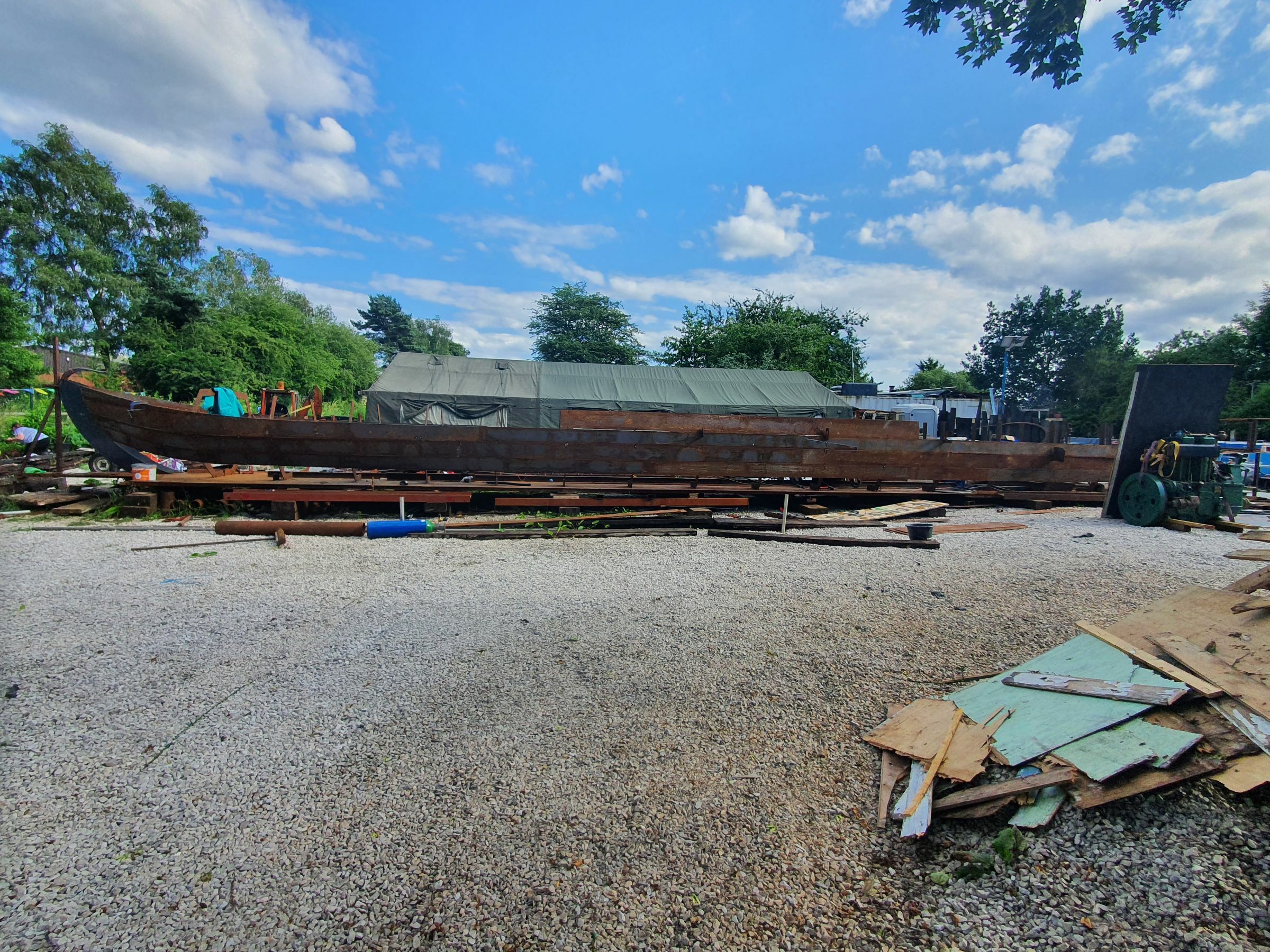

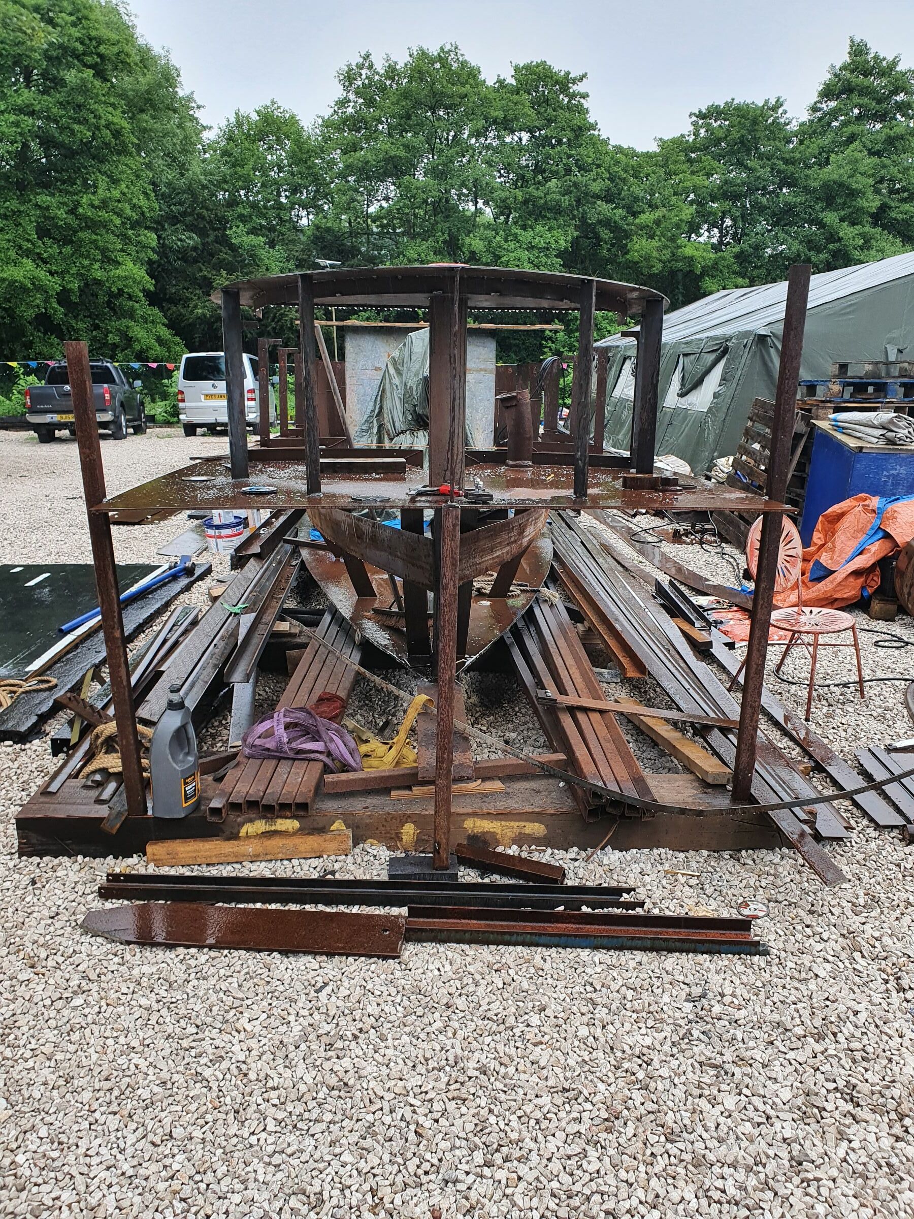

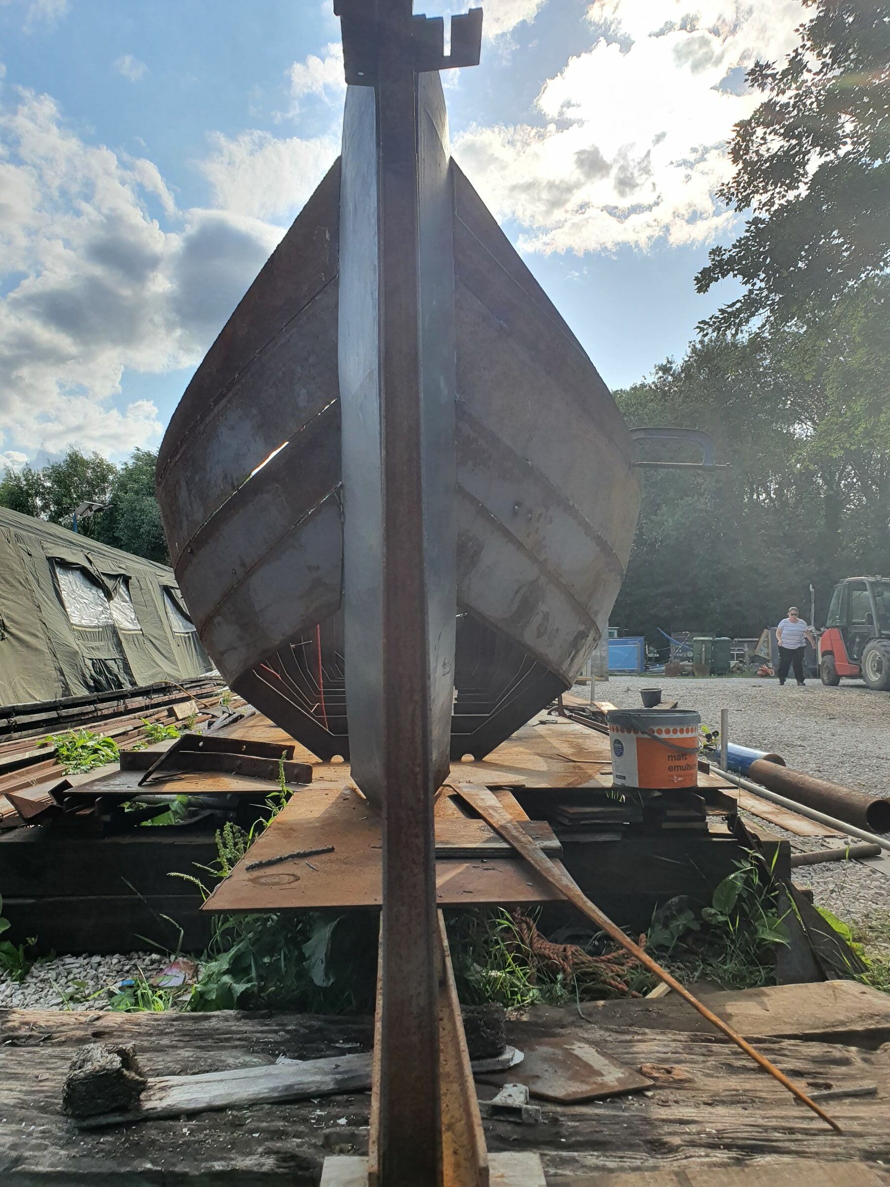

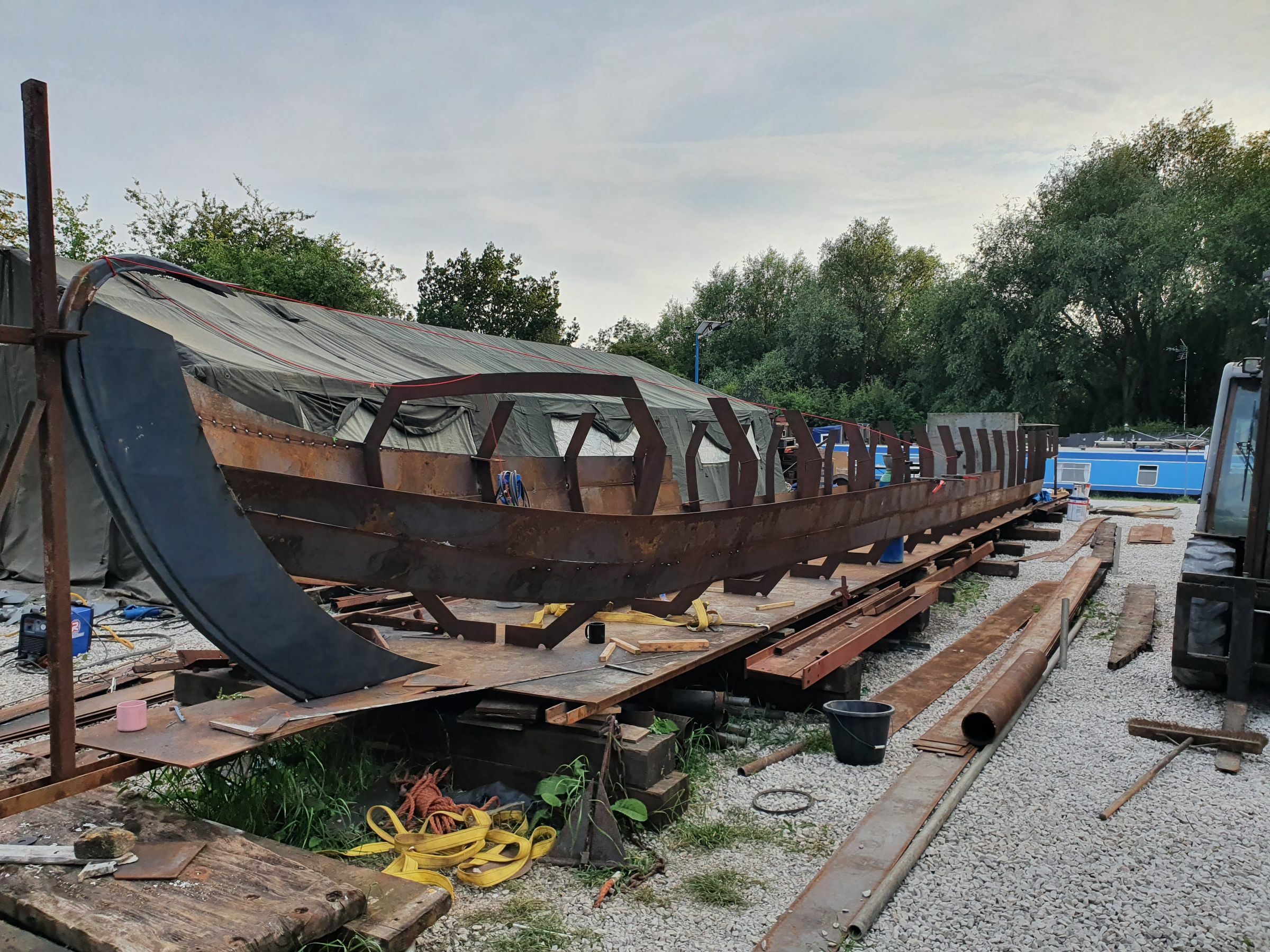

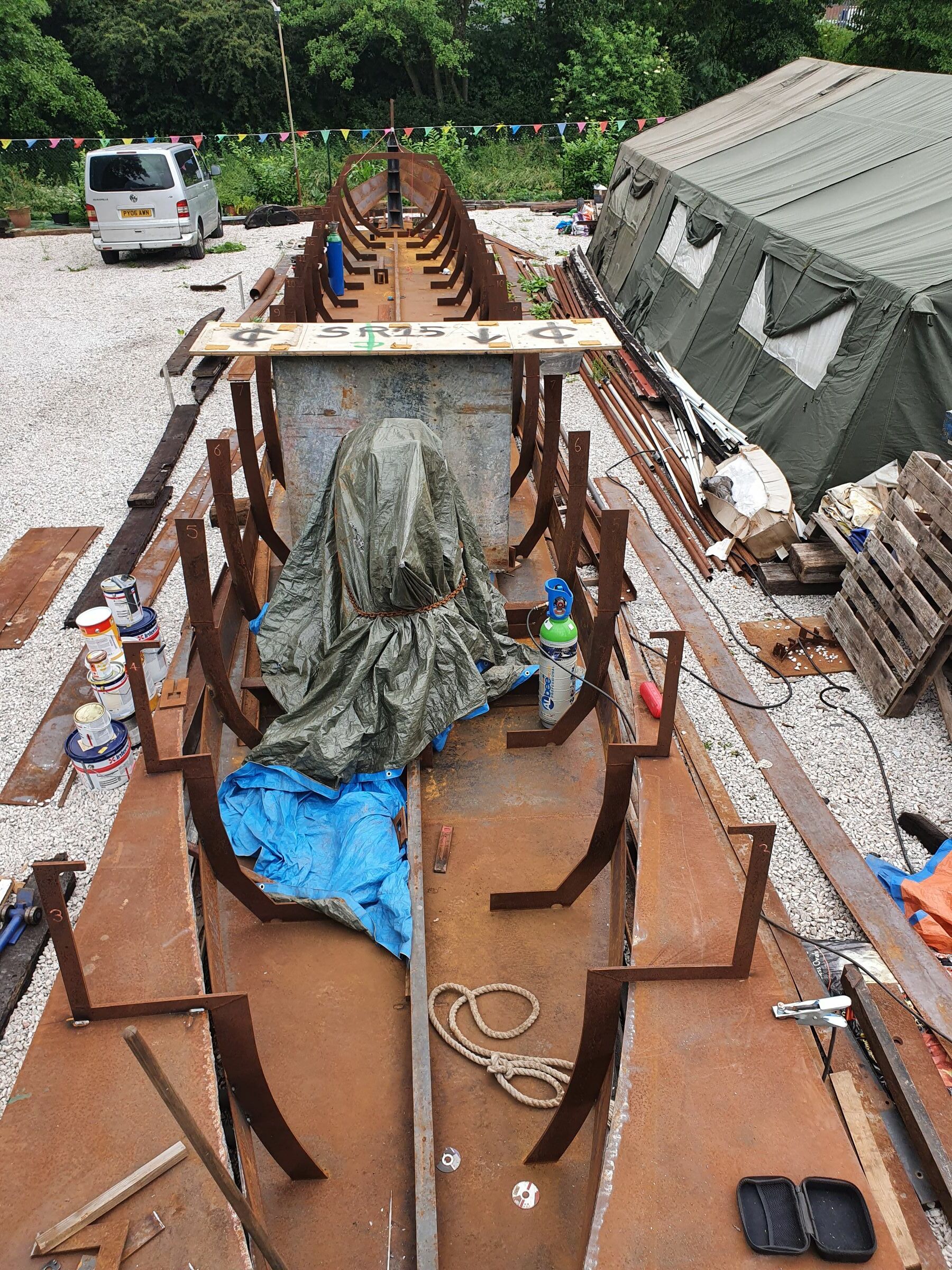

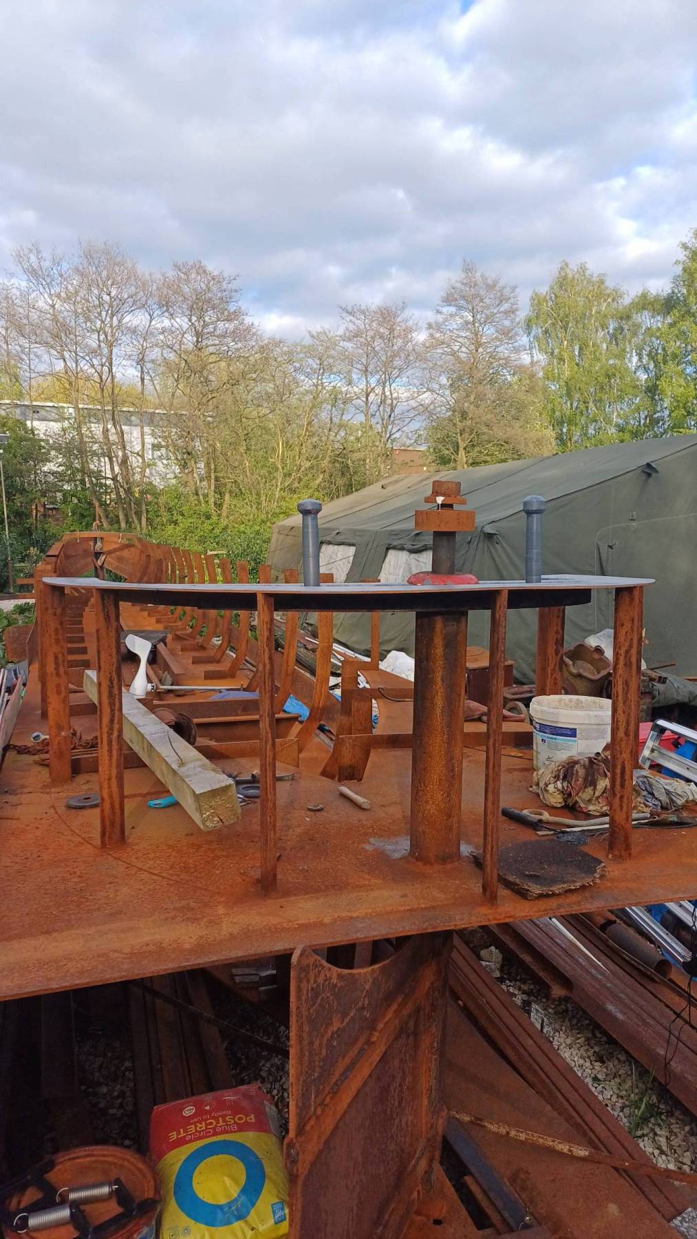

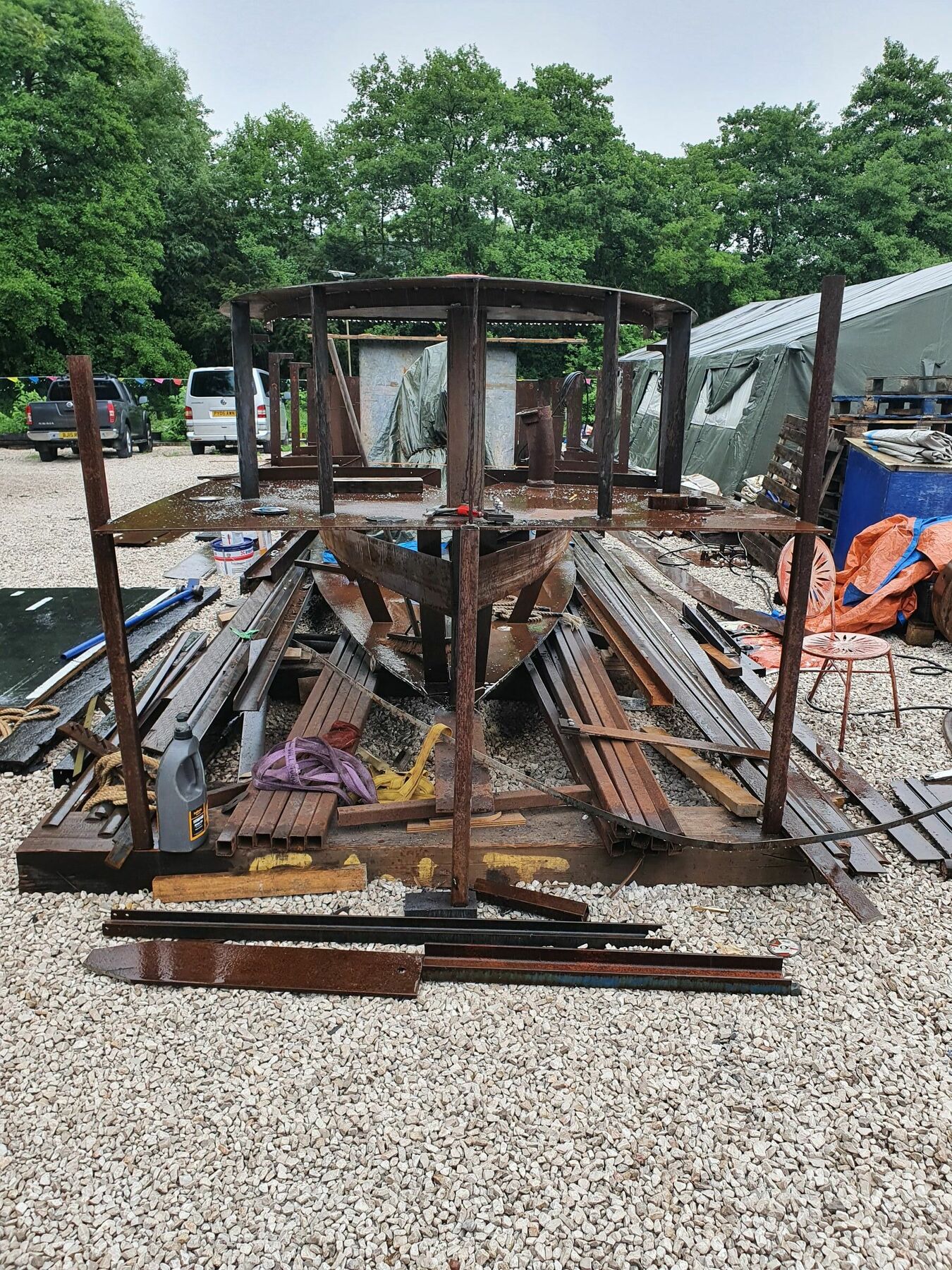

its 1 year ago today we laid the baseplate and whilst the first 6 months produced quick results, the last half of the year have been thwarted by rain, wind, floods and generally pretty poor weather. So what to report..... Well, we found her original stern dollies and rudder. Sadly they're on a bota on the K and A, made from the stern of the GUCCCo butty Satellite, called Adrastea, so they won't be reunited, and the unique Anderton profiling on the rudder top has been reprofiled to a more standard semicircle. So, we have machined an unmatched pair of dollies as they originally were, and also made a new T stud as the location of that is also unknown. We've also fabricated the majority of the deck beam on the bench, to weld into the deck beam frame which is where the first large wooden knees would have been under the deck board. The other job we squeezed in between rain clouds is starting to make the templates for sections of the hull we can't achieve with parallel planking.
We can but hope the weather will somewhat improve over the coming weeks....... we're not holding our breath.
Photos showing progress as of today
