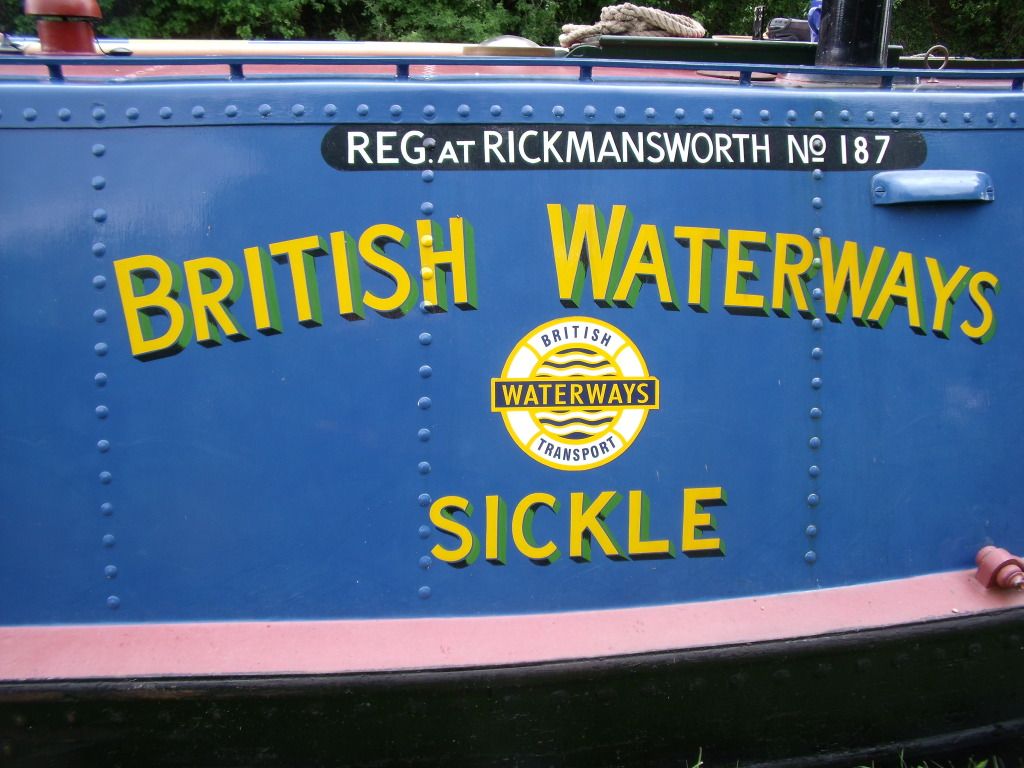

Derek R. Posted June 28, 2017 Report Posted June 28, 2017 (edited) Signwriting is a very personal art, though when done for a company does need to be uniform in application. That there are some differences from yard to yard will, I would have thought, be dictated by the abilities and demands of a given yard. Nowadays we have owners and signwriters attempting to achieve some sort of 'perfection', but in truth near enough is right enough. Though some do produce things which simply don't look quite right. There seem to be pigmentation problems in the second example from 'Cheshire Rose', and the turquoise is a bit of a shocker in the next. Some letters can appear too spindly, while others too fat. Nick Hayden did TYCHO around '08 (the licence gives me that - couldn't remember offhand!), as he admitted never having done a BW logo before I think he did very well indeed. The only mistake I made was not giving him the detail that the fleet number should have been an inch smaller that the rest. It came out the same size and does look a bit 'strong'. The first image is from stripping paint to discover what lay beneath. These are letters from 'Britain's Waterways' done sometime in the seventies I guess, and show a touch of an earlier yellow beneath. The others are Nick working in the wet dock at Harefield, and the overall result. Full and balanced. {ETA: A back breaking job - and the pound was off a bit too.] Edited June 28, 2017 by Derek R. To add text

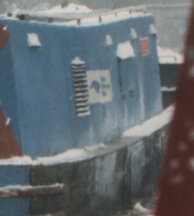

Derek R. Posted June 28, 2017 Report Posted June 28, 2017 This may be controversial, but as PYTHON has the 'space invader' cabin similar to SICKLE had in its last years as a maintenance boat, perhaps this just about visible logo should be adopted for PYTHON?

cheshire~rose Posted June 28, 2017 Author Report Posted June 28, 2017 7 hours ago, Derek R. said: Signwriting is a very personal art, though when done for a company does need to be uniform in application. That there are some differences from yard to yard will, I would have thought, be dictated by the abilities and demands of a given yard. Nowadays we have owners and signwriters attempting to achieve some sort of 'perfection', but in truth near enough is right enough. Yes I agree - that was exactly what I found so enlightening about looking closely at the different boats at Braunston. I could see there was the work of different people displayed and it became obvious to me that each has their own style and (apart from colour) I could not have said any of them was "wrong" I found them all very pleasing to the eye. I love your words "near enough is right enough." That sums it up to me - so long as we try our best to ensure it is as right as we can make it then it will be right enough Though some do produce things which simply don't look quite right. There seem to be pigmentation problems in the second example from 'Cheshire Rose', and the turquoise is a bit of a shocker in the next. Some letters can appear too spindly, while others too fat. In fairness the spindly v fat question could be the camera angle. I took them all with a fairly long lens and it can throw the perspective a bit Nick Hayden did TYCHO around '08 (the licence gives me that - couldn't remember offhand!), as he admitted never having done a BW logo before I think he did very well indeed. The only mistake I made was not giving him the detail that the fleet number should have been an inch smaller that the rest. It came out the same size and does look a bit 'strong'. The first image is from stripping paint to discover what lay beneath. These are letters from 'Britain's Waterways' done sometime in the seventies I guess, and show a touch of an earlier yellow beneath. The others are Nick working in the wet dock at Harefield, and the overall result. Full and balanced. {ETA: A back breaking job - and the pound was off a bit too.] Wow! look how green that shading is! Thanks a million for that Derek. That has been very helpful indeed.

cheshire~rose Posted June 28, 2017 Author Report Posted June 28, 2017 5 hours ago, Derek R. said: This may be controversial, but as PYTHON has the 'space invader' cabin similar to SICKLE had in its last years as a maintenance boat, perhaps this just about visible logo should be adopted for PYTHON? Python used to have the pressed alumium sign with her name on. Laurence Hog gave me photos of her in the jade green late 80's early 90's with it on. Photos of her covered in pigeon poo in Adelaide Dock when Chesterfield Canal Trust were considering acquiring her show one of them bent in her hold. I have never found out what happened to that sign which is a great shame. We had a choice of three liveries that Python "wore" with her current cabin configuration. The pale blue and white from the 80's, the green shown above and a repaet of what she was before her new bottom: We do have magnetic signs we put on when we are working though: The green was the one the team liked least 1 minute ago, IanM said: From what I understand, the GU boats kept their existing fleet number upon nationalisation so FMC boats had a F added to their BW fleet number to avoid confusion. That would make sense There is some discussion whether she ought to adopt a CCT fleet number of 5 in place of 249. It seems incredible that is all the CCT boats had a fleet number we would now be up to 8½! I think I want to keep 249!
Derek R. Posted June 28, 2017 Report Posted June 28, 2017 (edited) Thanks CR. When I mentioned the logo as on SICKLE, I meant the white panel with the blue wavy line on - not the nameplate! It would fit nicely just ahead of the engine room air grill, not a logo that many would choose, but it seems to fit the maintenance boat period. I agree the green was pretty dire as an all over colour, especially that shade. Reminds me of Matty's all over yellow - probably had a job lot of JCB paint some time in the past!! ETA: That's a lovely shot of unloading at Banbury Heartland. Edited June 28, 2017 by Derek R. To add text

Mick Poyser Posted June 28, 2017 Report Posted June 28, 2017 Cheshire-rose's statement for example 2, that it looks very "worn in" is very true. It is now 17years old and a testament to using good profession paints and sign writers.
cheshire~rose Posted June 28, 2017 Author Report Posted June 28, 2017 3 minutes ago, Mick Poyser said: Cheshire-rose's statement for example 2, that it looks very "worn in" is very true. It is now 17years old and a testament to using good profession paints and sign writers. Wow! that really is a testament to a good job and an owner that looks after it! 17 years might also offer some suggestion regarding the pigment situation that Derek mentioned, that is a lot of sunlight to fade those colours
Mick Poyser Posted June 28, 2017 Report Posted June 28, 2017 The green particularly is beginning to disappear, but I'm hoping for 20 years before a re-paint and that's on a wooden cabin.
