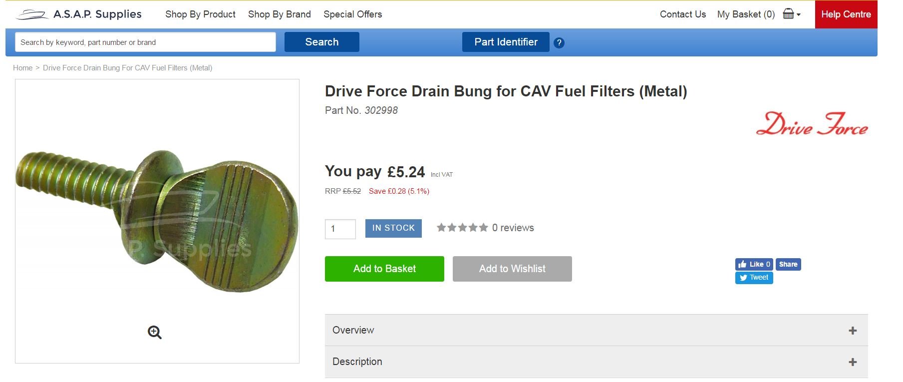

ditchcrawler Posted May 17, 2017 Report Share Posted May 17, 2017 This is a CAV one https://www.asap-supplies.com/drain-bung-for-cav-fuel-filters-302998 Link to comment Share on other sites More sharing options...
