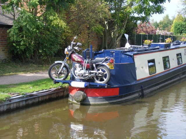

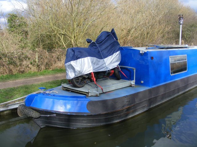

In essence it requires a wheelchair ramp just in front of the front bulkhead.  (that will require a chunk being cut from the side of the boat to keep the ramp as level as possible to the tow path).  There will be a industrial sized hinge (BIG and strong enough to carry 500lb weight) mounted vertically inside the bow matching the right hand edge of the ramp. A track about 2 feet wide (box steel  frame with diamond steel plate top) will be welded to this so if the hinge is open this track is in-line with the ramp and across the width of the boat.  When the hinge is closed the bike and track move around to the bow wall freeing up a lot of the space on the well deck.  Although this solution takes up little space while the bike is parked it does require a good bit of space for the 6 foot track to rotate round.  This will require at least an 8 foot bow deck.  Sketchup design in the works will post if you want when complete.
My biggest concern about this design is ballast.  Willl a 500lb motorcycle parked to one side of the bow affect the boats handling.  I am working on the assumption that proper position of ballast will prevent any problem.

If you are going to do this I presume you will have the shell built like that at the outset - a two foot wide gap cut out of the side of an existing well deck is going to cause problems.
A 250 kilo bike will cause the boat to list if it's well over to one side but you could compensate by considering how you distribute weight/ballast around the rest of the boat. - have your stove and the batteries on the opposite side for example.  Plenty of boats have additional ballast in the form of steel weights to counter a list but it's best if you can avoid it.

Think that second picture looks like a good idea especially if the "rack" is able to move out to the bank with the bike firmly still attached until on the towpath. If motorized would be very easy. Even a pulley system must work.

to be honest both idea appear to be terrible solutions to me.
First one wastes so much space.  and still there appears to be no easy way to single handedly manoeuvre a motorcycle on and off the boat.
the second one is a disaster waiting to happen. What happens if that strap slips or a weld or hinge decides its finally going to give up the ghost.
My idea is slightly similar to the second picture in so much as the track that holds the bike will be very similar.  The biggest difference is the location , inside the boat.
this should give you a better idea of what Im thinking.  You will see how the bike track pivots and swings out of the way freeing up space on the bow deck once the bike is stowed.
Yeah, I know it's possible DC, that's why I said "I'm not saying it's not doable, it is, but ...".  Twas but a cautionary note to check that the OP had considered the various issues involved, a few of which I went on to list. Those issues I think are all pertinent and should be fully considered before sinking funds into galley fittings.
It seems the OP has given it thought - and is also less than impressed with these examples.  His own idea might work, I don't know, but embarking and disembarking a quarter of a tonne off the centre line is gonna be interesting in terms of trim! I'd certainly recommend a fore and aft fridge rather than one athwartships if a floor covered in beer cans is not to be a regular occurrence! :D
