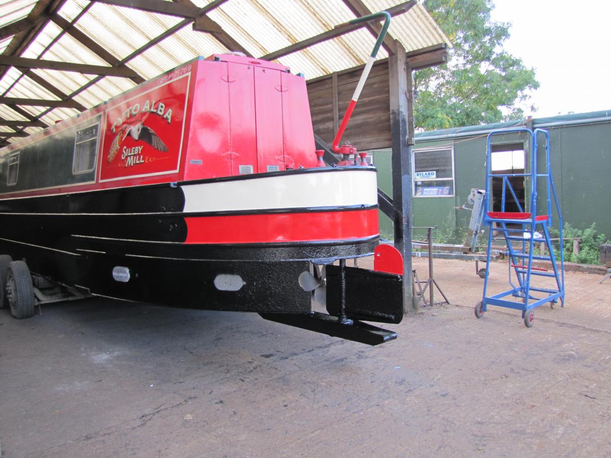

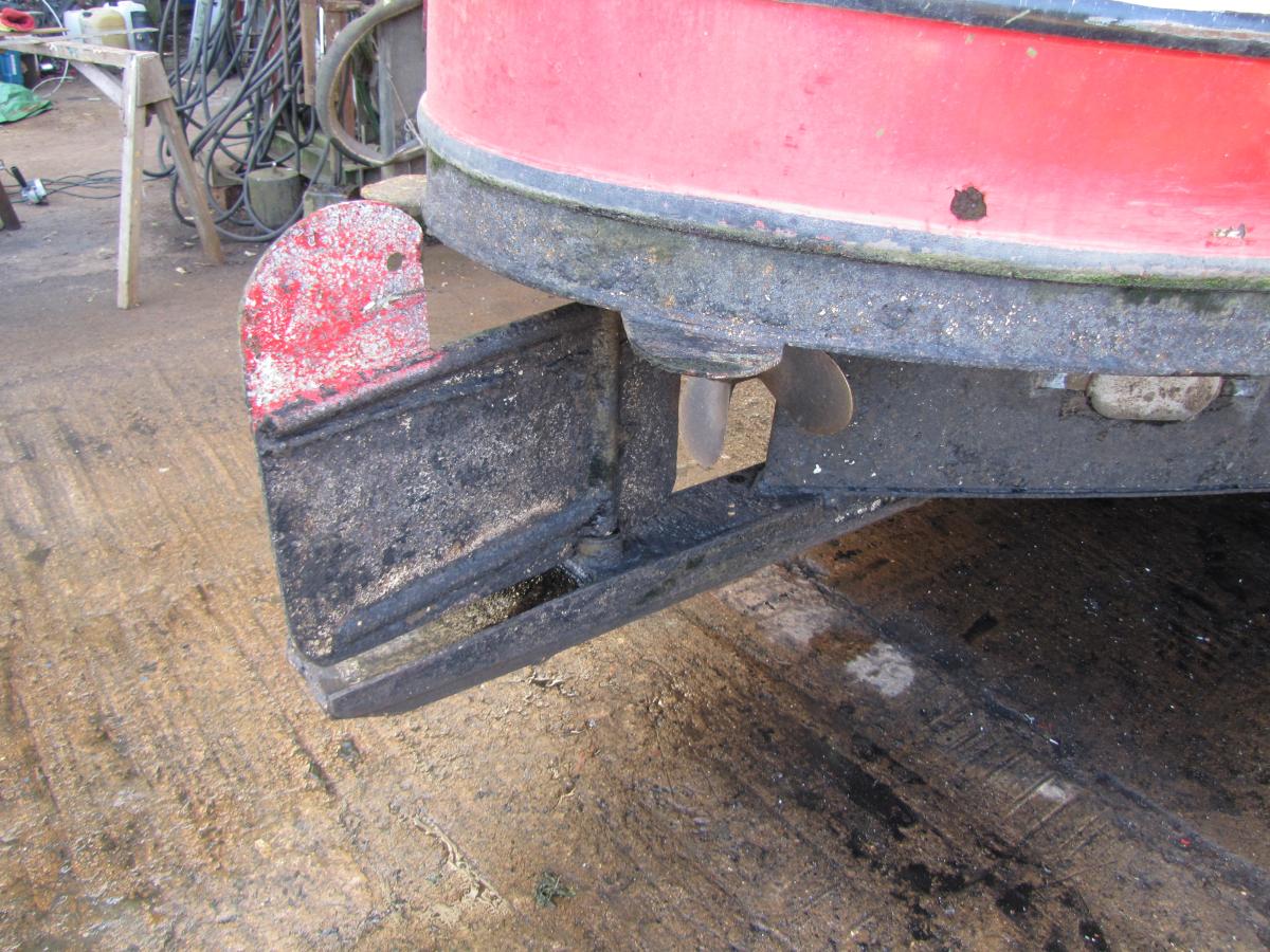

I have seen rudders with a piece of angle iron welded on the trailing edge (like one in pic.) Is this a form of Schilling rubber? What are the advantages of this angle iron approach?
Thanks.
can have a schilling rudder with or without the "fish tail" it is the airfoil that make the schilling, more expencive to make but when they are don they are no more problem then other fixed plate rudders, Dalslandias is 25% thick, with a slight fish tail. http://www.marineoffshore.net/communities/4/004/010/356/784/images/4572613890.jpg
