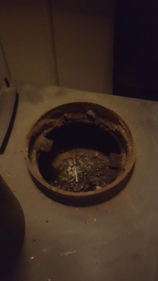

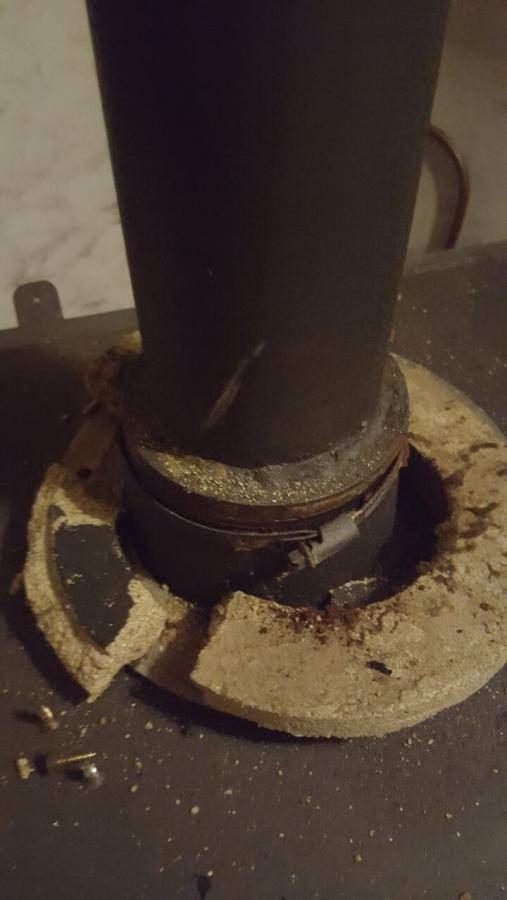

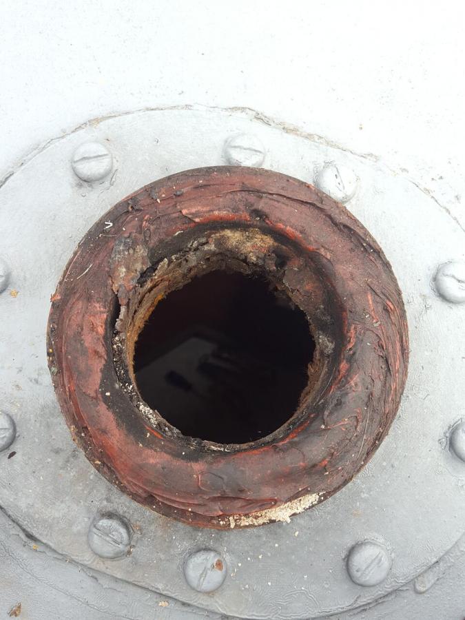

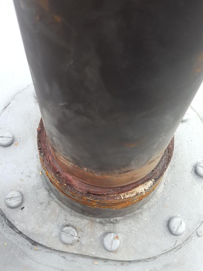

So I have read about people packing out the flue with rope, is this where the flue meets the boat roof or the collar ? Any tips for how this is done would be really appreciated, basically want to figure out what else I need to buy !
I have ordered a flue and some of the high temp silicone as recommended smile.png
I have attached some photos of the half removed flue and the new stove top,
Thanks
Shows current stove and flue
Shows new stove top
Shows where current flue meets boat roof
Never actually installed a flue on a boat (just repaired the existing one in ours) but my understanding is that the rope is used between the stove and the flue to bridge the gap and reduce the amount of sealant required (and to support the sealant). As far as I know the flue normally slides up the inside of the collar and is a fairly tight sliding fit in it (but should still be able to slide, otherwise when it heats up and expands it will put a big stress on the stove).
Anyway, you could always read the instructions! (which mentions using the rope between the stove and the flue)

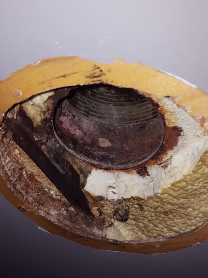

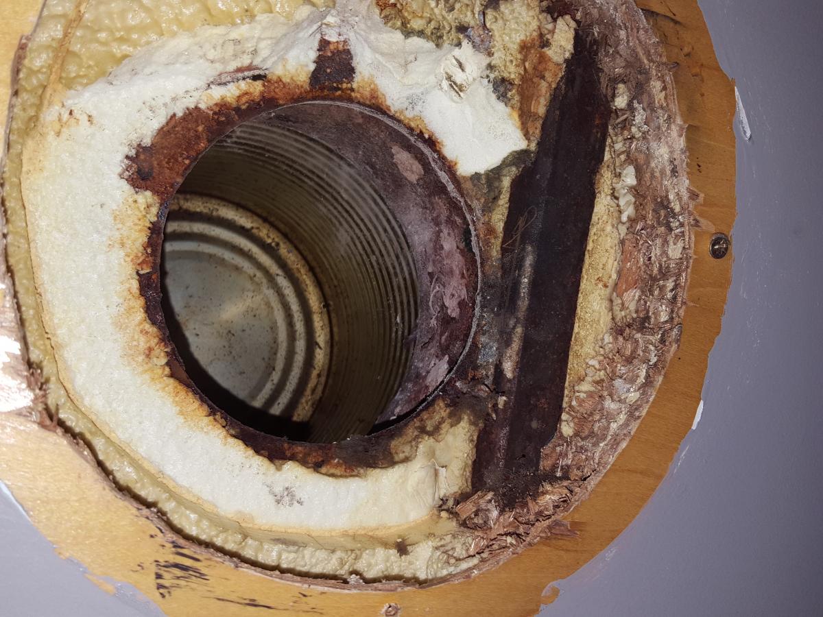

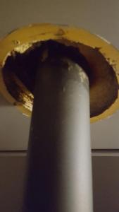

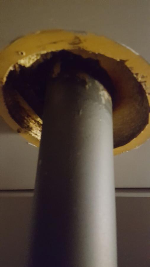

Thanks for all your comments, the flue has arrived but I have encountered a new problem! as always seems to be the way tongue.png
The hole in the roof is not big enough for the new 5" chimney, it seems the roof collar is about 5 1/2" and you can see in the photo a sample section of black 5" tube standing on top of it, there is a large gap which has been filled, but once I have cleared all this out I can see the roof hole is not so large :/
The photos from inside show the smaller diameter hole approx. 4 1/2" and there is what looks like a metal roof support !! would it be possible to just jig saw this hole a little bigger ?? what can I do about the metal square section? is this structural, I would need to cut about half of this to make the hole 5" so I can fit my new chimney and use the existing collar.
Any help appreciated, not sure how to tackle this one....
Thanks
Martin
