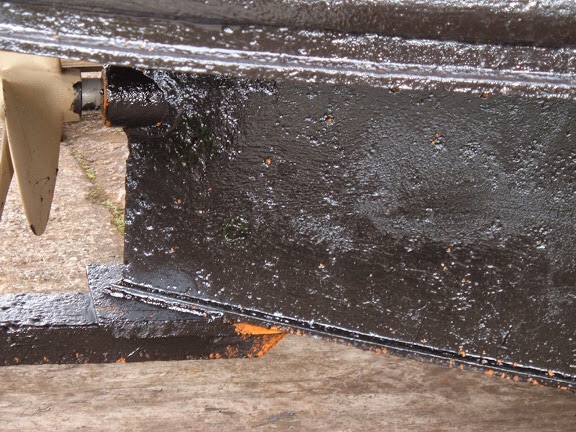

That looks just like mine did before I wire brushed and blacked it in May.
