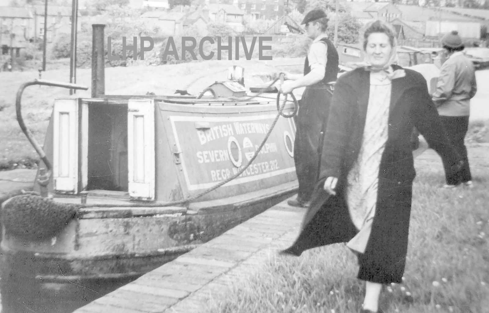

Pictures of these boats working as a cargo boat are rare, however this shows Severn "Dolphin" at Tardebigge in the 50's. Her cabin is virtually as built, but note the deep counter and the probably original rear doors, the tiller looks a little odd and may not be original, following this traffic she went to the BCN.
One thing we found on Tucana when sand blasting the hull was that she had been painted battleship grey all over at some time and there was evidence of red lettering on the top bend at fore end. This livery concurs with MOWT other vehicles and machinery.

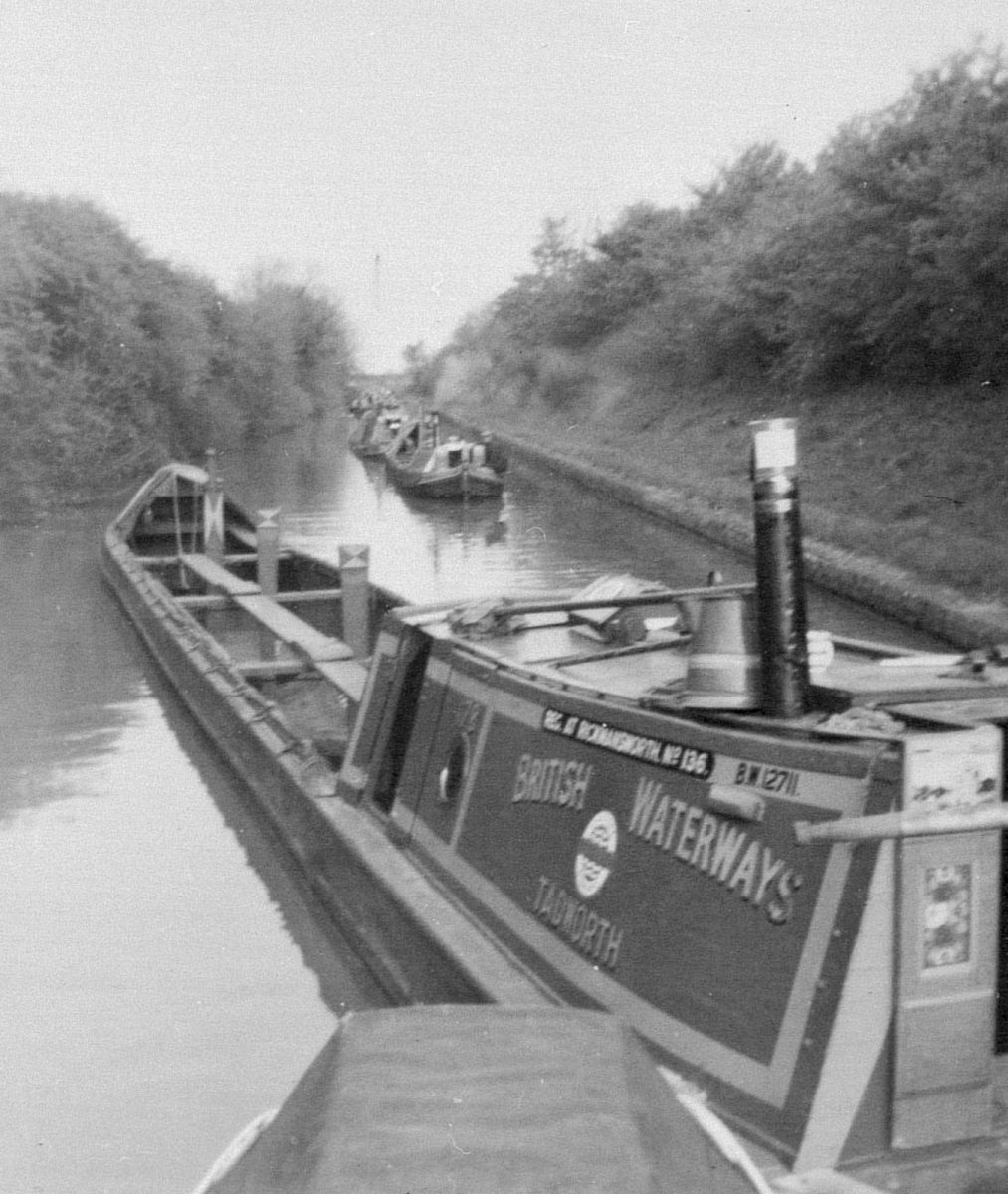

"Tadworth" certainly retained a very original cabin in BW days except for one odd item it seemed to have a aquired an oval port in the pigeon box of the type used by Walkers, seen here in a stoppage in the early 1960's
