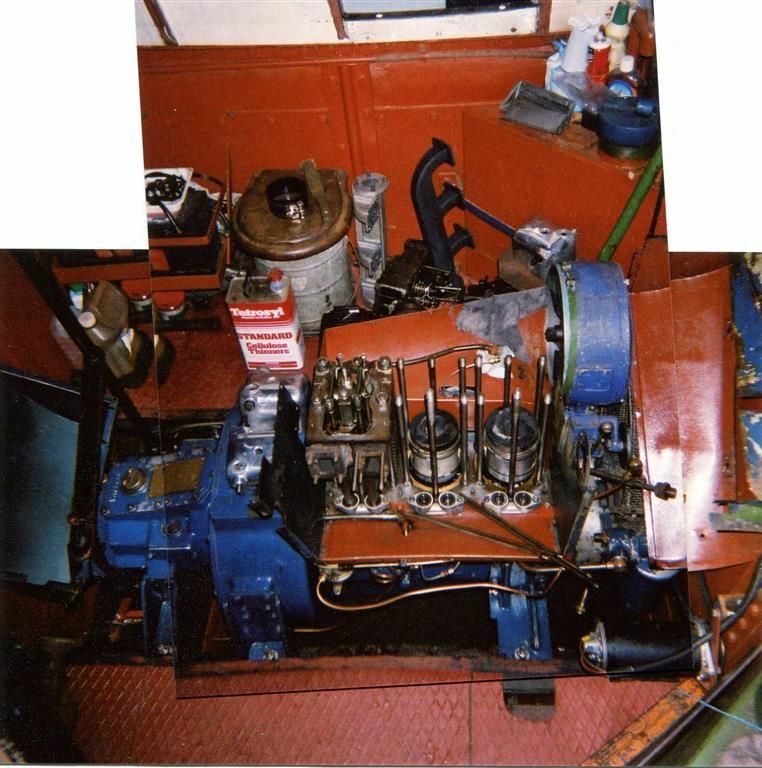

We had a PD2 that came out of a ships lifeboat. After installing it in YARMOUTH, we spent many years slogging around the system from Guildford to Gargrave, taking in the Thames and Trent. Never missed a beat. Straight through pipe - you could hear us coming. Get in a tunnel and the rythyms echoing from the tunnel roof from the exhaust would have you dancing on the back step. We'd heard about their cranks breaking, and one or two knowledgeable folk (ex-boatmen) had theories, including making them slog at low rpm, to poor starting techniques. Another suggested leaking oil coolers causing pressure drop. I always turned mine over a dozen times or so with the lifters up, hit the starter, drop the levers and she'd fire instantly, never failed. But one could not start her by hand, took two on the handle. Roger and I did it once. And I lost count of the times I'd forgotten to take the gas bottle cap off the exhaust to be followed by a clank on the roof as it landed, never accompanied by a splash oddly enough.
Sold the boat in late '92, and within three months heard the crank had broke. The chap also had caused damage to the Z bar, doing something that forced the bar and tiller so far forward, he had to cut some wood off the tiller handle to clear the top of the hatches.
I had heard that BW were offered a bunch of PD's from stationary sets to replace aging RN's, but don't know the truth in that. Maybe they were engines destined for landing craft and no longer required. 'Chip fryers', they weren't quiet mechanically being air cooled and much tinware.

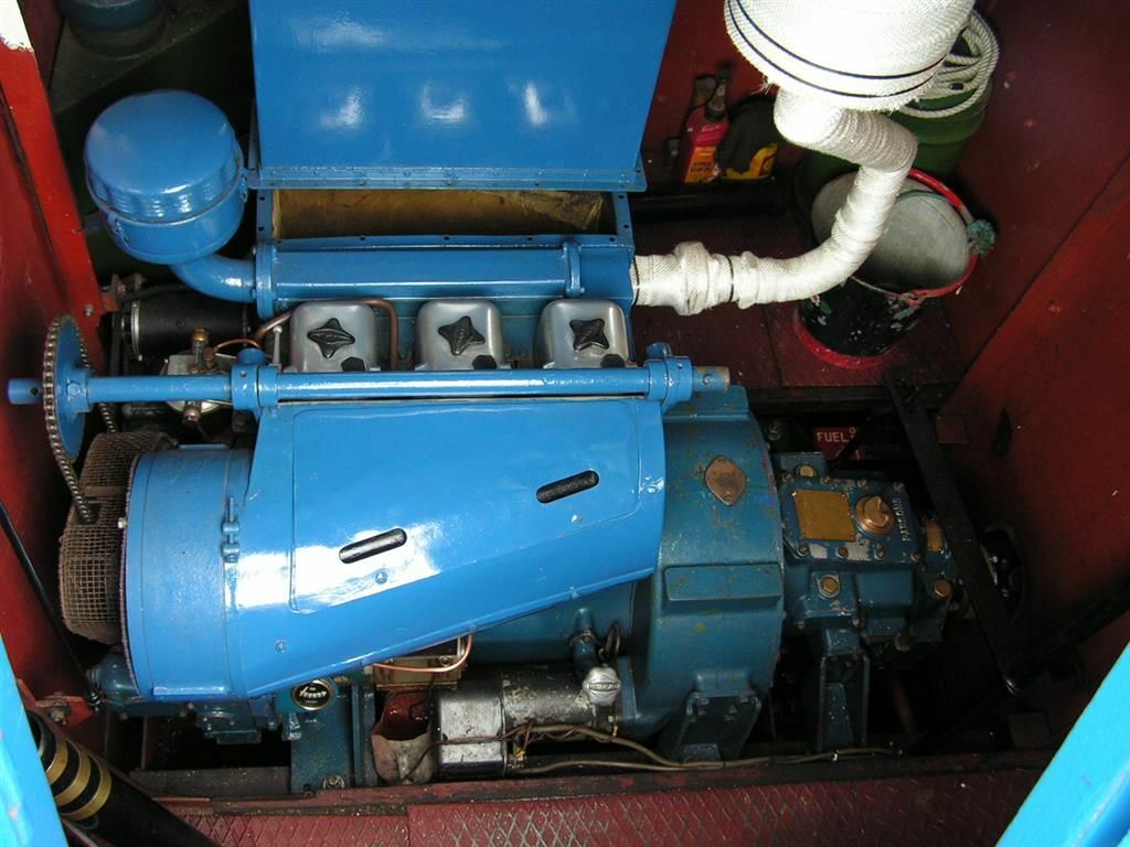

The three pot version in TYCHO. Sods to work on.
PS: NOTE - the flywheel at the gearbox end.

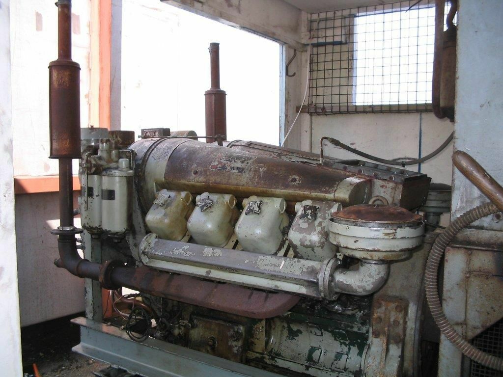

A PDV8 generator set (image courtesy of young Mr. Riches.) Bet that sounded good!

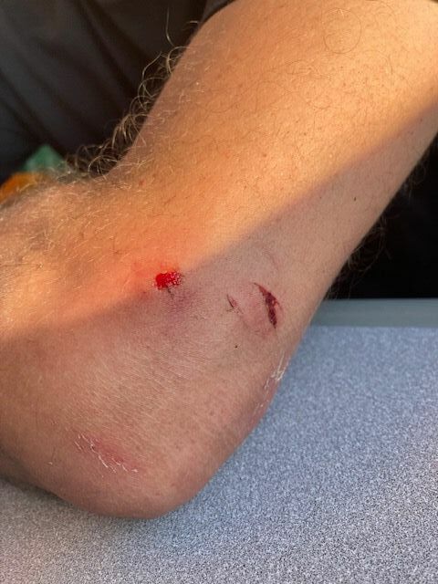

16 hours ago, Captain Pegg said:
Is the K2 in question hand start? If so I hope there is a nice clear space around the engine.
Nasty!
Is that an elbow or a knee? I can't decide!

@MtB That photo was my elbow after two days on a boat with a hand started K2 that I moved. The technique was to give it your all on a downward push as you only had half a turn to get it moving and hope it fired on the spark. Even the bloke selling the boat took a few efforts to start it himself. I was pleased to get it started at all. Unfortunately there was a very poorly situated metal locker on one side and I caught the top corner with my elbow a few times.
However, the water pump on the engine didn't seal and only worked at all at high revs. A pity then that it was on a couple of the hottest days of the year and the engine ultimately just kept getting warmer and warmer so it had to be stopped and restarted after it had cooled. I ended up hitching a tow for the last couple of miles. The boat was also squalid. @PaulJ's recent comment on having to sleep on filthy boats brought this one to mind.
Hence as lovely as the K2 is I do shudder when I see mention of one. A bit big for most boats though.
