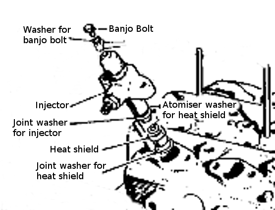

davehindle Posted April 16, 2018 Report Posted April 16, 2018 Hi All I haven't looked inside yet so I don't know what is missing / present but before I start replacing what I think is missing, can you have a look at this please? I've taken this from the workshop manual - blown up the injector part of the diagram, removed the irrelevant engine parts and added the text for each of the numbers on the original. Two things jump out at me: 1. There seem to be three washers in the injector chamber, not two - one 'joint washer' under the heat shield, the atomiser washer and a joint washer between the injector and the heat shield. Does the 'joint washer for injector' sit on the brim of the top hat or is it not needed? 2. There is only one 'washer for banjo bolt' marked, not two. Comments in this thread and the contents of the washer kit suggest that there is a copper fuel washer above and below the spill rail.
Tony Brooks Posted April 16, 2018 Report Posted April 16, 2018 (edited) That is correct, two copper washers and one crimped steel atomisation washer down the hole as y7ou describe. The sizes are such that I think its impossible to get them wrong. There should be soft washers both above and below the fuel rail banjo. I have no idea why you do not have a leak if there is only one. I have never gone out of my way to remove the top hats (heat shields) unless they were broken, I had to to get the old atomisation washers out or they came out on the injector. If they do not come out it might not be so easy to get them out on a well carboned engine so if they are in there and there is no signs of blowing past the injector I would not remove them so that washer is not required (its the one with the thinnest "wall" and largest hole). Edited April 16, 2018 by Tony Brooks

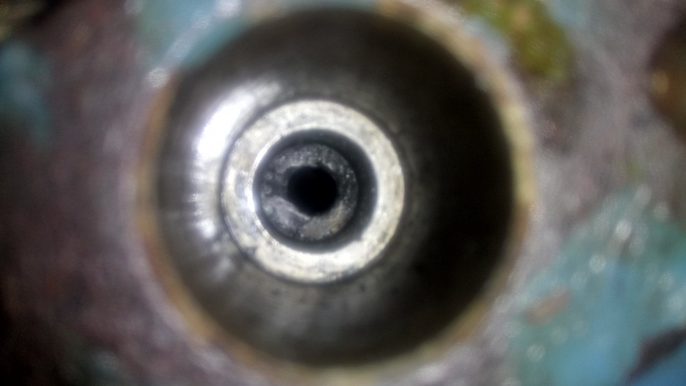

davehindle Posted April 17, 2018 Report Posted April 17, 2018 Hi Tony Great tips again but I think you misunderstood my post. The comments I made (1 and 2) relate to the manual rather than my actual observations of my engine. The manual tells us we need 1 washer under the banjo bolt but none under the spill rail. It also tells us we need a total of three in the injector chamber - thanks for confirming this. I have now extracted my injectors and I see that I do have heat shields (they look a bit rough - the holes in a couple of them look a bit misshapen). What I did find was that none of the heat shields had atomiser washers. Thanks for advising that I don't need to take the heat shields out - I tried but they wouldn't budge. I will install new atomiser washers and reassemble the injectors with their existing heat shields and joint washers. Thanks again Dave
Tony Brooks Posted April 17, 2018 Report Posted April 17, 2018 If its the the hole in the bottom of the heat shield that looks a bit misshapen then you may be looking at a squashed atomisation washer.
davehindle Posted April 17, 2018 Report Posted April 17, 2018 Hi Tony. I think you are right. I took photos and the metal at the bottom is silver coloured.
davehindle Posted April 17, 2018 Report Posted April 17, 2018 The problem I have is that all this material is jammed down the hole. How do I get it out?
Tony Brooks Posted April 17, 2018 Report Posted April 17, 2018 (edited) I had an old motor cycle spoke with one end bent a right angles, sharpened to a point and hardened. I could often work the point between the atomisation washer and the heat shield. If that did not work sometimes by putting a smallish screwdriver across one side of the wahser and hammering it the washer would distort so it could be hooked out. You might find that if you get a long tap (as in tap and die) that is the same size as the hole in the atomisation washer but smaller then the hole in the heat shield you could screw it down a turn or so and the use pliers to pull it and the washer out. If all that fails the I am afraid its heat shield out. You MIGHT be able to hook it out but you may well not. In that case is either head off and try to get something up the pre-combustion chamber throat to drift it out or bodge a tap suitable for the hole in the heat shield onto an impact slide hammer and try to extract it in situ that way. I think we had one we made with the tap brazed to a length of steel pipe, and old coupling as the weight and a length of steel bar welded to the top of the pipe. However looking at your photo I am not so sure there is a washer down there. Where the carbon has chipped away it looks like flat steel to me with no signs of the squashed crimp that should be in a washer. You really should get rid of the carbon and then spin the engine on the starter (eye protection) to blow any out of the cylinder. If it turns out there is no washer then I would replace the heat shield. If the hole is much oversize then you will have reduced compression. Edited April 17, 2018 by Tony Brooks
Kingdom Isambard Brunel Posted April 17, 2018 Report Posted April 17, 2018 That heat shield looks eroded. If it has been used without a fire washer it will be. Bite the bullet, pull out all 4 and replace with new parts, and all new washers, they are not expensive. If there is a washer down there and you put another one on top, you will break the end off the heat shield. I cannot understand not having a copper washer above and below the spill rail union, they would never seal properly.
