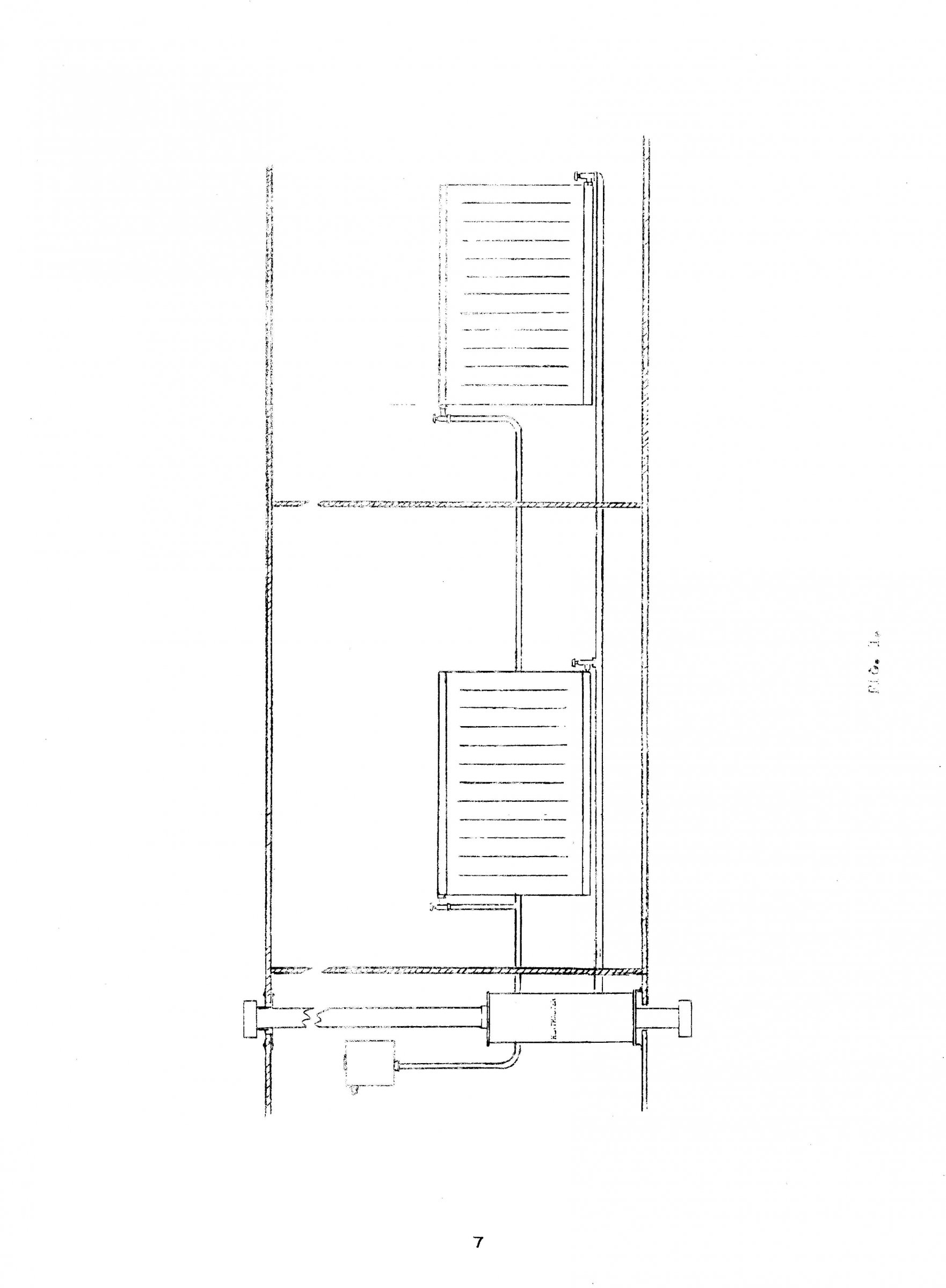

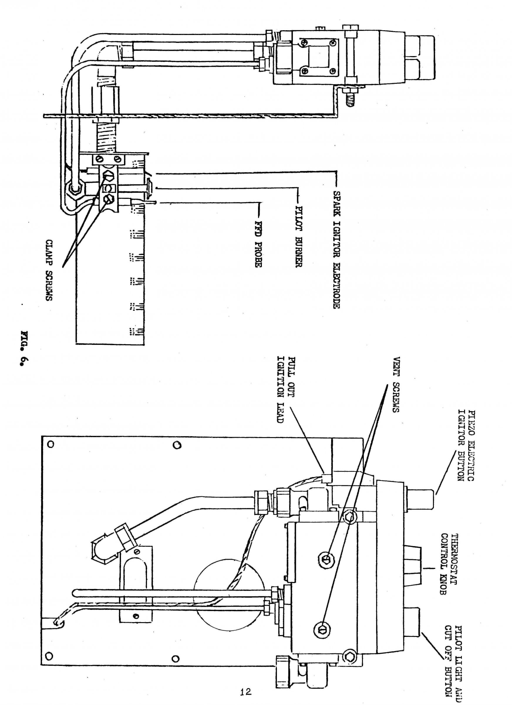

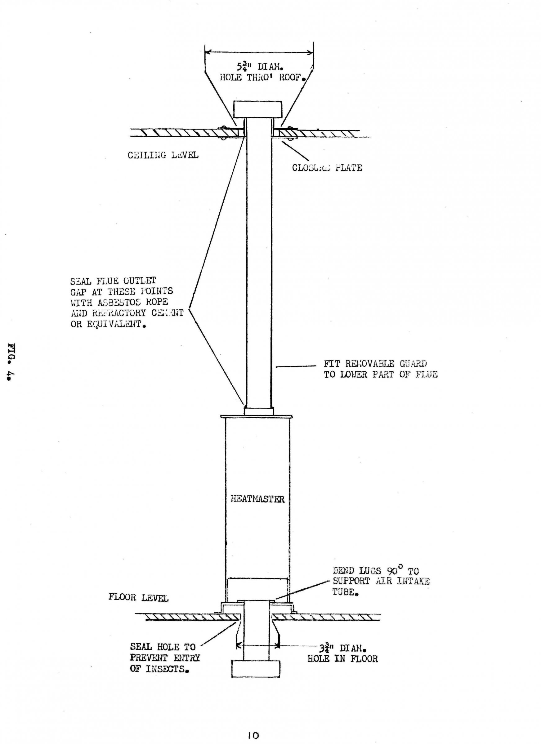

As there seem to be several requests for the Ellis Heatmaster Instalation and Maintenance instructions, I am going to try and attach a copy. If it works perhaps the Moderators could add it ito the pinned files.
Well that failed, I will try again.
Edited by David Schweizer
  • Author
#30
 Well it worked that time. However, they are displaying in reverse order.  The pages are numbered , so perhaps the mods could re-organize them into the correct order. It should also be possible to download them by right clickng on each page and saving them individualy.

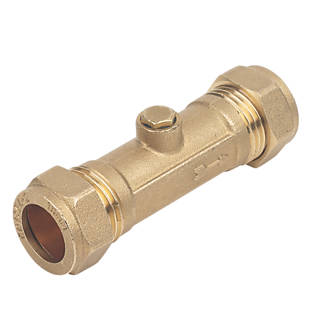

6 hours ago, WotEver said:
I’m surprised that a convection system would have sufficient force to overcome the pressure of a non return valve. I’m not doubting you, just surprised. Can you recall what valve it was because that might be of use to some members.
The boat did have a significant rise from stern to stem, which may have helped, and after a sunner of not being used, sometimes needed a bit of assistance frpm the engine pump to get the water moving, and sometimes bleeding, but usually only after the first autumn boiler firing.
The valve was a standard 15mm double check valve, available from Screwfix or any plumbers merchant. it was fitted into the flow pipe from the water pump to the radiators with the arrow facig towards the radiators.
#39
