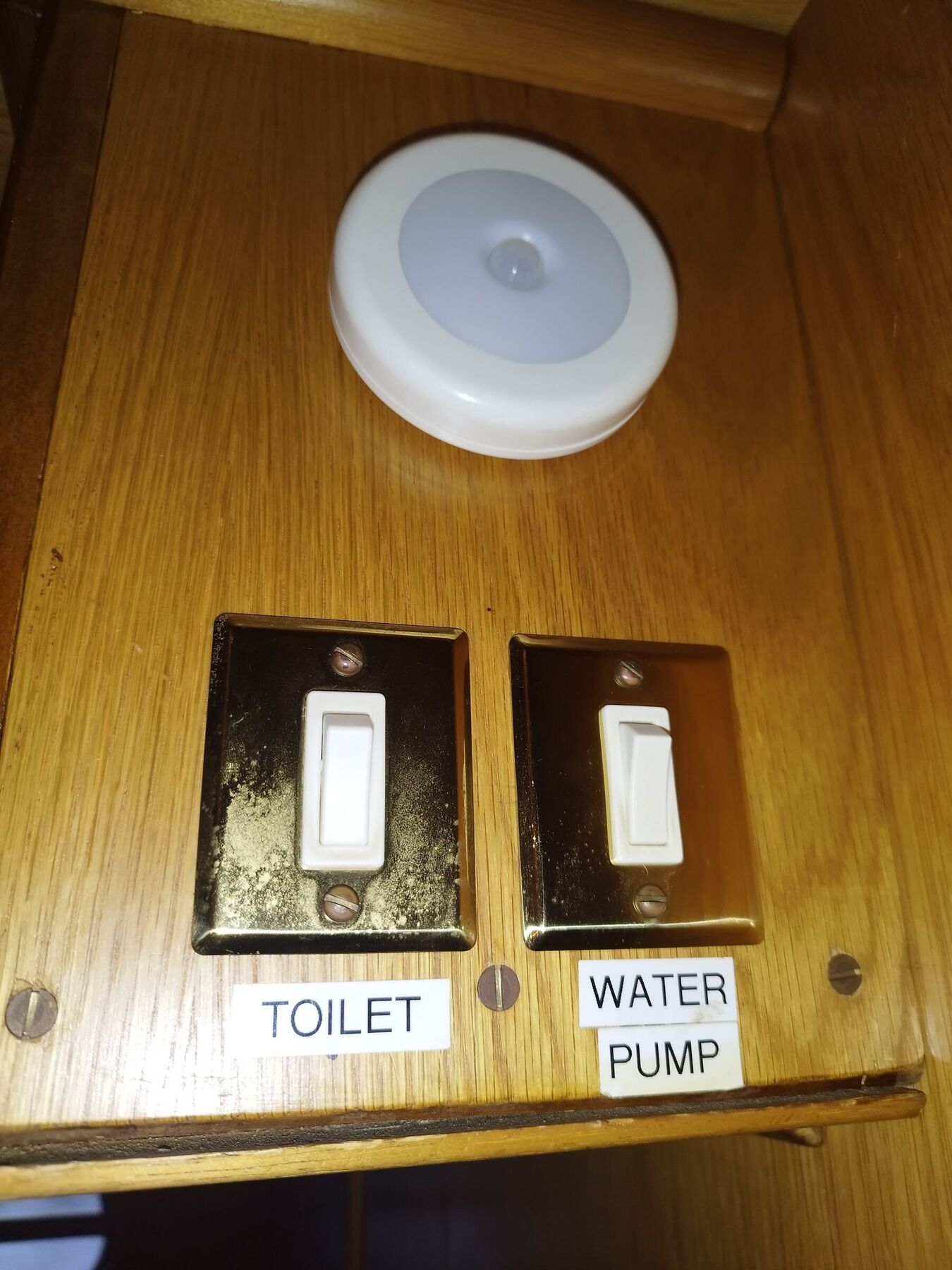

FWIW I fitted a pair of suitable domestic light switches, one in the galley and one in the toilet, so it was possible to turn the pump on and off when needed - like at night. Technically this is not best practice, but I also fitted a relay by the pump so the switches did not have to handle the full pump current. In practice the accumulator and siting the pump under the dinette meant the odd time it ran a night did not disturb unless guest were sleeping over the pump, so it did not need turning off at night, but the facility was there.

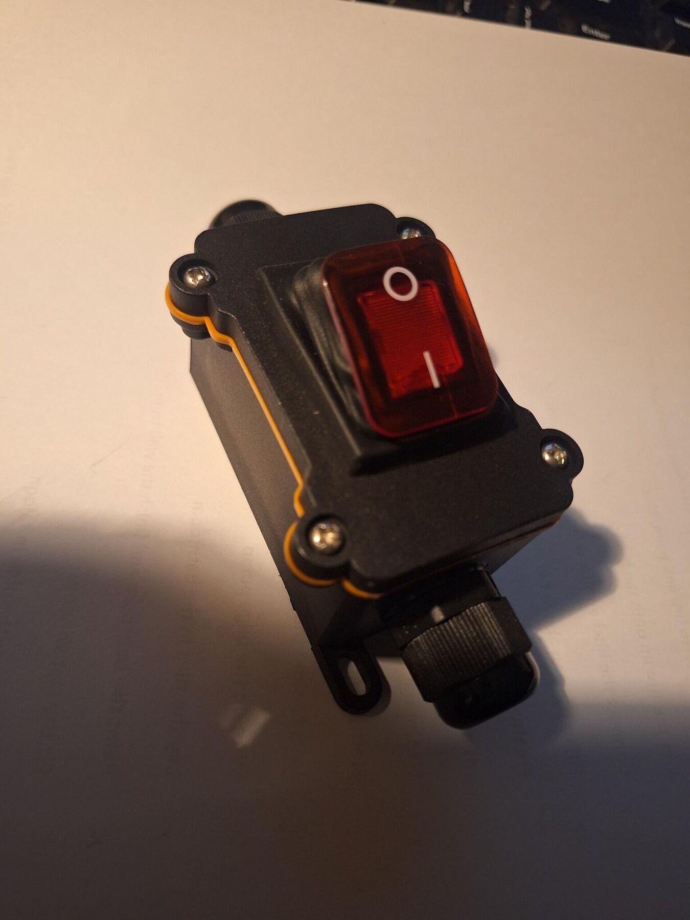

This is what I am going to use, no particular reason but they are DC and waterproof
#16
We’ve got one of those on a lead for a water pump we use to drain the system. It’s probably a bit of an overkill but nothing wrong with that.

Think I got it off Amazon, I just typed in DC switch for 12volts
Kopinma IP67 Waterproof Inline Switch 12V DC 20A High Current Power Waterproof Switch As shown : Amazon.co.uk: DIY & Tools

I just use these basic DC switches. I'm not sure why you'd need waterproof switches. They seem a bit over-specified.
