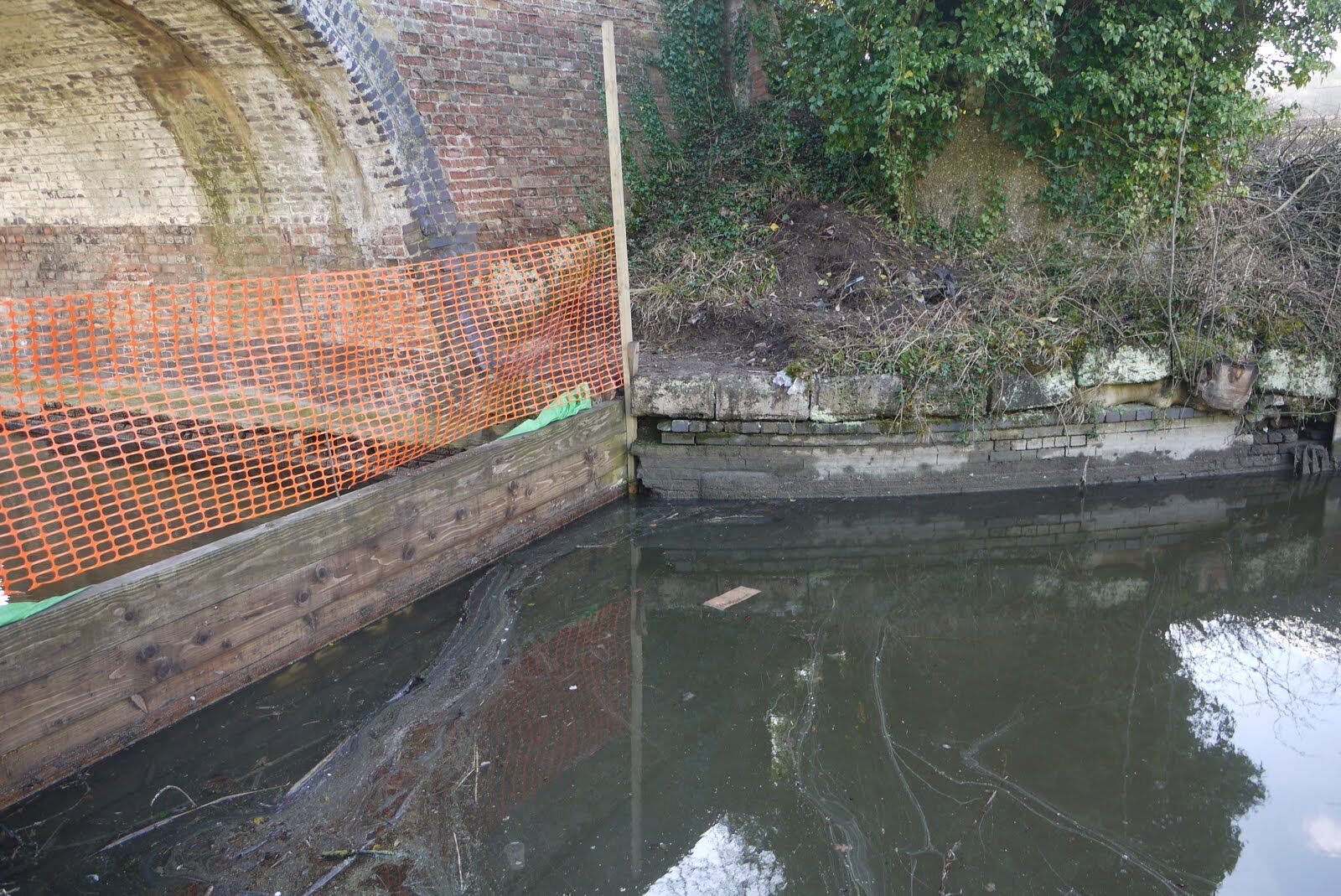

See the recent installation of stop planks by Keir at the start of the Whitchurch Arm. For some reason, despite there being the usual stock of planks at the junction, they went and bought their own which then had to be cut to length and shaped.
Yes, they float but that helps when removing them, especially if there are onlookers desperate for the navigation to resume! Or no handles have been fitted to hook them out . . .
