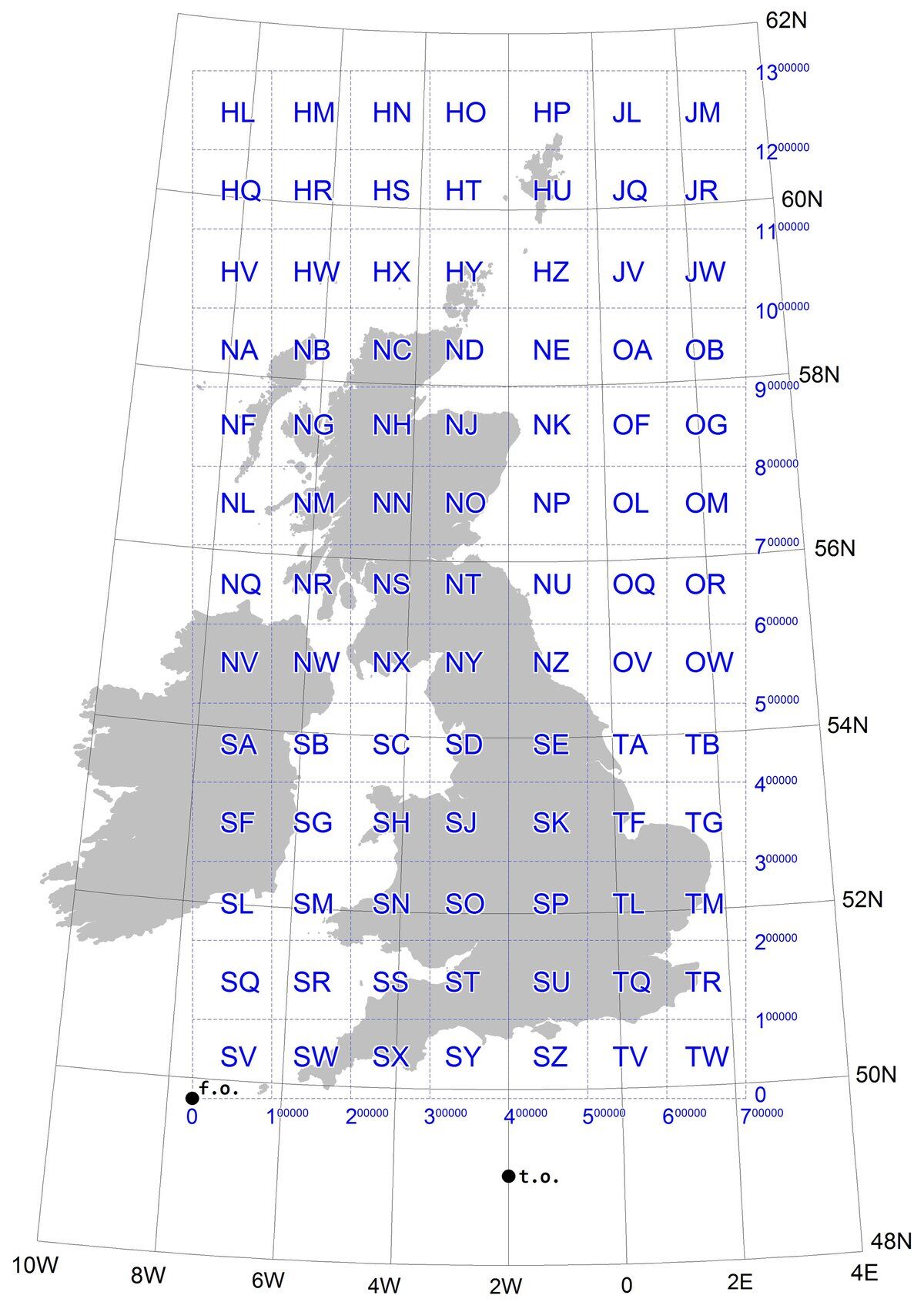

Google says
E 507 985 N 201 235
The coordinates E 507985, N 201235 represent a specific location point using the Ordnance Survey National Grid (OSGB36) system for Great Britain.
Converted into the standard alphanumeric format, this point corresponds to the 10-figure grid reference TL 07985 01235. This location is situated in Hertfordshire, England, just north of Watford.
Coordinates Summary
  • Grid Square: TL
  • Easting: 507985
  • Northing: 201235
  • Full Alphanumeric Reference: TL 07985 01235
It does indeed relate to the lock just south of the M25
4 minutes ago, Mac of Cygnet said:
No it isn't. The OS Grid reference for North Grove Lock is TL 07982 01233
It could well be the location of the sign rather than the actual lock 🫣

So where is it based from

#8
In the dim distant past I could have answered that but I can't now😱
I used to use that system in my radio ham days I lived in SP54 however that was over 30 years ago and memory fades.
Ask Google that's how I got the answer.
https://en.wikipedia.org/wiki/Ordnance_Survey_National_Grid

#15
6 minutes ago, Mac of Cygnet said:
Off the SW coast, west of the Scillies, IIRC
Yup. A spot south and west of the whole British mainland, so that all the eastings and nothings are positive.
Not quite. Grid references apply not just to the mainland, but to all the offshore islands as well, including the Outer Hebrides some of which are west of the Scillies (but not of the SV square in which the Scillies are situated). Eastings and Northings in normal use take their origin from the SW corner of the two letter 100km square in which they are situated.
#20
OK. Mainland was the wrong word. I meant Great Britain, since Northen Ireland uses a different grid, shared with the Republic (although it looks as if most if not all of NI lies within the area covered by OS NG).
