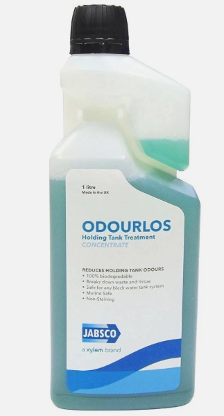

I always pump out before laying up the boat for winter.
But after pumping out I always flush some clean water and chemical back in so there is a facility for digestion of some almost inevitable remaining waste
I used to use some blue stuff until I discovered how highly carcinogenic it was. I believe the formula for that has since changed. However instead of the blue stuff I use Odourlos which is an enzyme based product that helps to digest the effluent and I find that more effective and more economical compared to the blue stuff. One measured dose after each pump out is sufficient.
