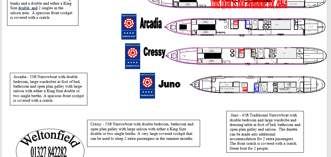

we bought an ex hire boat which had been converted, the previous owner had had the work done at a boat yard and the invoices were in the 'pack'
To remove the pump out tank, reinstate the floor, rebuild the bed as a cross bed with cupboard below, install a cassette toilet, build a wardrobe for folding bikes in the space made by rotating the bed.
Cost £11,000 - this was about 15 years ago
This was Juno in her 'hire boat life'
 Thanks, interesting! More like £20k in today's money then.., although I assume most of the will have been labour!
