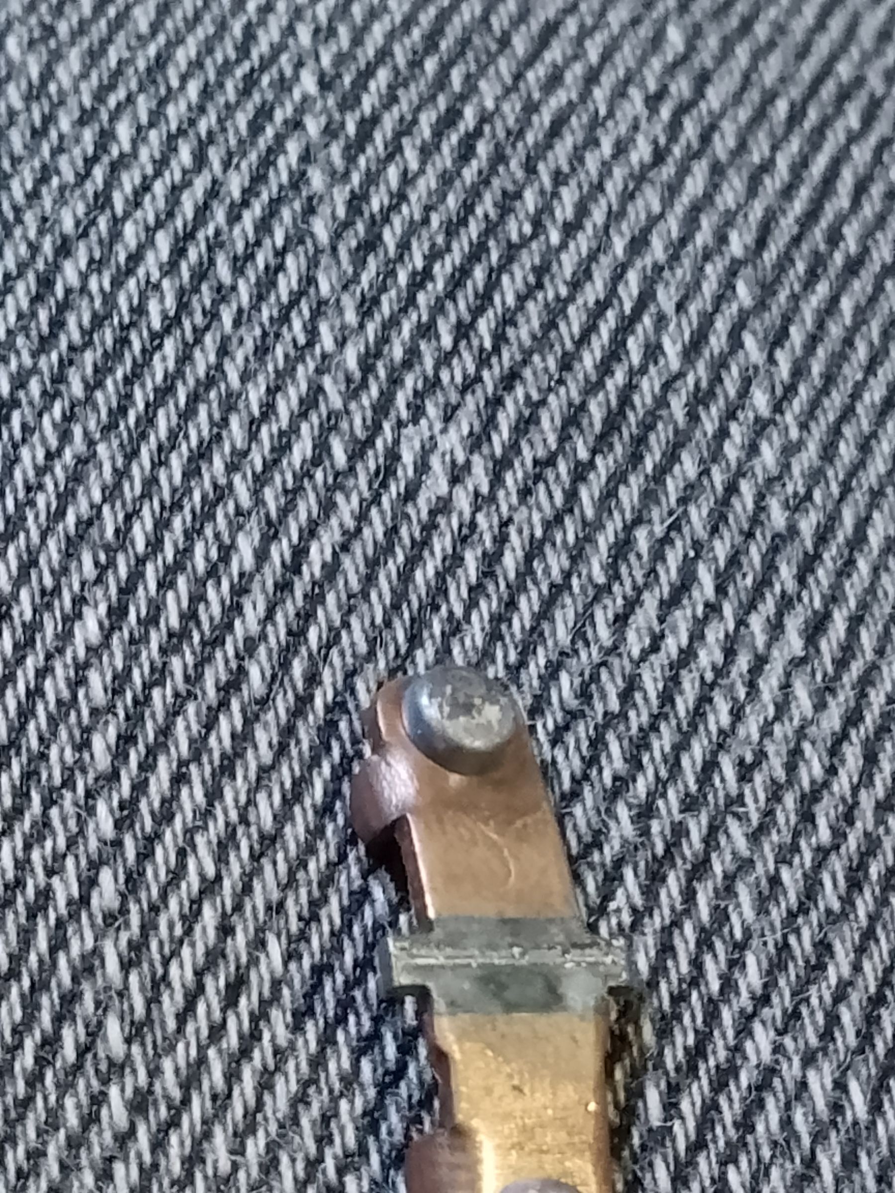

For my own satisfaction, I dismurgalified the switch and there is obvious erosion and pitting on the contacts visible at 10x mag. Unfortunately, my phone won't do macro photography, so this is about as good a pic as I can get.

Electrical engineering types do the suck through the teeth thing at the very idea, but yes, for running LEDs, it is fine.
