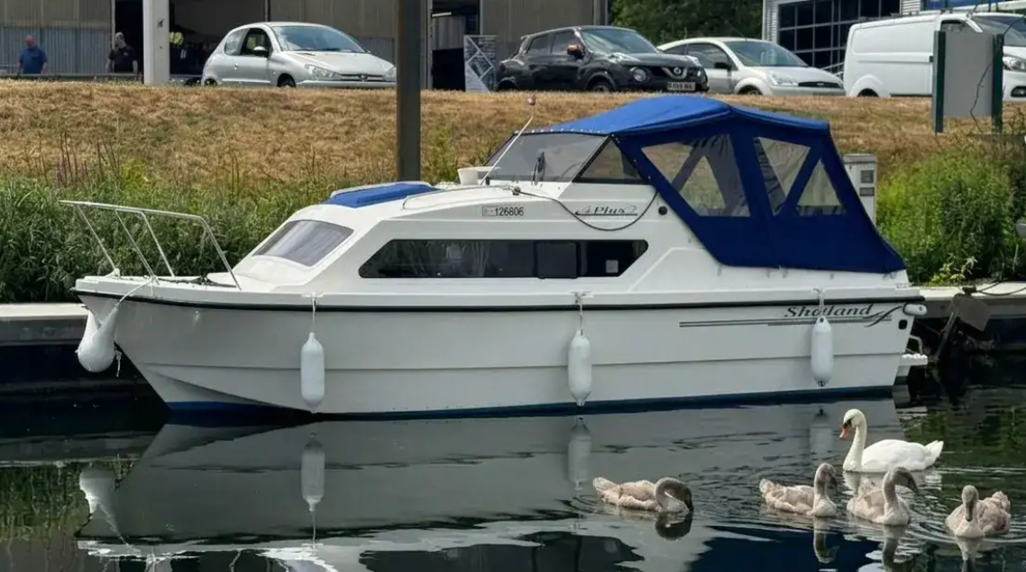

This one has 20hp   . I am sure there are other examples with much greater power . A limiting factor may be the maximum power that the boat is rated to accept.
