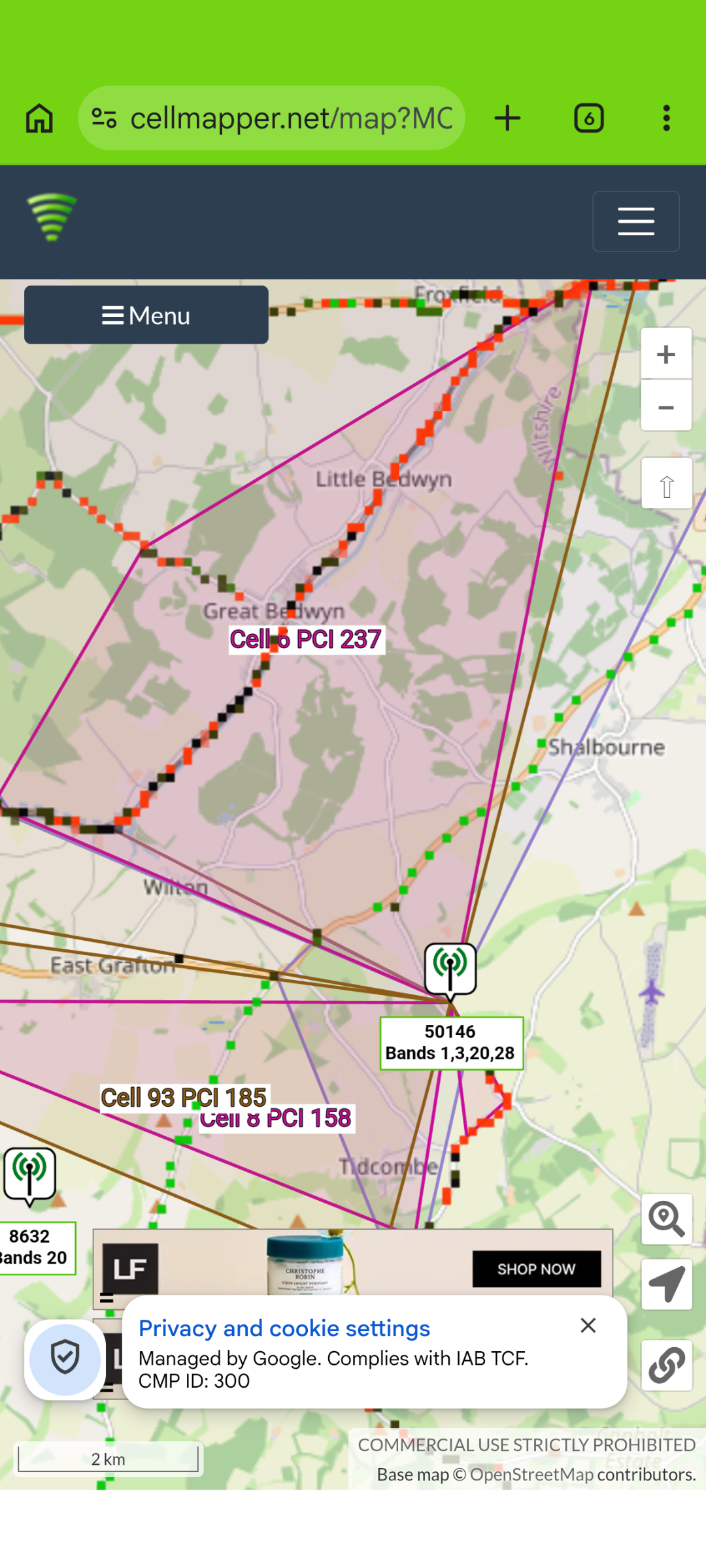

GUMPY Posted August 25 Report Posted August 25 33 minutes ago, MtB said: What would you suggest for me in a flaky location with no 5g and flaky, unreliable 4g and even my fibre landline drops out regularly? Having just looked at the coverage in your area Assuming Google maps has placed you correctly then both EE and 3 have masts near the top of Botley Hill just up your road
Tony Brooks Posted August 25 Report Posted August 25 I thought Mike lived in Great Bedwin and there is no 5G coverage and 4G seems to be dead flaky for all carriers, but 3 looks the worst.
GUMPY Posted August 25 Report Posted August 25 Vodafone, EE, Three and O2 all share the same site near Botley Hill. All be it 2.7miles from Bedwyn but all show 4g coverage on various frequencies. What real life is like I can't say

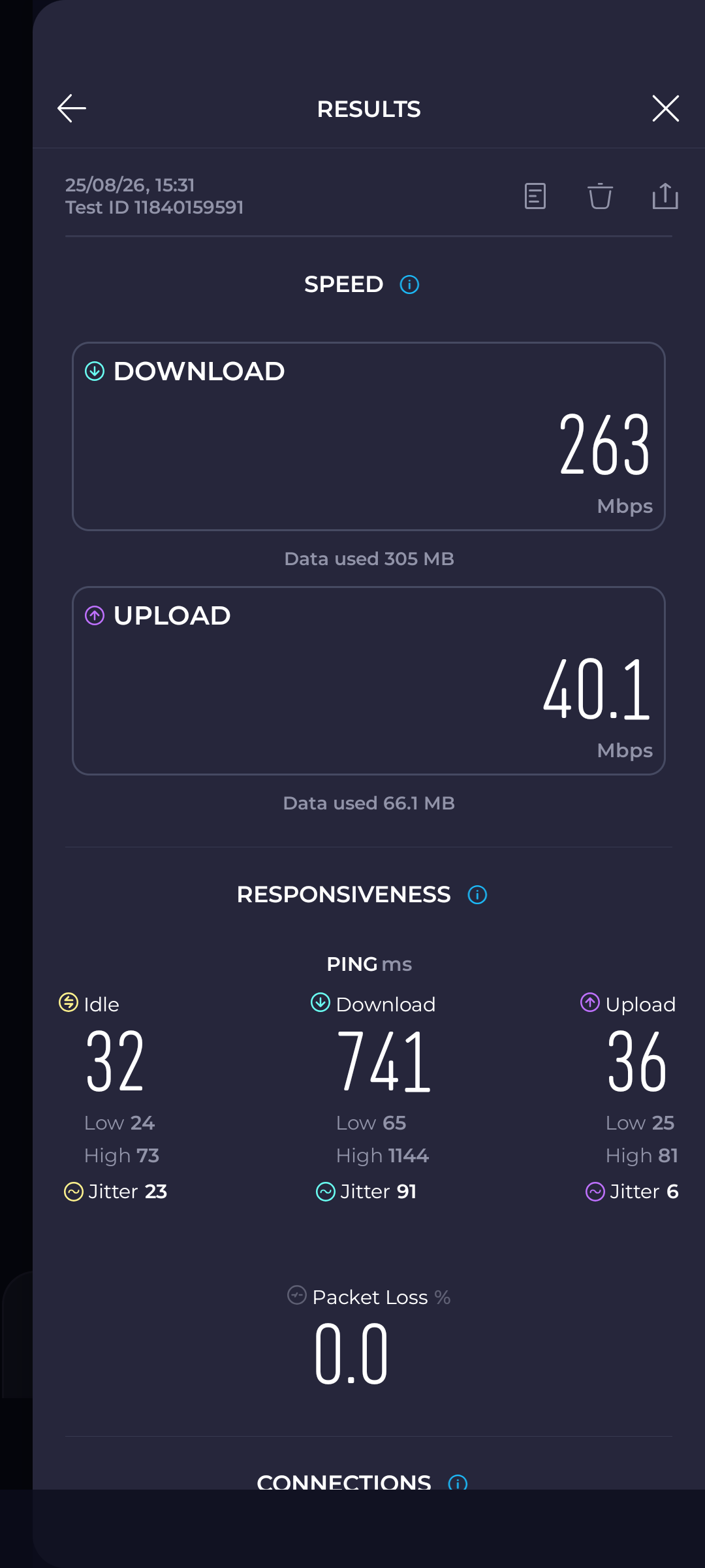

Rob-M Posted August 25 Report Posted August 25 My current Smarty connection moored in Birmingham using a router on internal aerial only 1

Sub Divo Posted August 25 Report Posted August 25 5 minutes ago, Rob-M said: My current Smarty connection moored in Birmingham using a router on internal aerial only Nice! I was pleasantly surprised to see a good 4G signal (on my phone) inside the boat the first time I ever checked. Quite unexpected. The router I've chosen supports 4x4, so I'm hopeful that strategic placement near a window might mean the standard stick aerials will suffice. It's worth a try anyway.
