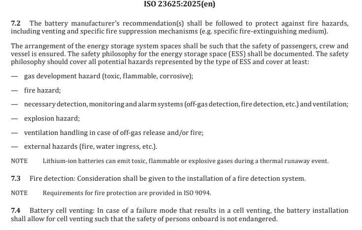

The main issue I would take with the document is the decision to regard Li batteries installed in living space as unacceptable. This is solely based on the one incident and thus statistically insignificant.
Actual risk from Li batteries is much more about charging small devices with LiPo etc batteries, especially those bought from ebay, Amazon etc. Yes there is less volume of gas to be produced, but still an intense fire that is well able to ignite a boat.
And yes as has been mentioned, stoves setting fire to boats is much more probable cause of a total loss insurance claim and has the potential to set adjacent boats on fire, and yet double skinned flues are not mandatory.
In summary, the rejection of domestic LiFePO4 batteries in living space is ill thought through and erroneous. And no  this is not a personal attack nor “Ad Hominem”. It is simply my opinion of the work done.
If you come back all defensive or “attack is the best form of defence” instead of listening, then you will be due a personal Ad Hominem attack for being unable to receive polite and constructive criticism.
Edited by nicknorman
No. it's based on ISO23625, and other documents/training material which all say the same thing. The gassing risk has always been there (and in the standards), but before the ABC fire it was almost completely ignored.
Your second point is opinion not fact -- and I partly agree with it. Unfortunately unless you're going to somehow persuade ISO that they're wrong, and the insurers and BSS who base what they do on ISO (like ABYC told us they did, and insurers in the US say they do) are also wrong, and BM who write the RCR rules are wrong, it's pretty much certain that this rule (LFP batteries must vent outside the boat and not inside where people can breathe in the gases) will be adopted in the UK by both regulators and insurers.
I don't like this either, but I'm afraid there's nothing you or the JWG or anyone else can do about it... 😞
Which version of the ISO23625 are you referring to? The first edition published 2025-03, or is there a later version? The version I mention does not require battery ventilation, in fact it specifically mentions that it is not necessary.
Given that venting *has* to be allowed for, that the emitted gases from cell venting are both toxic, flammable and corrosive, and 7.4 says that these *must* not endanger persons onboard, and that breathing these gases is dangerous, the only logical conclusion -- though not stated explicitly -- is that the gases must be vented overboard, and not enter the living space where people are.
Unless you can come up with another solution that meets these requirements?
Edited by IanD

9 minutes ago, IanD said:
This is confusing because on the ISO website it seems that the 2025 edition is the current one. And I also found a pdf of the 2025-03 version which is different from the one you have just posted an extract from. I know that the ISO from 2021 has been superseded but I don't understand why you are seeing a different version to me if they are both 2025. Has the version you posted from actually been officially published?
Edit: my version ends at 7.1 so perhaps it is not a complete version. But it does have:
4.1 Lithium-ion batteries and their systems shall be installed in accordance with the requirements of
ISO 13297.
NOTE Lithium-ion batteries are not subject to routine electrolyte leakage or routine release of gas, therefore
requirements regarding electrolyte containment and routine gas ventilation cannot apply to lithium-ion battery
installations.
Yes, it was officially purchased by the IWA, cost something over £300 IIRC.
