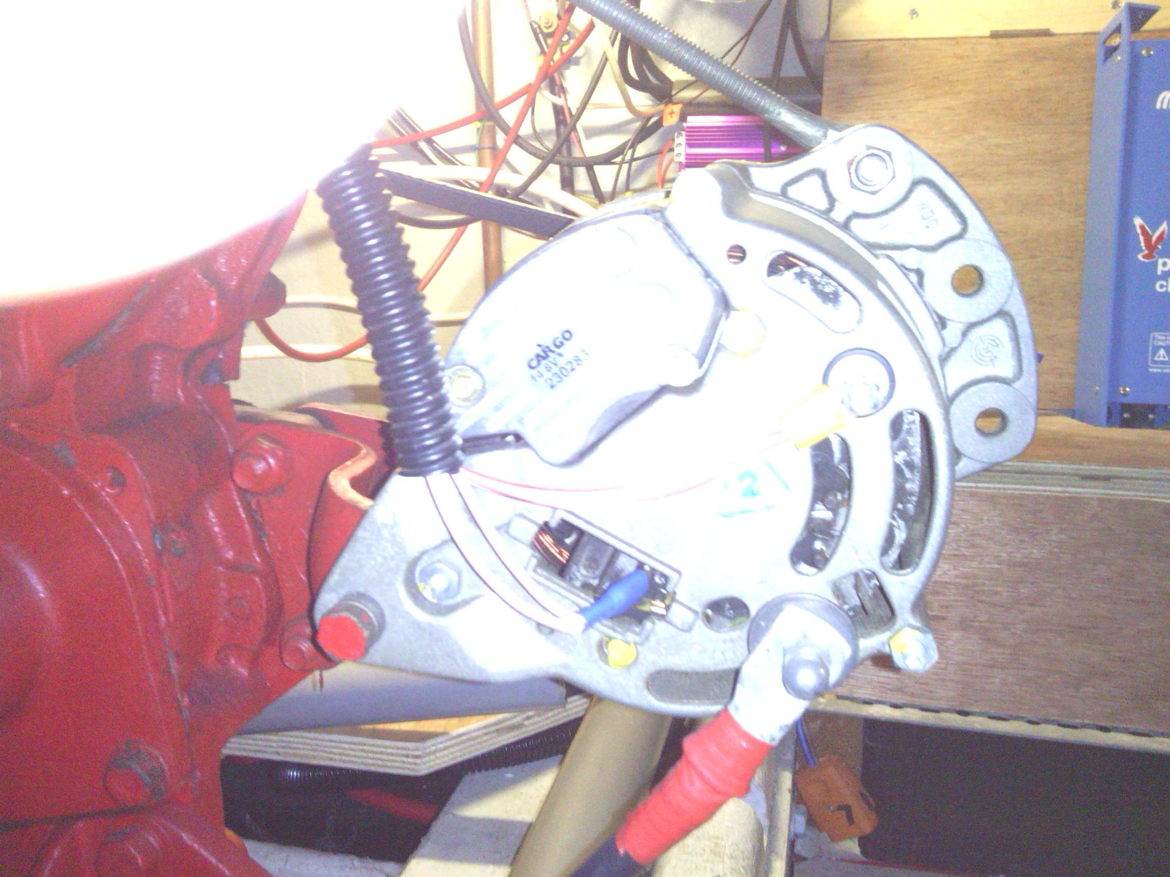

Surely, there is no "potentially", it is a fact that when Lead Acid batteries are approaching fully charged, the charge source will be giving around 14.6v - and occasionally (say once a week / once a month) when doing an equalisation charge could be as high as 15.5v
An alternator will only provide what the battery can accept.
If you zoom in, you'll see my Cargo alternator's regulator is 14.8v
