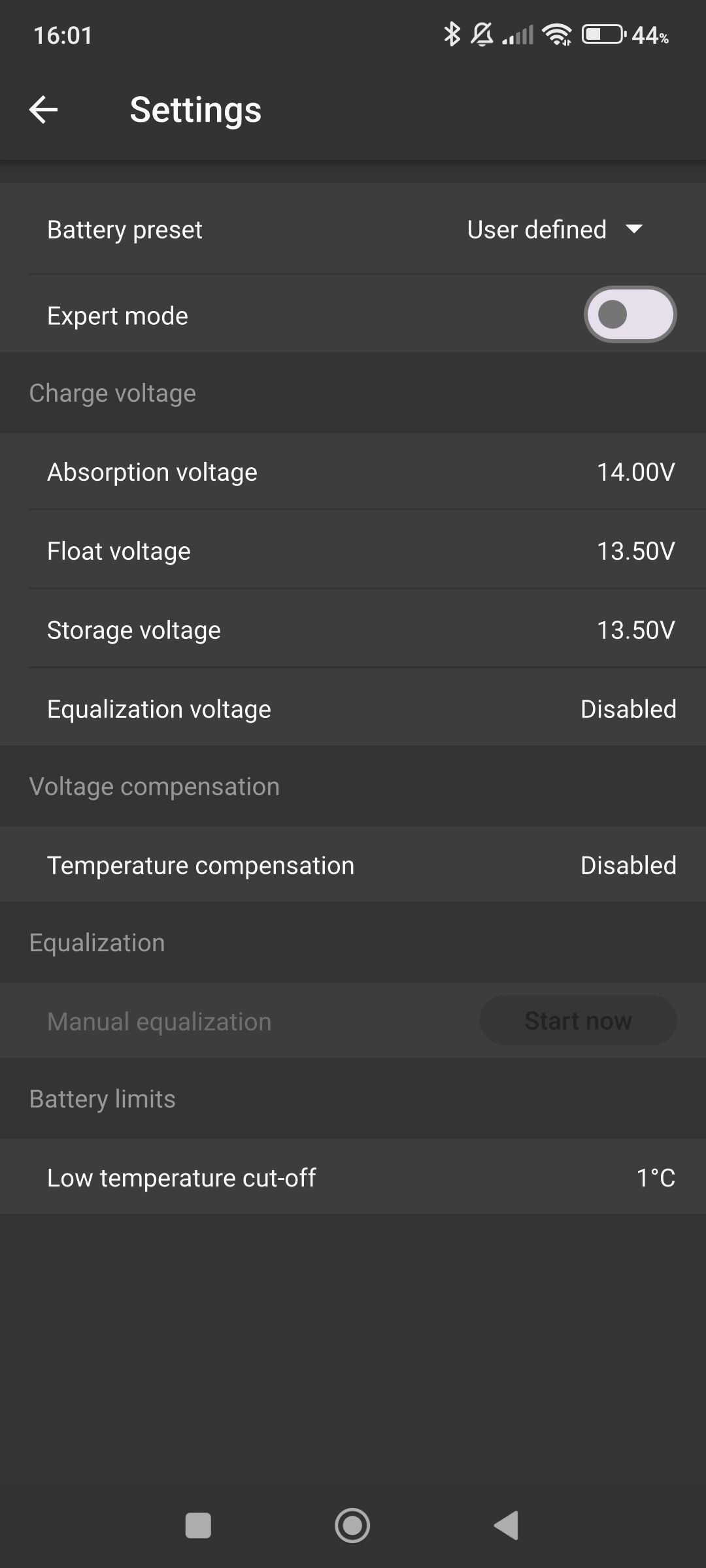

I've got the input current set at 35A but looking at the output battery voltage settings the other day while going along the river I decided to reduce absorption voltage from 14.2v to 14v to avoid overcharging the lithiums. Should I reduce it further down to 13.8v?

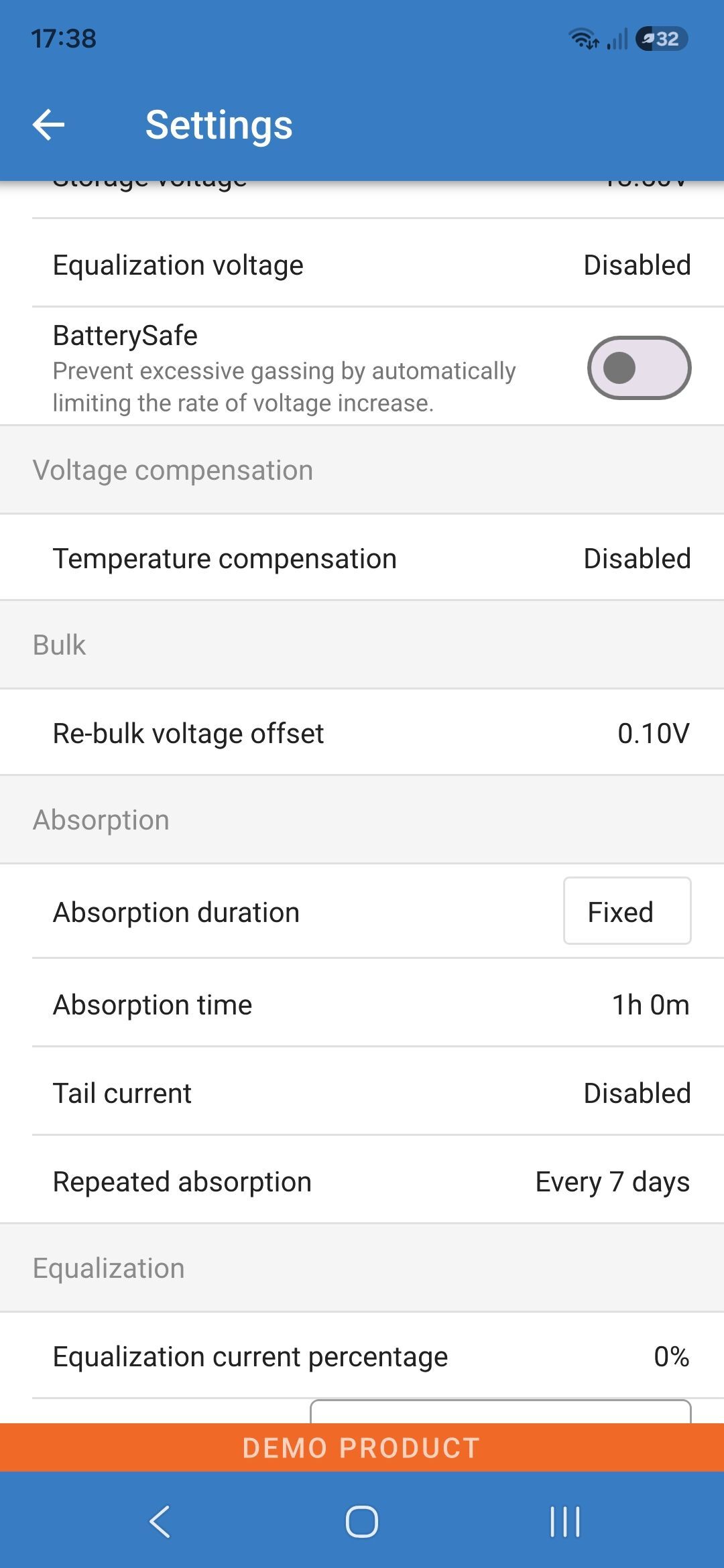

The Orion XS will go to float, so you could set that quite low, say 13.3V, but the default duration is 2 hours. You can enable expert mode and reduce this but the minimum is 1 hour, bizarrely there is no 0 figure for hours. You could try adaptive absorption which varies absorption time based on battery voltage at start up of the Orion, but minimum is 30 minutes.

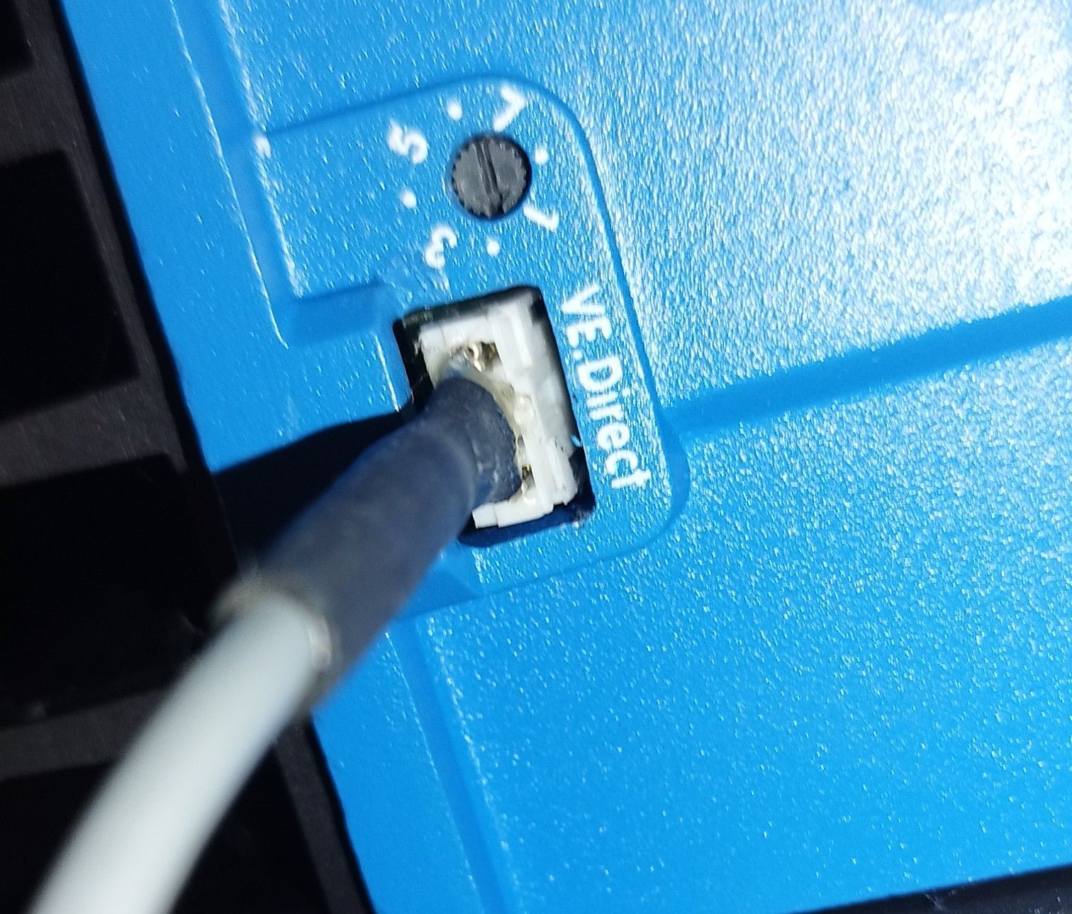

I don't think it's either of those? The cable from the BMV goes into the VE Direct port on the MPPT.

You are using one of the MPPTs without the remote H/L connections. I am not familiar with the on/off cabling via the VE Direct port on this type, just via the H/L remote connections. I do not know how to wire a system if it is trying to use both types simultaneously. It might be in some of the Victron schematics or ask on the Victron community.
