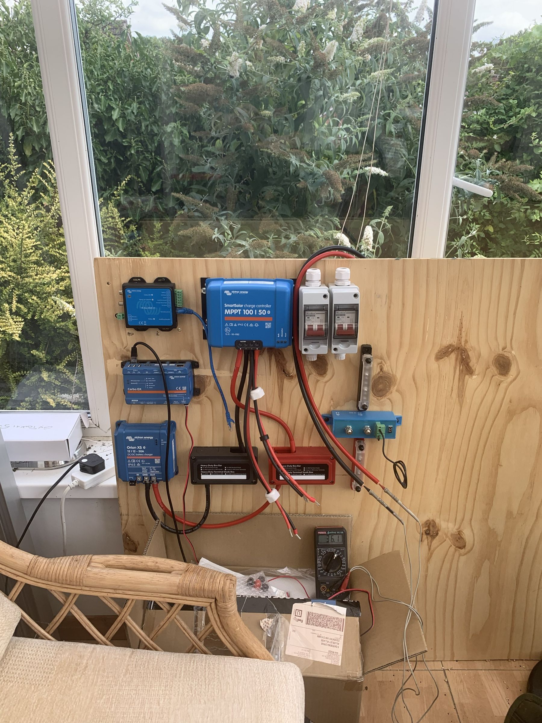

PeterF Posted July 31 Report Posted July 31 The inverter will not limit the power, it will heat up till it shuts down. If it limited the power with a fixed resistance like an oven it would have to let the voltage drop below 230V, which would not go down well with any voltage sensitive equipment. Make sure it is in a well ventilated location. An oven will be on full power as the oven warms up, but once up to temperature it will cycle on and off but at full power. I see the VE BUS BMS mk2, do not forget that this needs a VE Bus inverter such as a Multiplus rather than one of the VE Direct inverters. Two cautions with using the Victron Lithium Smart batteries, you may have this in hand, if so apologies. 1, the VE Bus BMS nor the batteries have inbuilt SOC calculation, you need a SmartShunt. 2, tje batteries do not have any form of internal BMS, the cells are direct to the battery terminals, consider what level of fusing you need in terms of the AIC, (Ampere Interrupting capacity), the maximum short circuit fault current that they can break (this is not the rated current), Mega fuses are not suitable. I ended up using Class T on my 300Ah Victron NG batteries bit Blue Sea MRBF may also be OK, but check.

PeterF Posted August 1 Report Posted August 1 He has a BMS for Victron lithiums on the board shown above.

PeterF Posted Wednesday at 17:17 Report Posted Wednesday at 17:17 7 hours ago, Riggsy said: Thanks, I currently have a 300W Fogstar Li unit, soon to be followed by a 2nd one. They do have internal BMS, but I'm not relying on that. Charging is via 2 x 460W solar panels in the summer, and the engine for the dull days. Thats all in and working. Of you are using Fogstar batteries why do you have a Victron VE Bus BMS, the two are not compatible, the Victron BMSs only work with Victron batteries.
