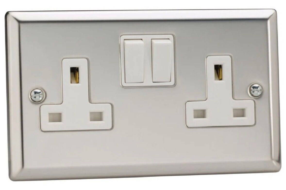

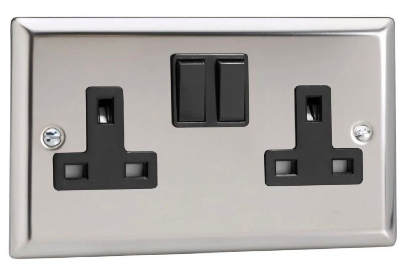

Eeyore Posted July 29 Report Posted July 29 A little thread drift. Some years back one of the show boats at Crick had these fitted throughout; guess which one was 12 volt. BSS guy claimed there was nothing they could do!
jonathanA Posted July 29 Report Posted July 29 14 minutes ago, Eeyore said: A little thread drift. Some years back one of the show boats at Crick had these fitted throughout; guess which one was 12 volt. BSS guy claimed there was nothing they could do! I guess if the 12v was wired across N and E it would be pretty safe..... You can get a version with the earth pin turned thru 90 degrees, aimed at medical equipment / lifesaving equipment etc. But of course they aren't made in China and sold for a couple of quid.....
