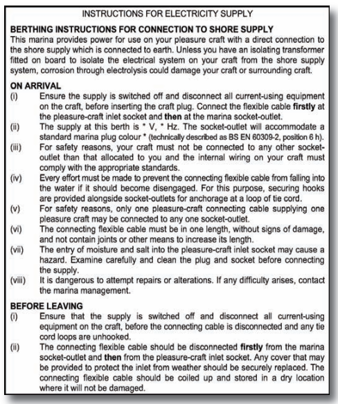

Momac Posted July 28 Report Posted July 28 17 minutes ago, jonathanA said: Strictly speaking BS 7671 requires an instruction notice. It says It is recommended in Section 709 that the marina operator provides an instruction notice for people intending to connect pleasure craft to the shore electrical supply, prior to them making such a connection. To achieve this, BS 7671 recommends that a notice is placed adjacent to each socket-outlet or group of socket-outlets. The recommended content of the notice is given in Fig. 709.3. I couldn't copy the actual notice but essentially it says connect to.the boat then the bollard and disconnect at the bollard then boat when disconnecting.
jonathanA Posted July 28 Report Posted July 28 Thanks, Can't say I've ever seen one in any marina I've been in.....
Momac Posted July 28 Report Posted July 28 1 hour ago, StephenA said: If you unplug from a CRT Metermacs outlet it turns the outlet off and sends you an email telling you that you've disconnected Yes but not all shore power bollards are like that . 19 minutes ago, jonathanA said: Thanks, Can't say I've ever seen one in any marina I've been in..... Nor me 1 hour ago, Jen-in-Wellies said: Be prepared for someone, somewhere, to prove you wrong! And they will probably say it is perfectly safe since no one has been killed .

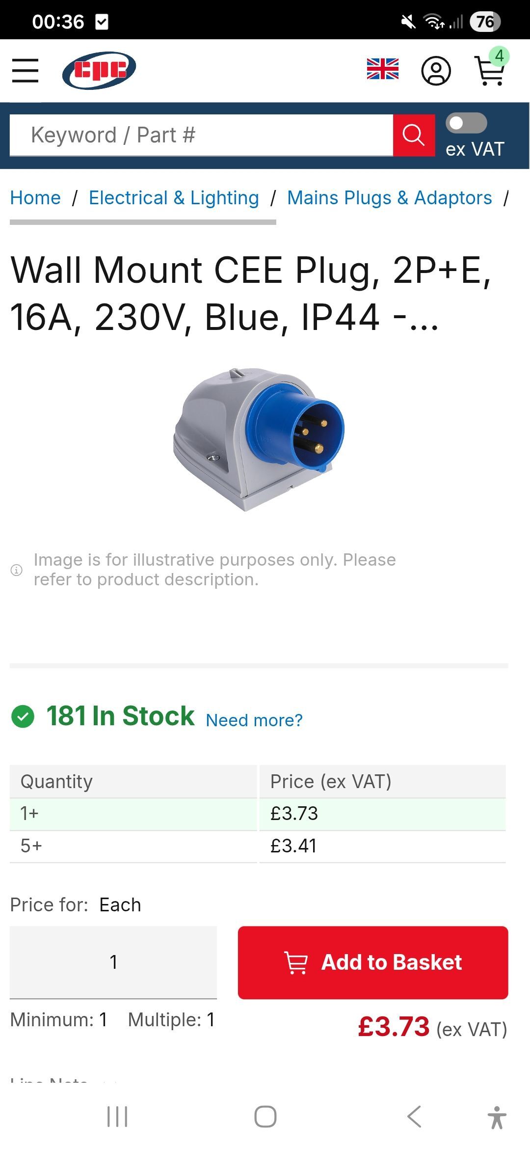

Ronaldo47 Posted July 28 Report Posted July 28 (edited) The correct types of wall-mounted plugs are not too difficult to find and are not exactly expensive: this is a screenshot from the CPC/Farnell web site showing one of several examples. None of them have hinged covers like the wall-mounted sockets. Edited July 28 by Ronaldo47

StephenA Posted July 29 Report Posted July 29 (edited) 7 hours ago, Ronaldo47 said: The correct types of wall-mounted plugs are not too difficult to find and are not exactly expensive: this is a screenshot from the CPC/Farnell web site showing one of several examples. None of them have hinged covers like the wall-mounted sockets. Ours does.. as does this one https://www.essentialsupplies.co.uk/pce-16a-appliance-inlet-wall-mount-with-sprung-lid-240v-ip44-3-pole-513-6d.html?srsltid=AfmBOorNdjgDIWNbXqbkR2_ngqzC7Tk7CodaMvrXqIHnWzAnhLORfYLr Edited July 29 by StephenA
cheesegas Posted July 29 Report Posted July 29 7 hours ago, Ronaldo47 said: None of them have hinged covers like the wall-mounted sockets. Fairly common for them to have hinged covers. 1

MtB Posted July 29 Report Posted July 29 8 hours ago, Ronaldo47 said: The correct types of wall-mounted plugs are not too difficult to find and are not exactly expensive: this is a screenshot from the CPC/Farnell web site showing one of several examples. None of them have hinged covers like the wall-mounted sockets. If someone installs the male-pinned input socket in your photo above, do those male pins not become live to touch when the inverter in the boat is turned ON?
StephenA Posted July 29 Report Posted July 29 (edited) 5 minutes ago, MtB said: If someone installs the male-pinned input socket in your photo above, do those male pins not become live to touch when the inverter in the boat is turned ON? You have switching inside the boat to ensure only one 240v source can be connected at once. We do it on Mintball by having sockets outlets for the two sources and plug the internal 240v circuit into the appropriate output Edited July 29 by StephenA
cheesegas Posted July 29 Report Posted July 29 7 minutes ago, MtB said: If someone installs the male-pinned input socket in your photo above, do those male pins not become live to touch when the inverter in the boat is turned ON? …no. Three ways I see it done usually, in order of price! None of them somehow wire an inlet to a supply. 1 - shore power inlet feeds a standard 13a socket just inside the boat. Inverter also feeds a separate 13a socket next to it. Boats mains system is connected to a male 13a plug which hangs down next to it. You plug it in to whichever power source you’re using. 2 - three position break before make changeover switch is used to change between inverter power and shore power. 3 - shore power inlet feeds the AC input of an inverter/charger with built in automatic changeover switch.
